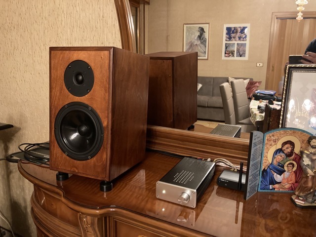

Hello everyone, I recently built some bookshelf speakers which I simply called "Classic 25" due to the shape, design and use of a pair of widely used Seas 8" + 1" drivers, the CA22RNY woofer and the 27TFFC tweeter . Among the various audio constructions that I have made over the years for my personal enjoyment, I decided to show them to you because, in my opinion, they sound very good, they are easy to build, practical to use and have a cost which, although not low in absolute, it's pretty low compared to what they offer.
Let's start immediately from the end, the sound. As you can see, the filming takes place in a very ordinary dining room, without acoustic treatment and with some critical surfaces (mirrors, glass cabinets, tiles), measuring 25m2. The Classics are placed on a sideboard (bookcase, desktop, TV stand, etc.) a few centimeters from the back wall and two meters from each other.

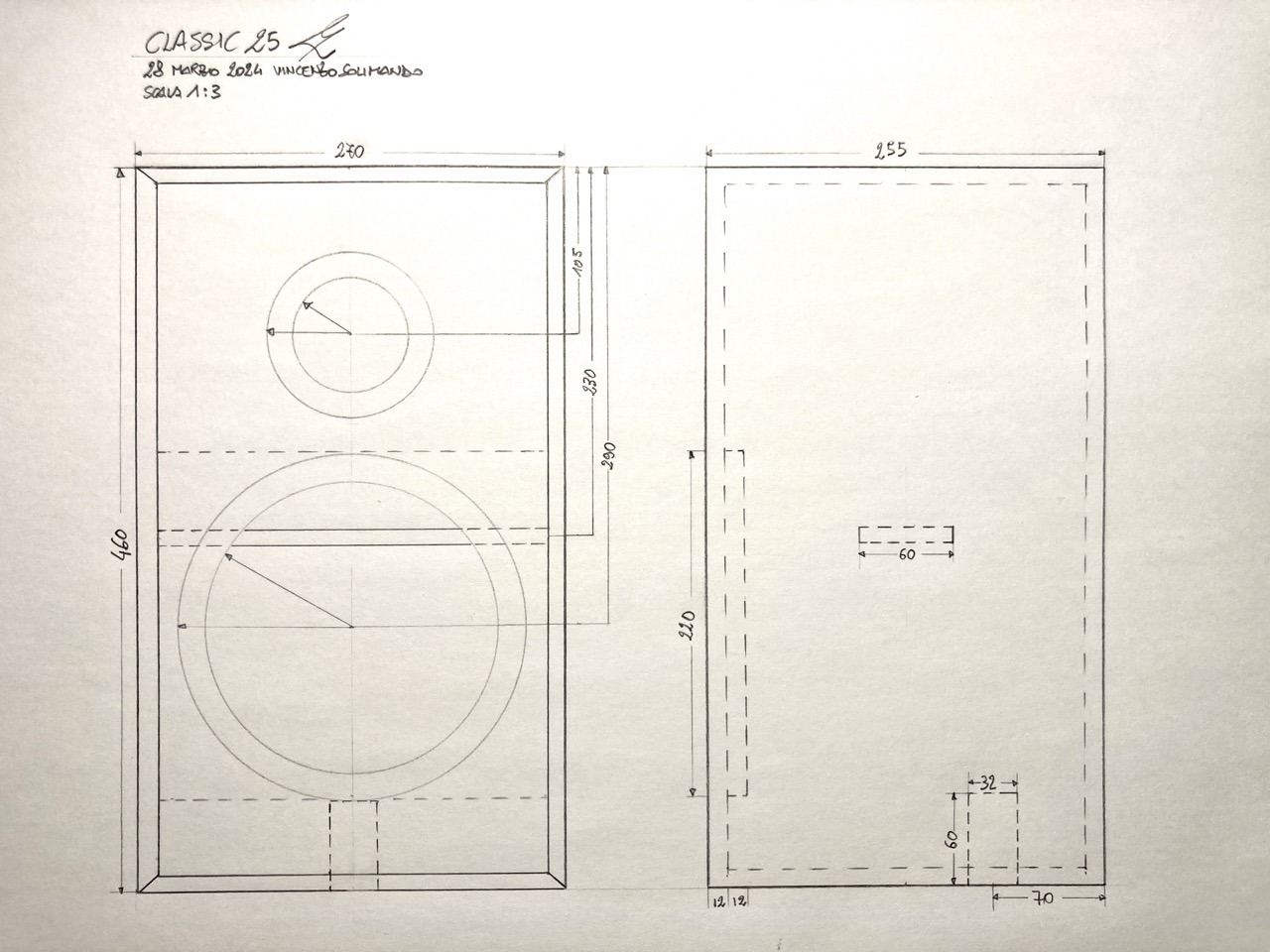

For acoustics, no reflex port, tweeter spaced away from the woofer, do you want to tell us about the design and crossover choices. Is the volume 25Litres ?
Sì, presto pubblicherò il circuito e i disegni del mobile con tutti i dettagli. Saranno semplici schizzi fatti a mano, ma sufficienti per chiunque voglia farne una copia o sperimentare.

@raymondj sono circa 25 litri e la porta reflex è sul fondo.

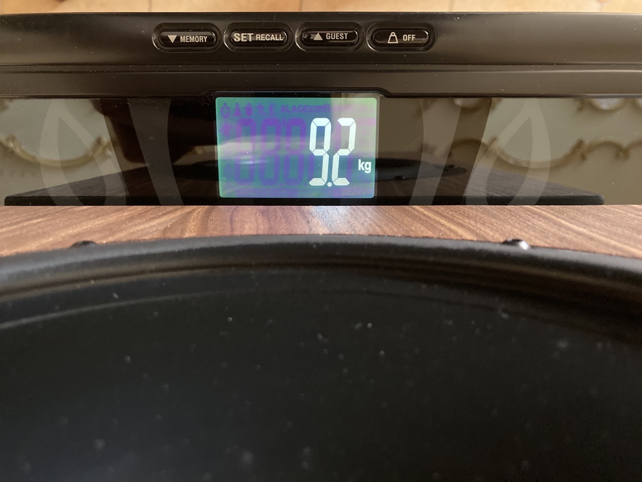

The one I present here is therefore born with a thin and moderately resonant cabinet to be light (!) and transportable (about 9.0 kg). The fact that it sounded very good right out of the box led me to spend a lot of time calibrating the crossover, arranging the internal resonances and fine-tuning the reflex.

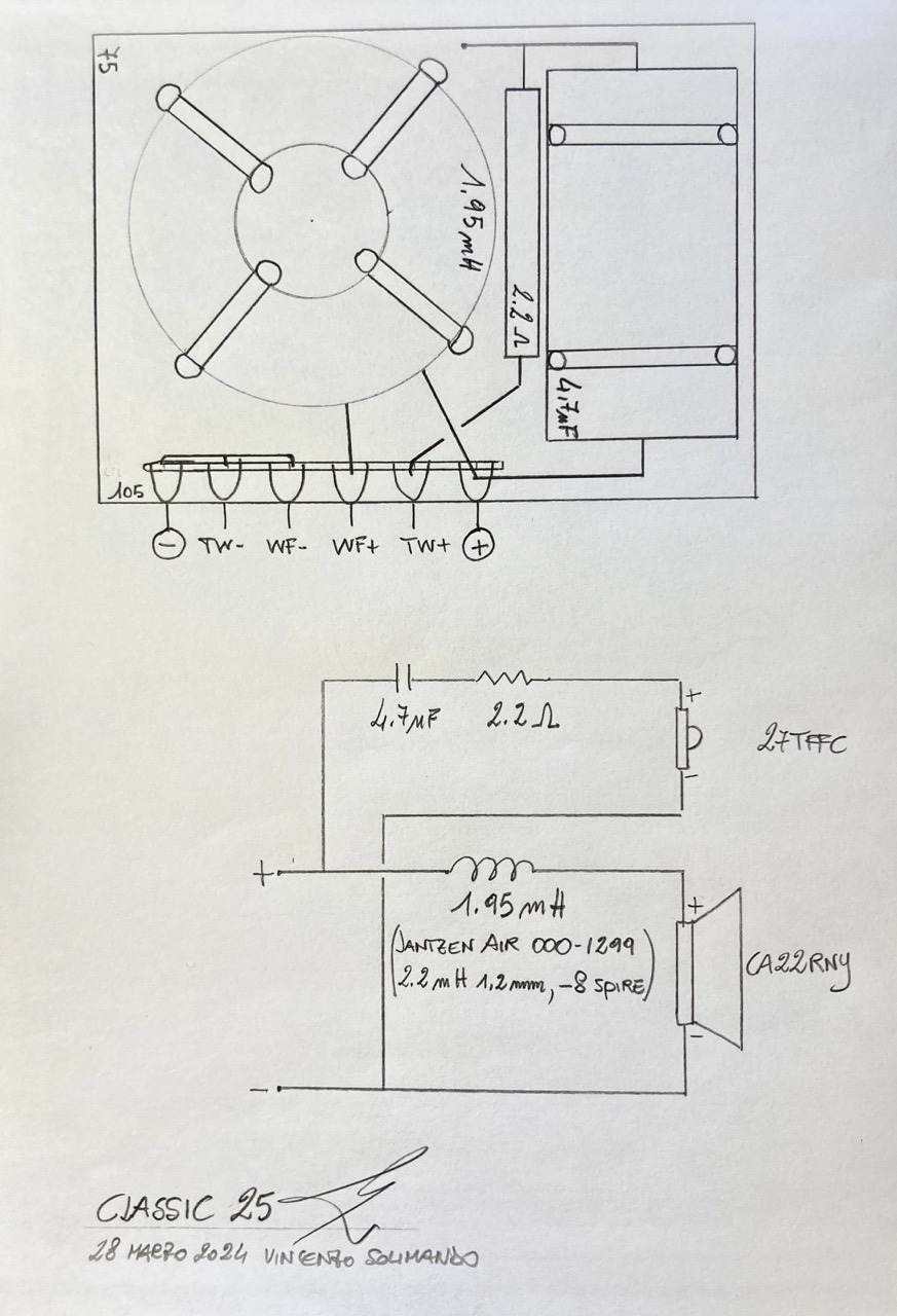

I fiddled around with a second order crossover for a couple of weeks, and then finally switched to a first order one. Incidentally, mixing first and second order did not give me audibly pleasant results in blending the two speakers, destabilizing the scene in certain frequency ranges.
In this regard, Seas declares a certain power handling of the tweeter, cut at a given frequency, with a second order slope. Using the first order I had to cut quite high and accept a reduction in the maximum manageable power, which I was able to do with the 27TFFC because with this acoustic order it turned out to be particularly good-sounding in my project and much more robust than my ears can perceive distortion and tolerate acoustic pressure. Maybe it won't be able to soundproof a square or pierce the neighbors' walls, but it can certainly satisfy the majority of domestic needs, giving a sweet, open and extended tone, without compressions, close to what I get with my Beyerdynamic DT 880 headphones (except the different frequency response).
To a recent question about my doubts about the power handling of the tweeter, Seas kindly responded by saying that they could not express themselves with certainty on the first acoustic order, but that having cut it quite high (4.7uF) in my case there should not be any sealing problems. Common sense, however, advises not to exaggerate with the power, reaching close to the limits declared for the second order, also because as it is it sounds really loud with a breath of current.
The CA22RNY woofer, for its part, is capable of linearly rising in frequency up to the crossover area, without showing critical resonance peaks, which are difficult to manage with a first order filter. However, great care is needed in determining the value of the coil, which in this case is not standard, but can be obtained simply by removing a certain number of turns from a common 2.2 mH to bring it precisely to 1.95 (I do not guarantee, however, the accuracy of the measurement with that cheap card). In practice, I used a 2.2 mH Jantzen Air 000-1299, 1.2 mm wire, removing exactly 8 turns from it.
Even if the reduction in mH seems insignificant, it is not insignificant in a filter with only three components that cross large parts of frequencies, if you want to obtain the best fusion of the two speakers. In fact, with an inductance of 1.8 the midrange of the woofer advanced and shrilled too much for my taste, while with 2.2 it was a little too far back with some voids. If a 2.0 mH inductance were on the market, we could possibly start from there.
Similarly, the value of the attenuation resistance of the tweeter can vary based on subjective tastes between 2.2 (light) and 2.7 ohm (dark), keeping in mind that in this or speaker a difference of 0.22 ohms is well audible. For me, currently, a 2.2 audio grade with a 4.7 uF capacitor is perfect. The first order cutoff with the 2.2 should be around 4000 Hz.
Be careful that here the length of the reflex duct also has its say, as it affects the audible resonances in the mid range, so in the end I adjusted it to 60 mm (32 external diameter) not so much for the low range but to obtain the best contribution to the box resonances in the mid range.

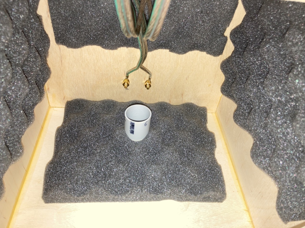

Finally, while tuning the crossover, I used a certain amount of damping material in the cabinet (30mm thick self-adhesive) to adjust the resonances of the box and the output of the drivers. What you see in the photo seems small and curiously arranged, but it is the result of dozens of movements and variations made simultaneously on the crossover, damping and reflex tube. A lot of work!
Here are the drawings of the cabinet and the crossover.

Materials for the box
  • 12 mm birch plywood, plus a second 22 cm piece glued under the woofer and then cut with the front, to have a resistant 24 mm thick frame.

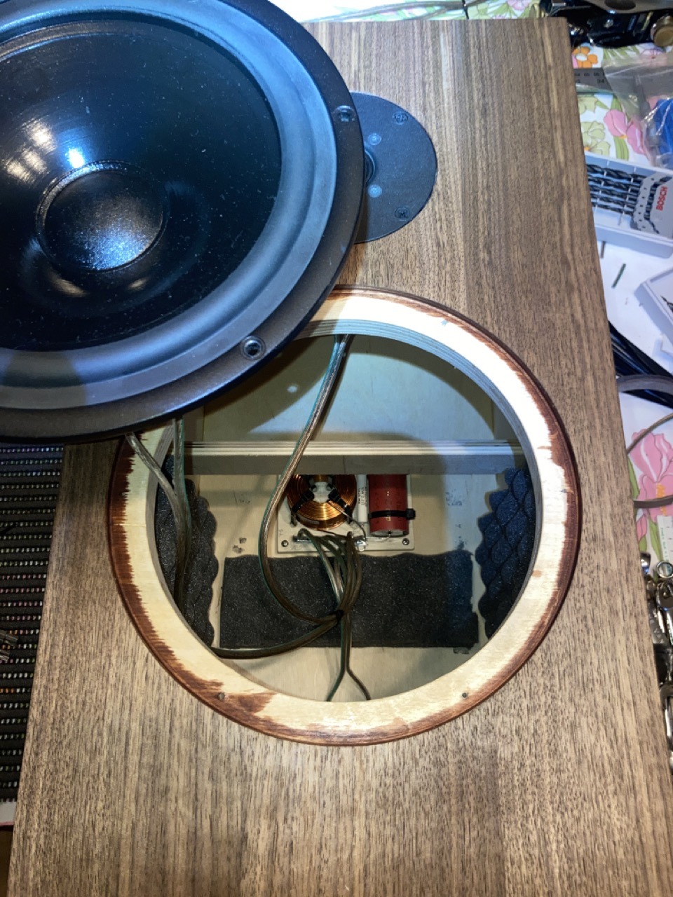

  • 0.6 mm veneer, glued with Bostik 99. The crossover must be set up with the veneer glued and the cabinet painted, otherwise tonal variations may be audible.
  • Adam Hall 4904 Feet - 25x15 mm.
  • Osmo Polyx 3011 paint, two coats.
  • Reflex tube 32 x 60 mm (internal 29), cut from a tube for electrical networks.
  • 30mm self-adhesive soundproofing. Side dimensions 13 x 18 cm (h x w), bottom (around the reflex tube) 16 x 18, rear (under the crossover, in correspondence with the center of the wf) 6 x 18.
  • 1.5mm OFC copper cables, 42cm long from crossover to speakers and 20cm from crossover to connectors.
  • Connectors 7.2cm from bottom, spaced 3cm apart.
  • Handles 6.5 cm from the top and 19 cm between them.

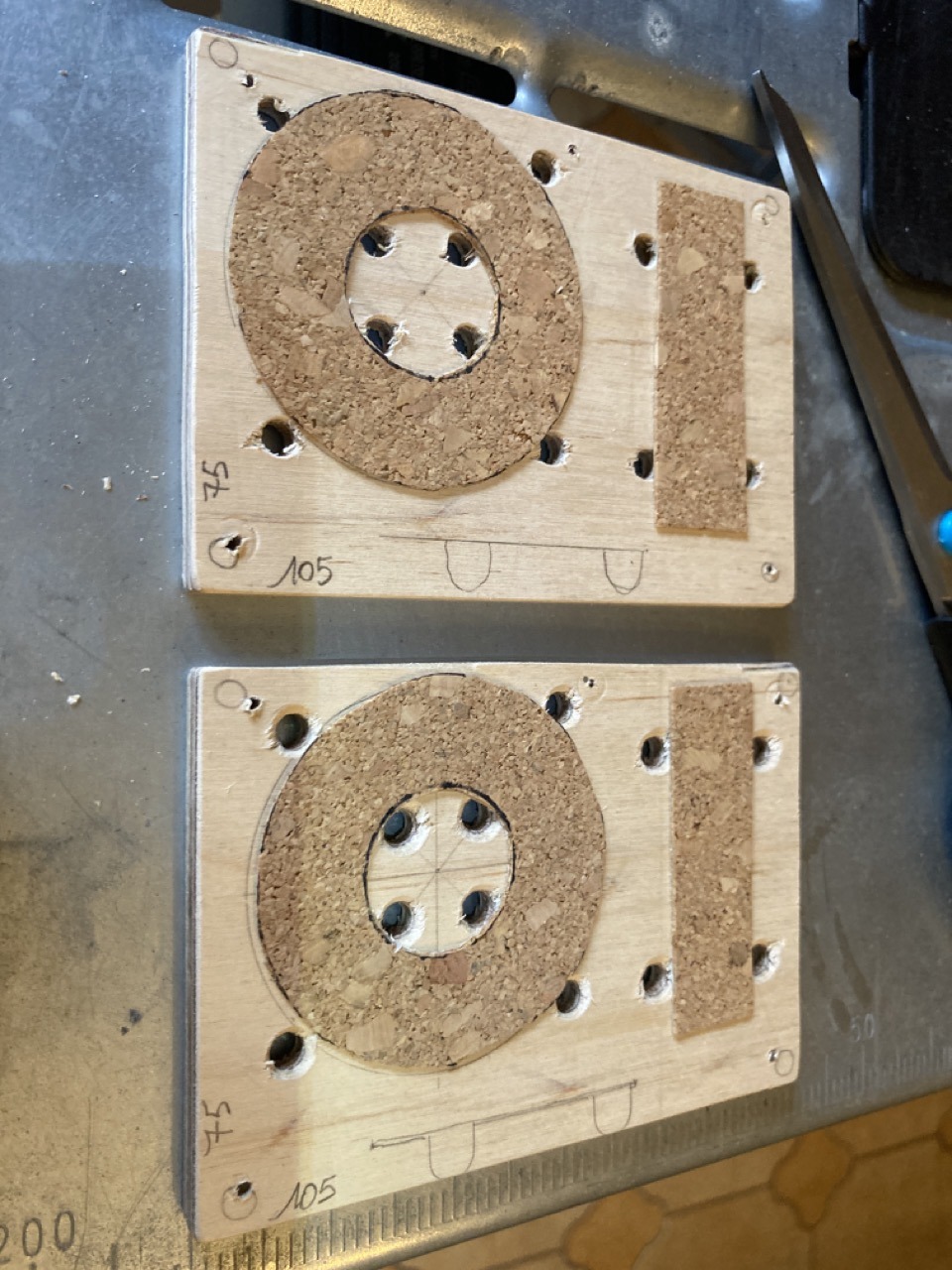

  • The 6mm birch plywood crossover base can be conveniently enlarged to 12 x 8.5cm.

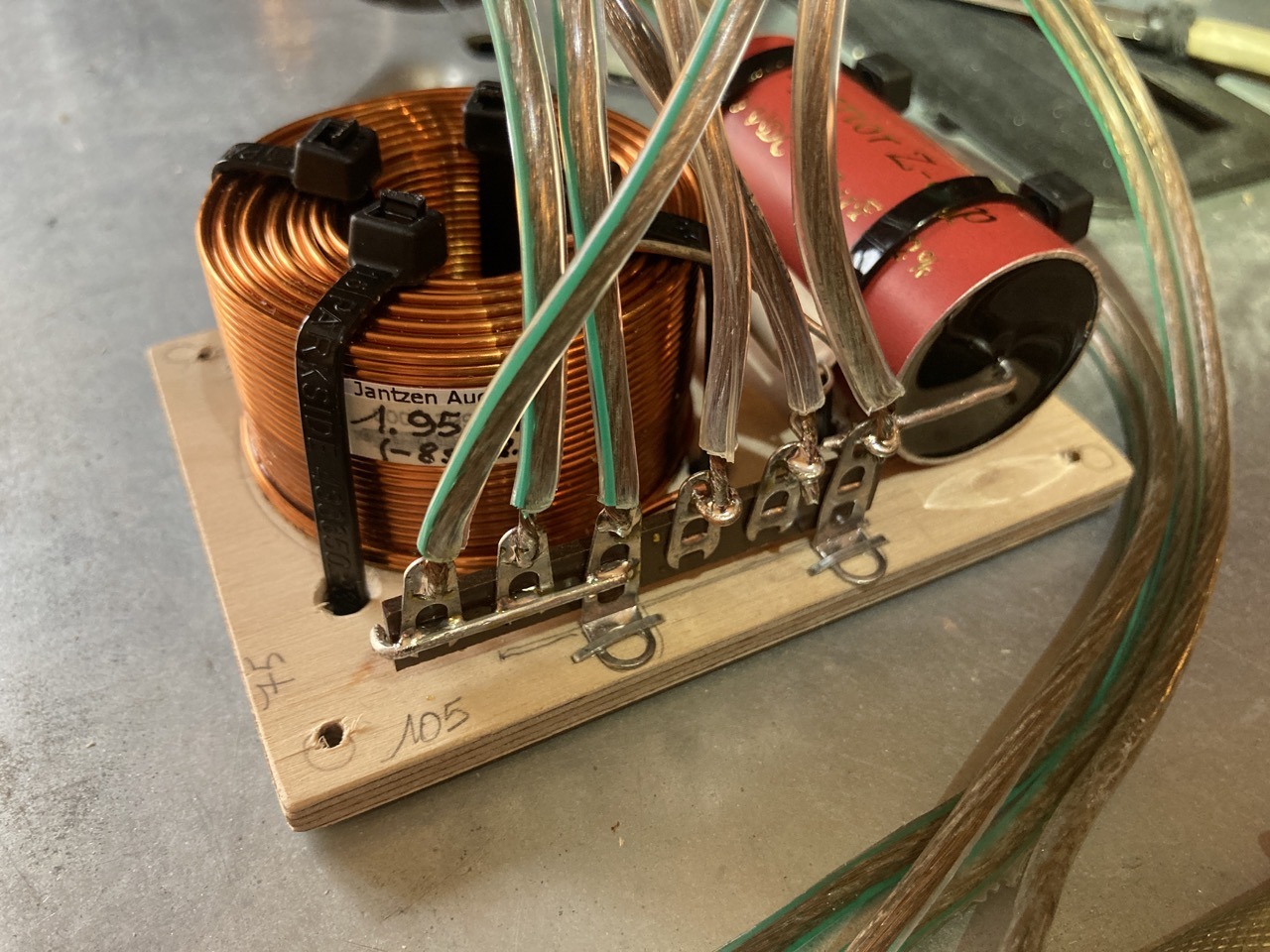

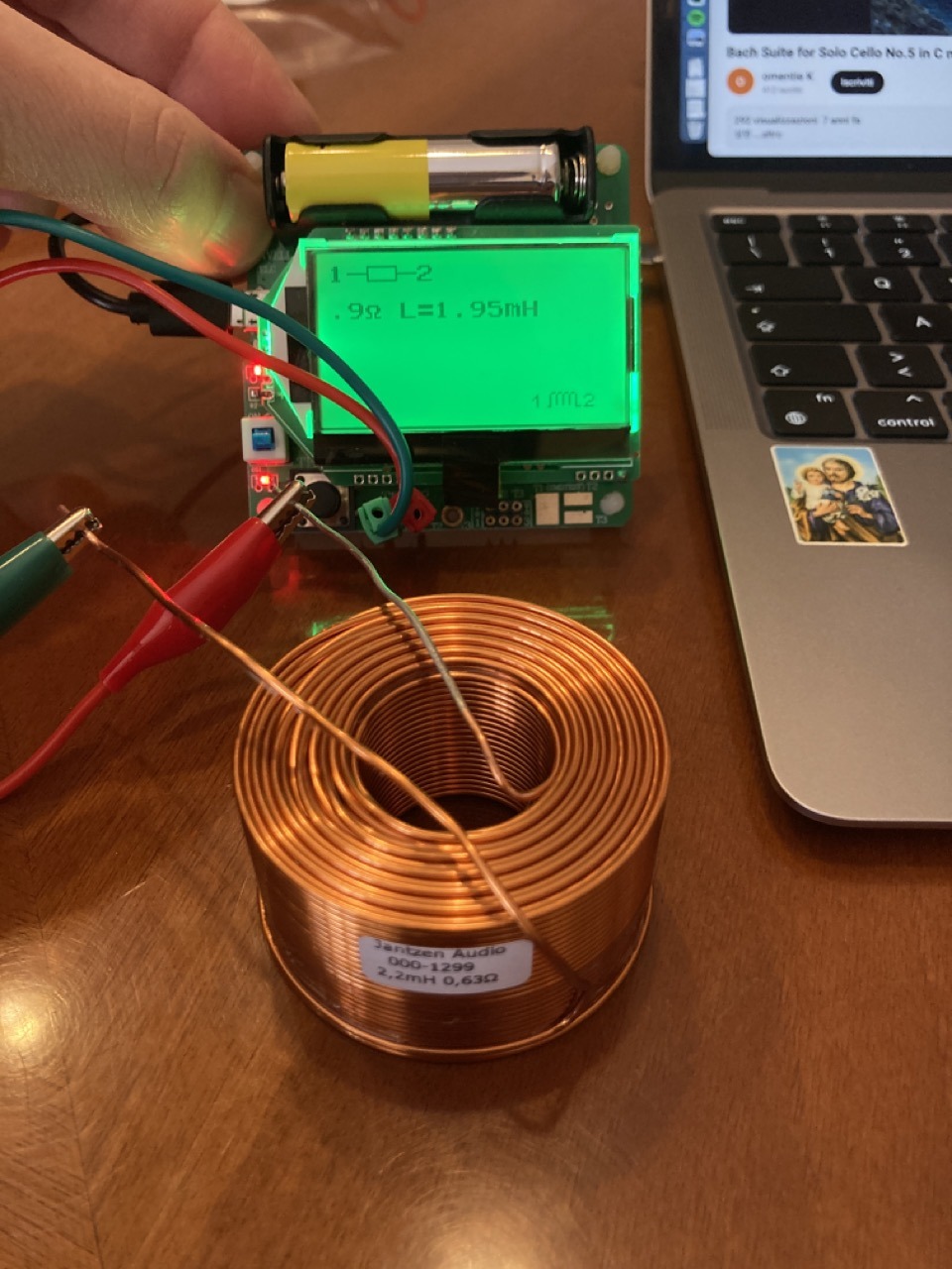

As regards the quality of just the three components of the crossover, already with a simple Janzten in permite inductance, a common ceramic resistor and a MKP or MKC Wima or ERO capacitor a good result is obtained, however the difference with the audio grade components is feels and is absolutely worth it, since there are only three.
Inductance. I tried the one in permite (no disc) and the one in the air. The 2.2 mH 1.2 mm permite (reduced to the necessary value) returns a fairly faithful timbre, rich in harmonics (but perhaps with some spuriousness), slightly open in the mid range, does not veil the sibilants, has a precise bass and a fast sound, certainly also due to the halving of the resistance. It doesn't muddy the sound even at high volume, as it gave me the impression of doing the same in permite with 1.0 mm wire, which I do not recommend. The 1.2 mm air one has a sweeter timbre than the permite one, especially in the mid range, but the sound is less ready and clear (it has approximately double the resistance). No loud crises. In the end I preferred the latter, but the choice between the two can be a matter of personal taste.
Capacitor. I initially tried ERO's MKT and MKC. I immediately discarded the first ones, the second ones were already better, but they gave me a slightly flat and narrow sound in the tweeter. With the Jantzen Superior-Z I immediately had greater sweetness, refinement and three-dimensionality, with the tw tending to disappear, especially at high volume.
Resistence. The difference between a Jantzen Superes or a 10W Ohmite AG and a common ceramic can be felt almost as much as the capacitor, that is a lot. The ceramic gave me the impression of introducing a bit of dirt and a sense of "glassiness" into the sound, causing me a bit of fatigue when listening for a long time. With it I had to increase the value by at least 0.15 ohm (2 x 4.7 ohm) so as not to hear too much screeching from the tweeter. None of this with the Jantzen and the Ohmite, which however cost 10 times as much. Furthermore, Jantzen has the value of 2.4 ohm in its catalog which can be convenient to have, together with the 2.2, to decide whether to give it a touch of extra sweetness.
In all, for a 2.2 mH 1.2mm Jantzen Air, a 4.7 Superior-Z and a 2.2 ohm 10w Superes I will have spent around 50 euros for each crossover. Obviously, I mentioned these components only because they were the ones most easily available to me, but I think that the level is equally good in components of equivalent cost from other brands, without prejudice to the tonal peculiarities of each.
Last two cents, I had the impression that the sound was veiled a bit both after veneering the front and after inserting the crossover into the box. However, they are more beautiful and simple this way. How difficult life is!…

In the end, with the work of a couple of weekends and a relatively low cost (let's say so!) you get a pair of high-fidelity bookshelfs with around 90 dB efficiency and a good sound impact, with a predilection for classical music and acoustic instruments in general, so easy to drive that even my 2A3 monotriode was at ease. On the other hand, the large magnet of the woofer, the type of crossover and the controlled resonance of the cabinet allow a transparent, coherent and detailed sound even at low listening volumes, so they are enjoyable even at night. If you then wanted to raise the volume and sound larger rooms, you could happily use the class D amplifier with which I developed them, the ICEpower 125ASX2 (https://www.diyaudio.com/community/threads/simple-amplifier-with-icepower-125asx2.373970/), and make the neighbors dance too. However, be careful with your hearing and tweeters! With this speakers you realize the listening volume when you are in the next room. In most cases, with just one watt you fill the whole house with sound and the volume tends to remain high for many hours.
But from tonight, alas, I will no longer have this temptation, because they will have gone away forever with their new master, my audiophile brother-in-law, and who knows when I will be able to rebuild a pair.

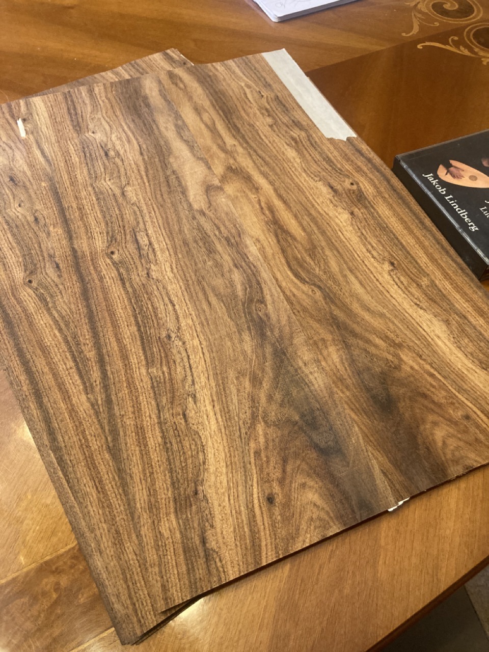

The only certain thing will be the wood for the next front, given to me a few days ago by a kind retired carpenter.
