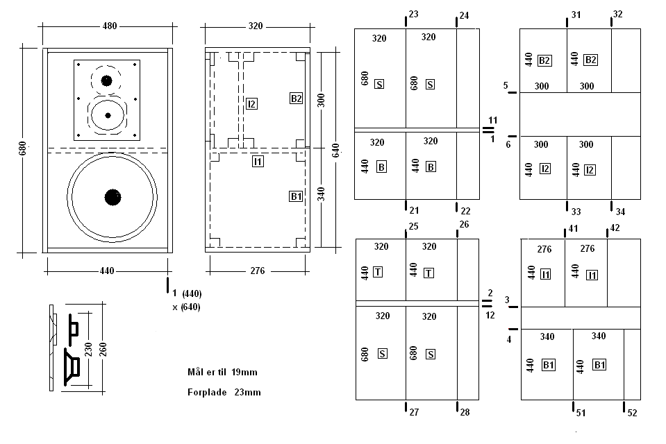

As we "speak" I am in process of cutting wood fore this "classic monitor
Front baffle is missing in cutting plans

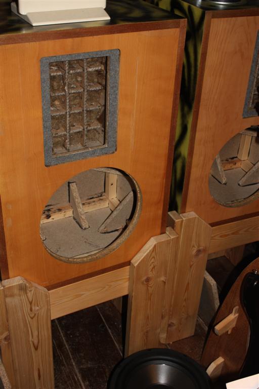

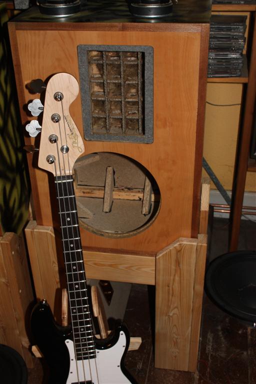

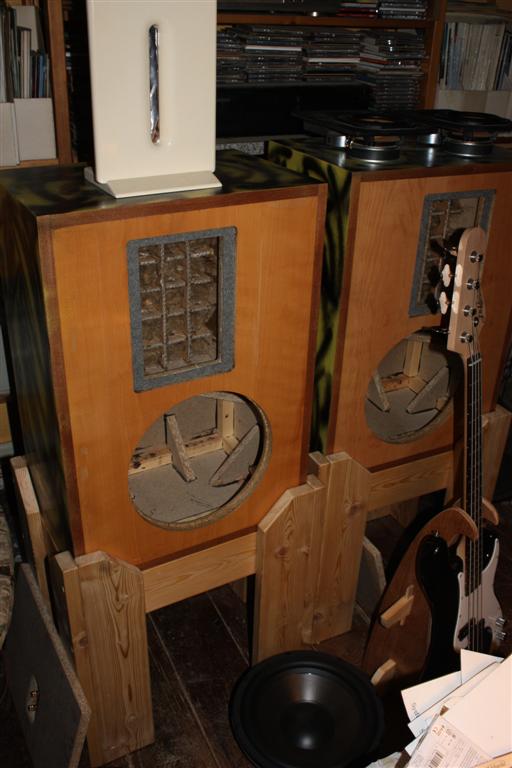

hey, beginning to look like a speaker, kind of, or maybe off
well, they were supposed to be bookshelf speakers
but I decided not to abandon the true "spirit" of hifi
![clown :clown: :clown:](https://files.diyaudio.com/forums/images/smilies/clown.gif)
![smash :smash: :smash:](https://files.diyaudio.com/forums/images/smilies/smash.gif)
and I can tell you, even without drivers, they are bloddy heavy
well, bloddy many small details to take care of, and still a few remains to be sorted

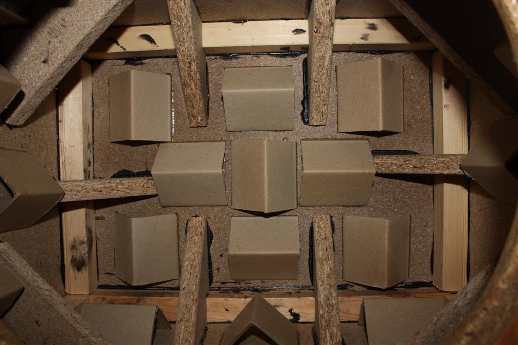

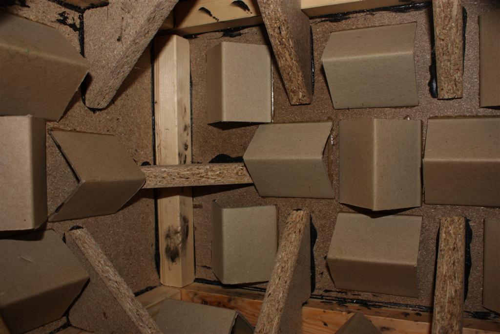

domestic view inside the woofer compartment
jesus crispies... all you need now is a rat and a timer. You know, rat maze!
