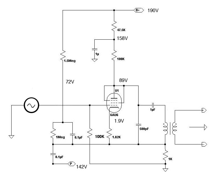

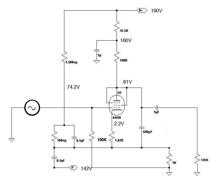

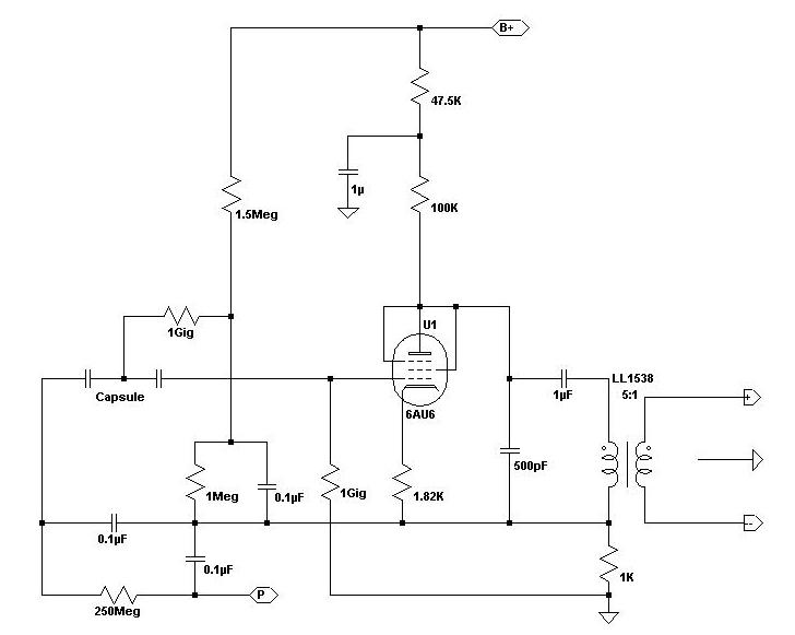

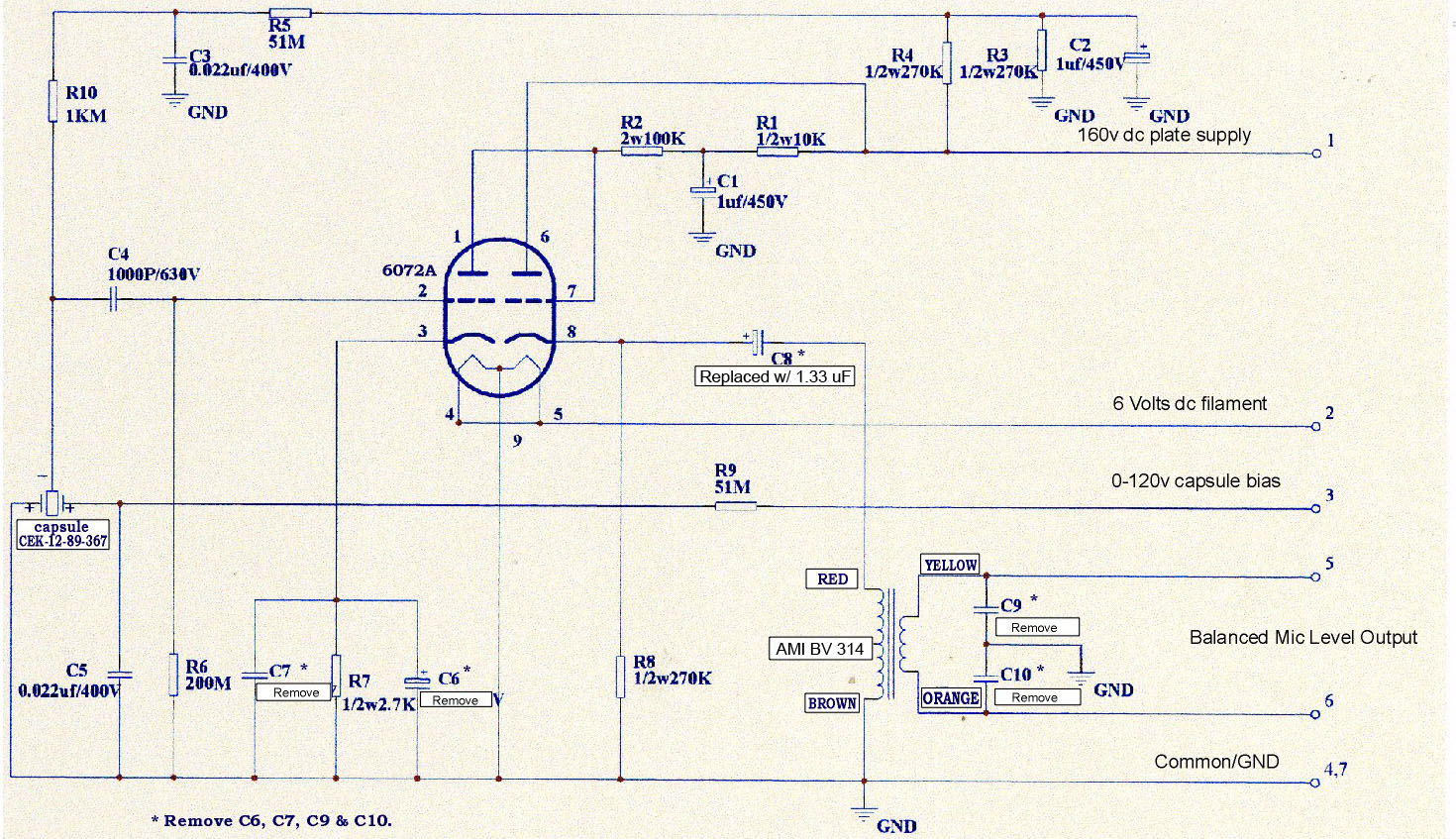

There's quite a few on diy audio just search. Balanced in, balanced out? The best tube is probably ecc88 for noise. Transformer step up at input ECC88 gain stage followed by ECC88 cathode follower and output transformer. There are lots of other options including nuvistor tubes, and differential amps.
6AU6 mic preamp.JPG 6072 micschematic.jpg r8testingcircuitv2voltaef1.jpgr8testingv2trafodz9.jpg

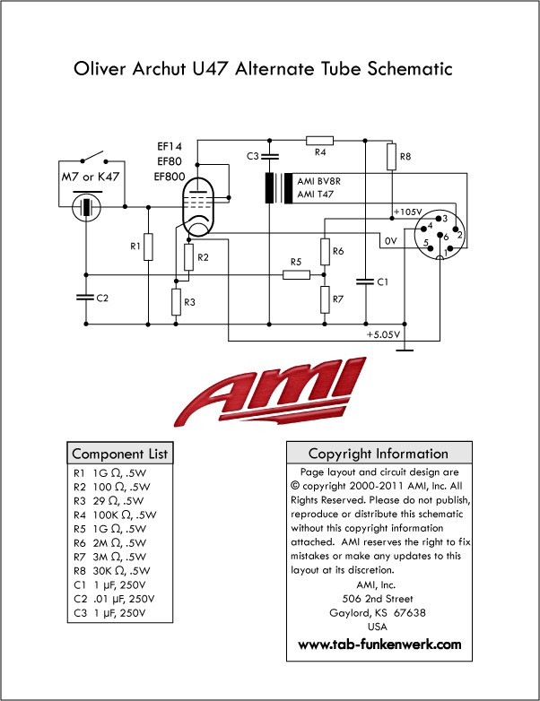

Do you know this?
https://www.tab-funkenwerk.org/
