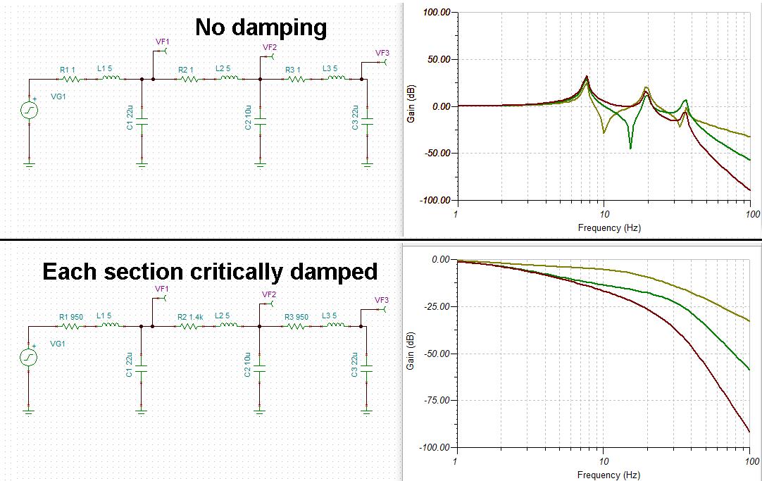

I read from "Designing High-Fidelity Tube Preamps" and learned that LC filter may need to be "damped" by adding resistor in series to the choke, and multiple LC filter (e.g. LCLC), although can achieve a much higher filtering, may lead to multiple resonance frequency, which even under audio frequency, may still cause stability problem like motorboating. Nevertheless CLC is frequently used, at least, for the output stage as RC simply consume too much power to provide adequate filtering. I want to explore how to properly implement CLCLC filtering but seems there is little mention to the multiple resonance frequency and how should it be damped. I would be appreciated if you can share what you know on this topic and any good materials discussing about this.
You can use PSUD2 simulation to apply a step load change to the output of any form of CLCLC.... filter, and then determine the damped resonant frequency of the response waveform. The aim is not to have a resonance within the audible frequency range (ie. force it to be low), and have it well damped.

One approach is to have multiple pi-filter resonances at least a factor 10 apart. Would be impossible to obtain with three filters though. Just fill up the capacitance I would argue and stay with two.

The maths is very complicated since you are dealing with a fourth-order filter (or more). The easiest thing is to treat each LC section separately, and use the equation to find a suitable damping resistance for each section:I want to explore how to properly implement CLCLC filtering but seems there is little mention to the multiple resonance frequency and how should it be damped.
R = 2*sqrt(L/C)
This will give you something close enough to critical damping. It might not produce a truly 'optimum' result (use a circuit simulator if you want to look at the frequency reponse) but it will be good enough.

Practical example?
R = 2*sqrt (L/C)
R = 2*sqrt (10H/0.00022F)
R = 2*sqrt (45454,545)
R = 2*213,2 = 426,4Ω
If L have for example 10Ω only needs 416,4Ω?
Another practical example.
R = 2*sqrt (10H/470uF) = 290 ohm
That is a surprising high value for a practical build. Too much drooop.

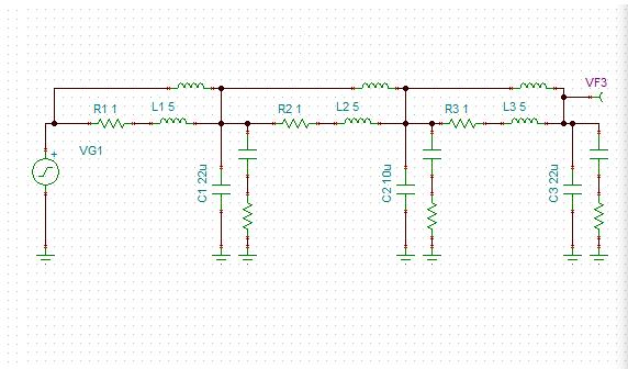

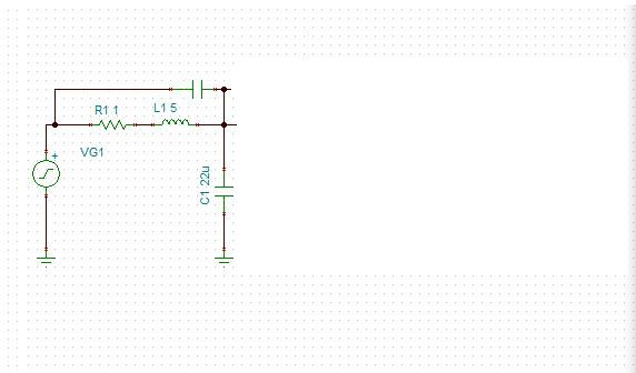

I recently revisit the LCLC input filter resonance topic and I noted from the internet that, rather than adding damping resistor in series with the inductor to damp the resonance, the resistor is added in series with the capacitor. I hope some of you would share your view on this.
