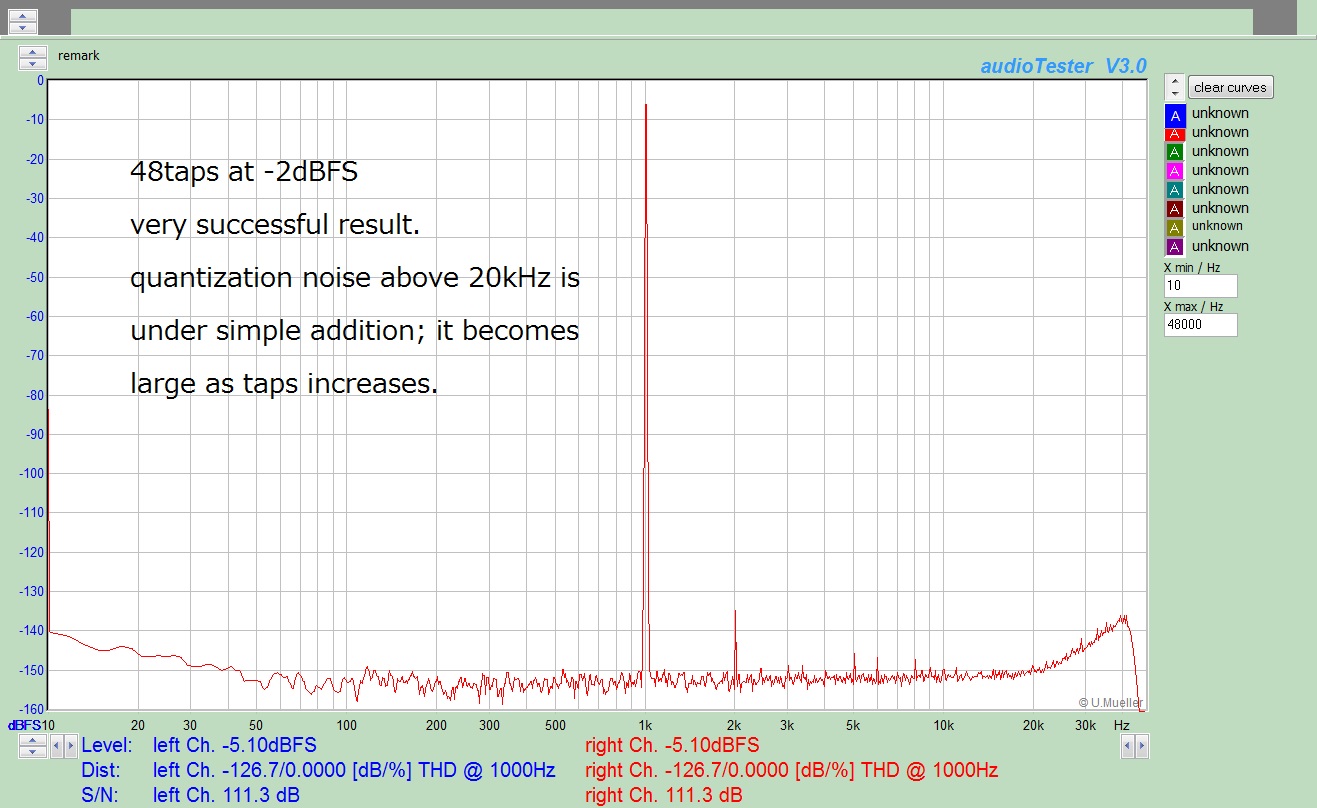

With digital audio, the bottom line is that sampling works, and it is theoretically a perfect process: you get back exactly what you put in. It allows for a totally accurate and faithful means of conveying a complete audio signal, from one place to another.
So, the numbers arrive from one place to another, it's all good, right? It must be, according to the above paragraph.
But, there is more; we can easily increase the amount of those numbers and make a copy sound much better than the original. Frequency response? Up to 100kHz, easily. But, there is (still)... more! Converting the bit depth to 32 bits.... even more numbers. The dynamic range through the roof!
Now, who would say no to that! Everyone's excited, the crowd is clapping.
Audio Nirvana for all of us.
