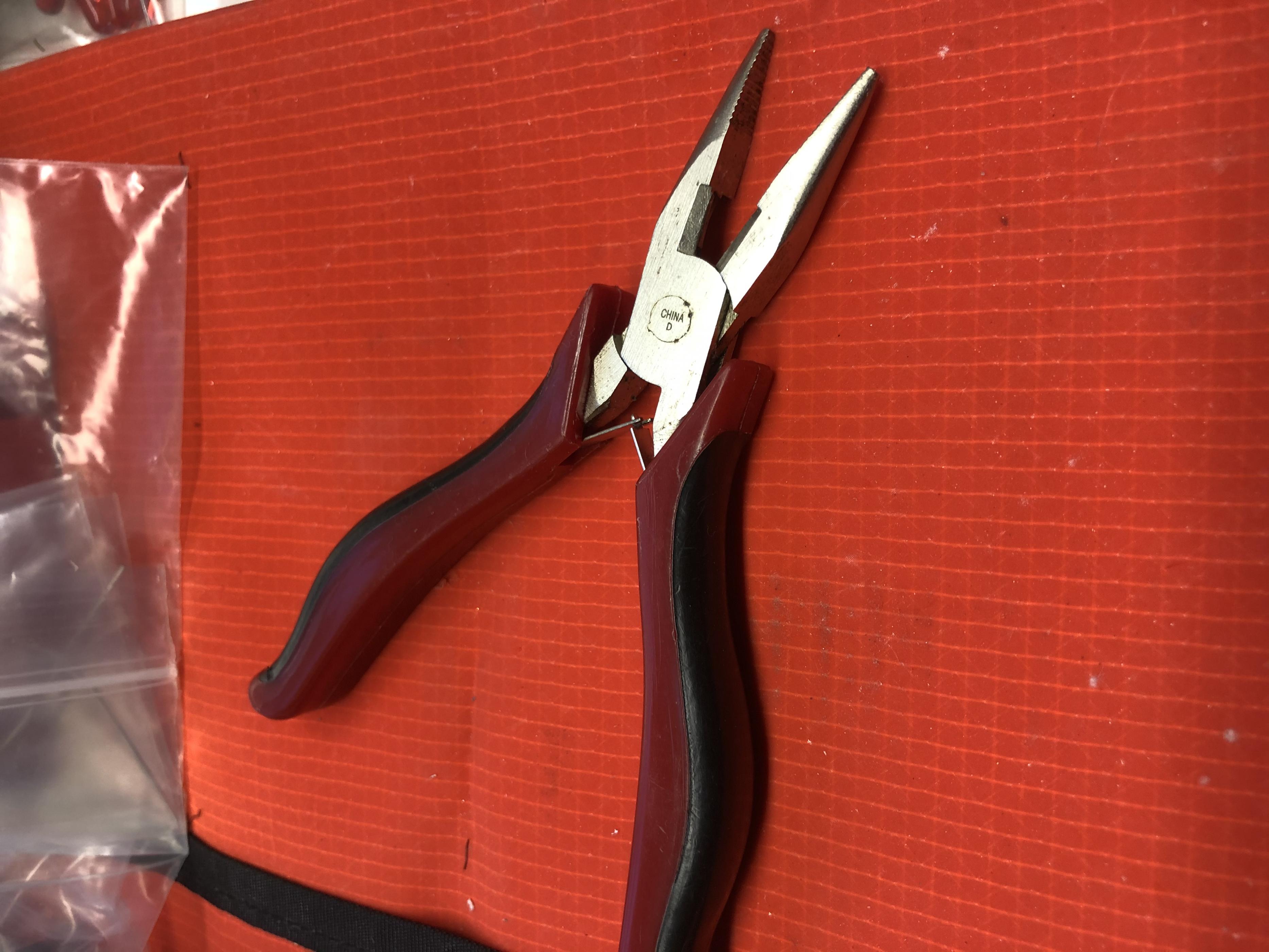

I’m sure other people have used a variety of tools to remove the old stylus. A long nose pair of pliers probably would not have very good control or leverage. I used the small pointed pliers pictured below which has a gripping texture in the jaws. I found it worked better on the small slippery plastic during removal.

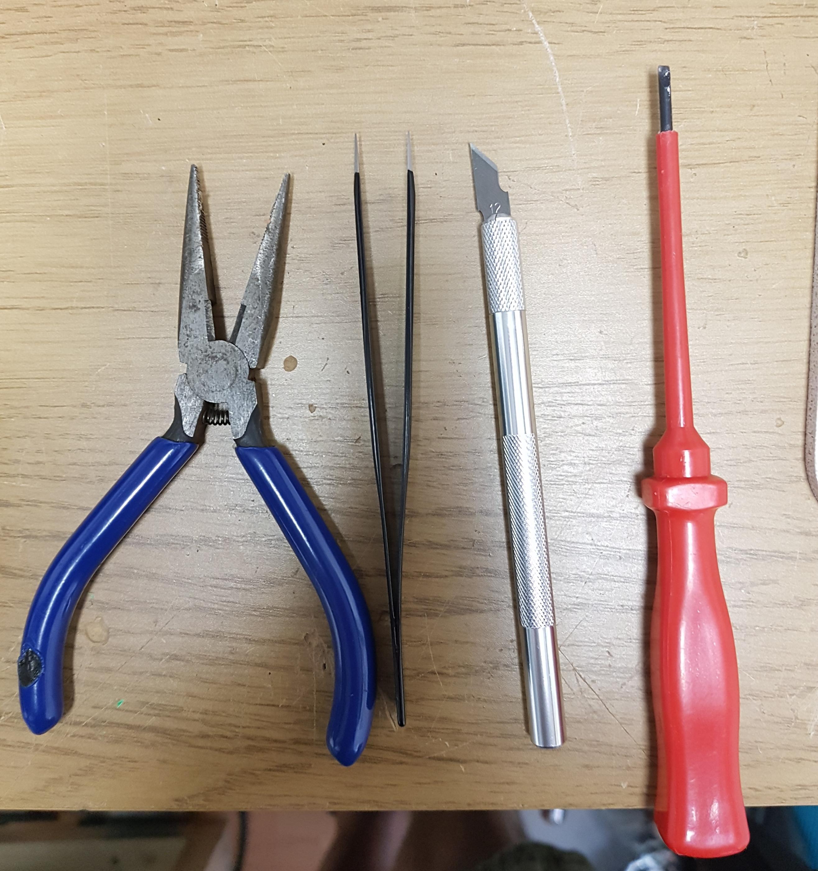

I am glad to say that I followed the instructions on this thread and have successfully fitted an ATN95e stylus onto the clear audio concept MM cartridge. Thank you chromenuts for giving me the detailed instructions. I can't believe how good the sound is. I don't know if I had damaged the original stylus because I had hit it so many times when cleaning the turntable that the cantilever was bent. Anyway, it sounds amazing now.
If anyone is doing this job be careful when you are disconnecting the wires from the cartridge. I used a tweezers for electronics. Be careful that the metal plug comes off and not just the coloured plastic. That's what happened to me with the white cartridge plug, just thought I would inform yous.

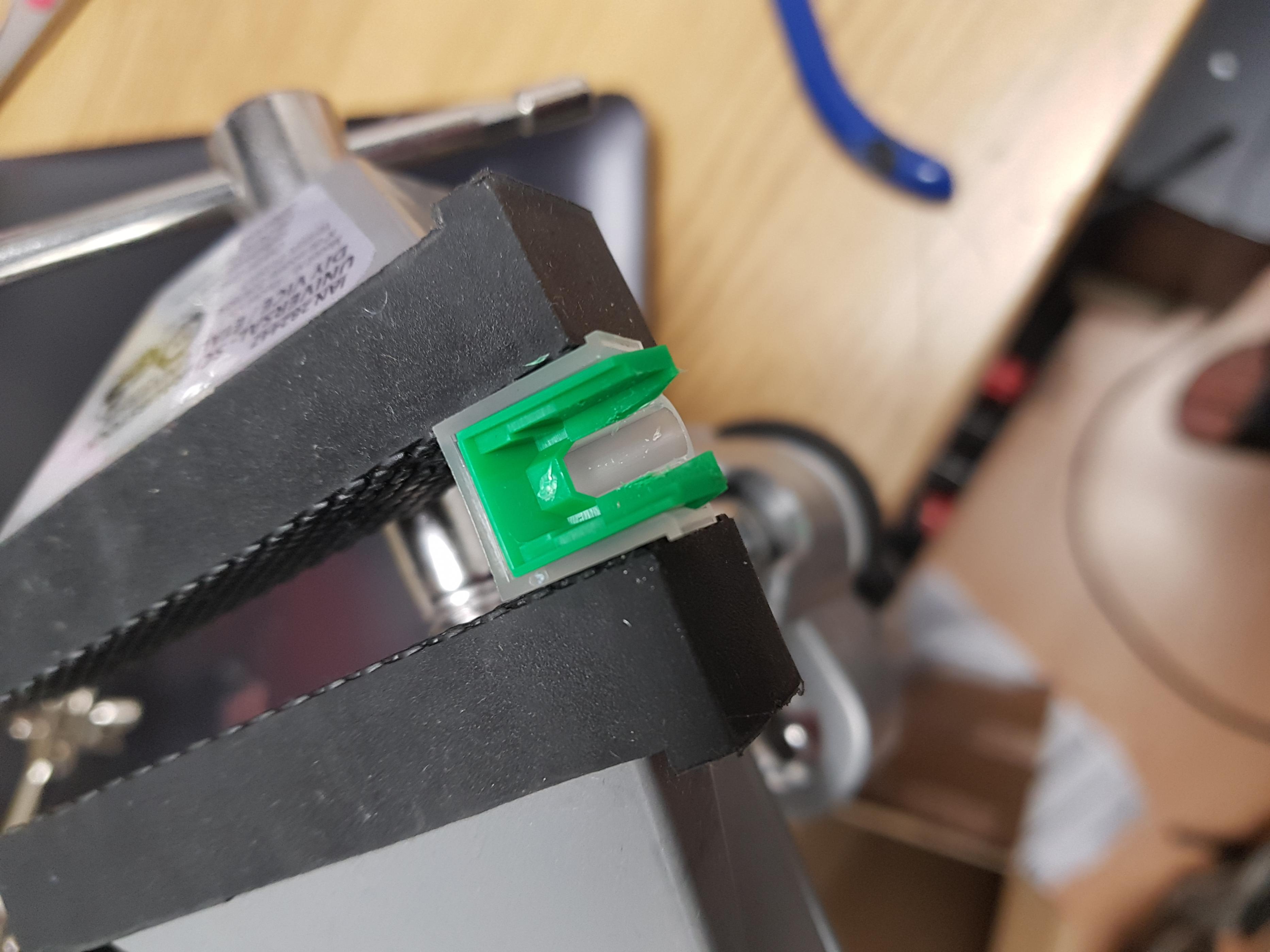

The old stylus came out very easy following the instructions. I put the new stylus in a clamp and used a craft knife to do the cutting. Taking it very slowly and carefully. I held the stylus in the protector with my left hand as I used my right for cutting. The new stylus went in easy peasy. Just be very careful and gentle. I will upload photos of the tools I used. Thanks again, you good people.
