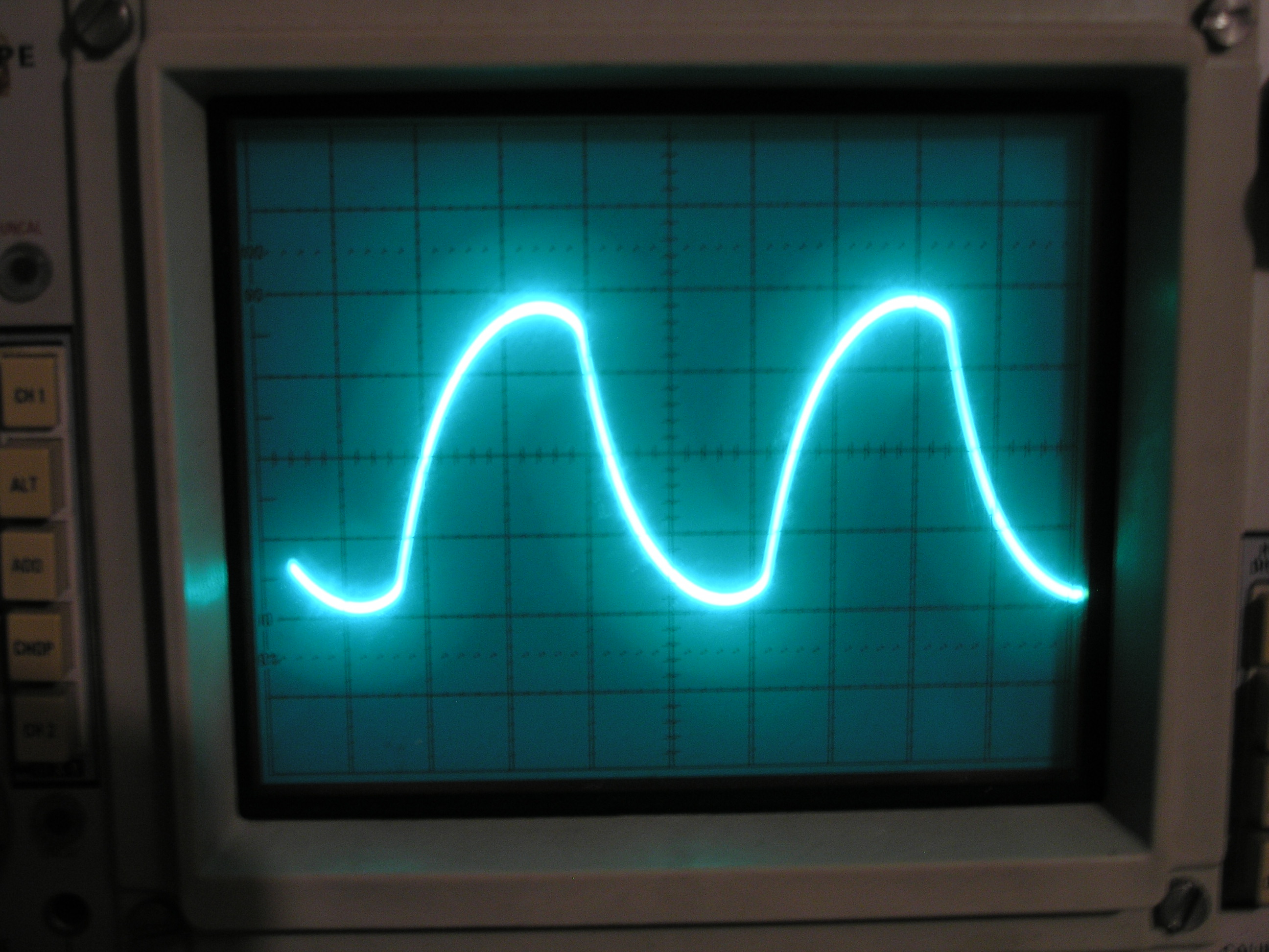

Hi, I did some snooping around on the internet and people said they heard a difference with the 1N4148/1N4001 combo and that it gave enough asymmetry. I didn't give a listen after I tried that combo but nothing looked different on the scope so I didn't feel confident that I changed anything.

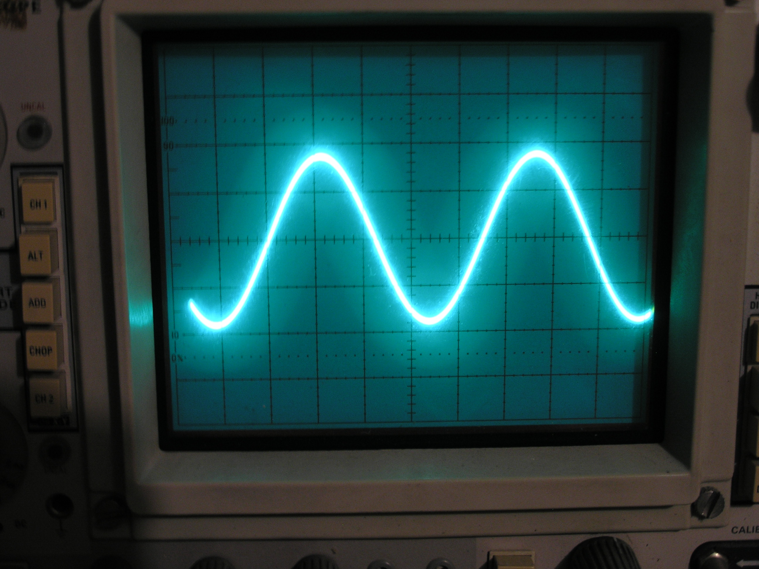

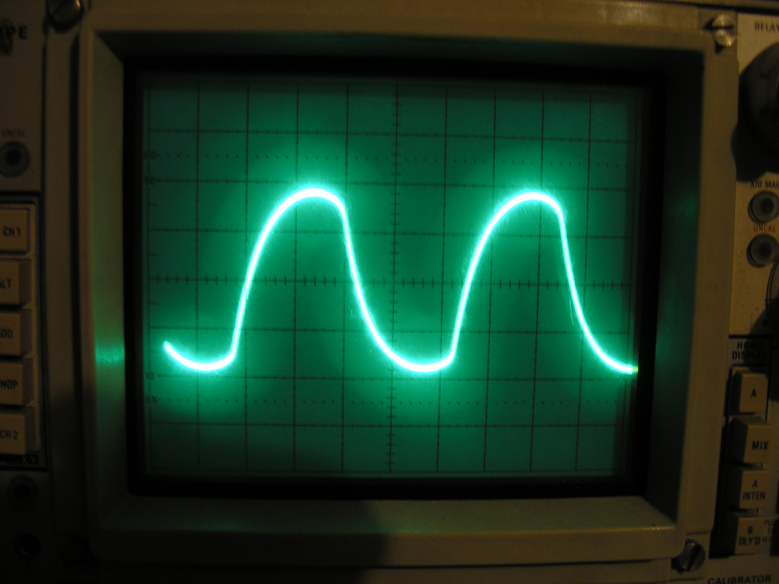

I agree I need a completely different diode with a completely different forward voltage drop. I had no LED's so I took the two original diodes and strung them in series for one side and then I used a 1N4148 for the other. So theoretically I should have 1.2v voltage drop on one side and .6 on the other.
Here are some pics. Clean input. Normal distortion. Then modded distortion.
Controls are set to the same setting. 440Hz input @ 200mV.
I will plug it in and report back on the sound analysis.

Yes this is where I started because the two diodes with slightly different forward voltage drop wasn't if at all any different than stock. I measure the anti-parallel diodes at .6 and .64 so the asymmetry wasn't enough. The three diodes is a good starting point indeed, but I like it enough to leave as is for now. Maybe I can scrap up some LED's form junk electronics as suggested and go for more asymmetry in the future.

Yes it appears I did exactly the same diode arrangement that's in the Boss SD1. I played it last night for a short period of time and I can easily notice the difference, I am digging this sound a lot🙂 Thank you for sharing that info.
