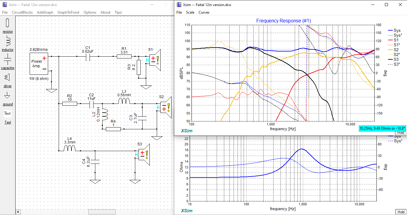

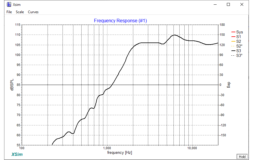

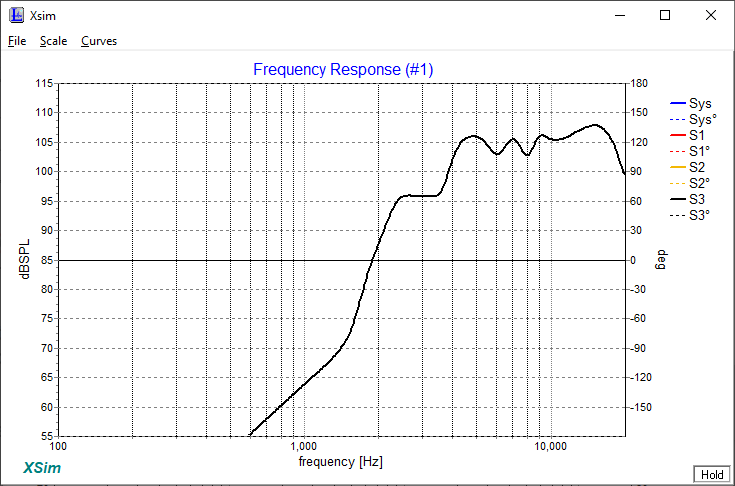

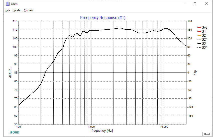

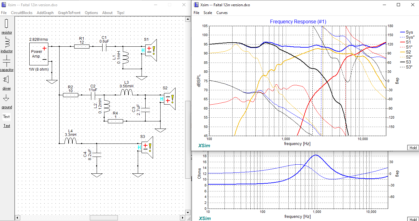

I am going to perform a few simulations. I don't have the drivers but I can obtain the frequency response for each driver from the manufacture datasheet.
The first version will be using the following drivers:
1. FaitalPRO FD371 Super Tweeter
2. FaitalPRO HF146 1.4'' Compression Midrange
3. FaitalPRO 12PR300 12in bass driver
The first three plots are from individual drivers. The overall efficiency is about 96dB.

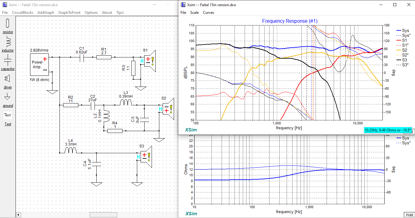

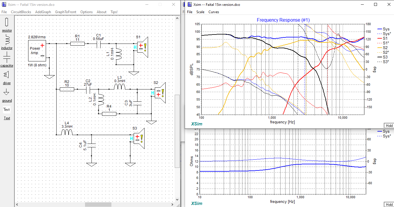

This one is similar to the one above but using a FaitalPRO 15PR400 15in. bass driver which will result in a gain in efficiency. This version will give about 98dB of efficiency.
This version will be using the following drivers:
3. FaitalPRO 15PR400 15in bass driver

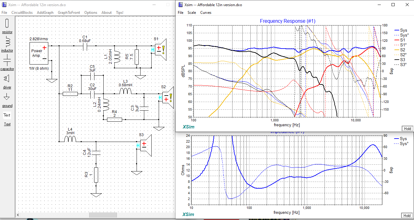

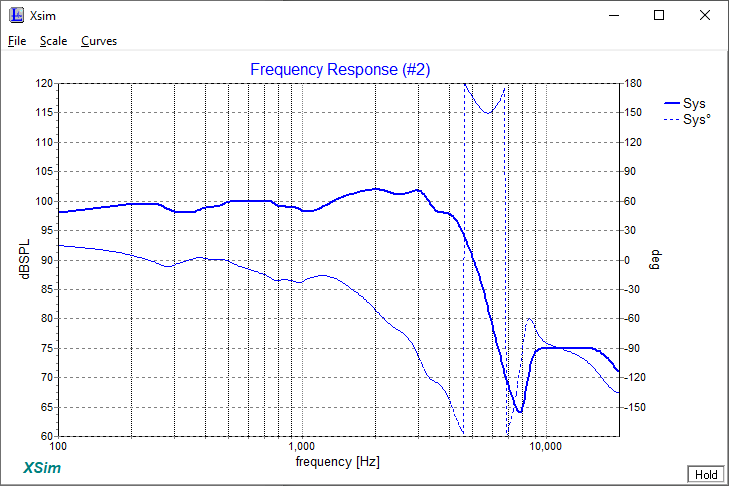

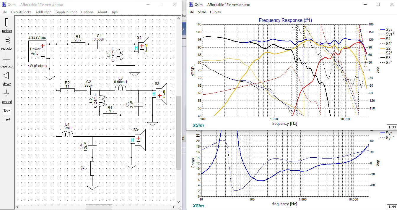

Here would be a more affordable version using 12in. base driver. The drivers are:
1. PRV Audio TW450Ti-Nd-4 Super Tweeter ($44 each)
2. PRV D3240TI Compress Mid ($100 each)
3. Dayton PA310-8 12in. ($66 each)
The first three plots are the freq. response of the super tweeter, compress mid, and 12in. bass respectively. The overall efficiency is about 95dB.
The difference between the affordable and expensive versions are the expensive versions have better frequency response, whereas the affordable version freq. response is somewhat ragged.

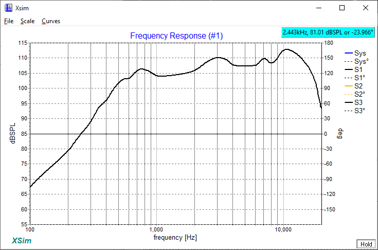

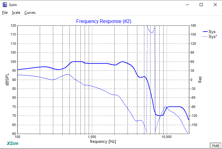

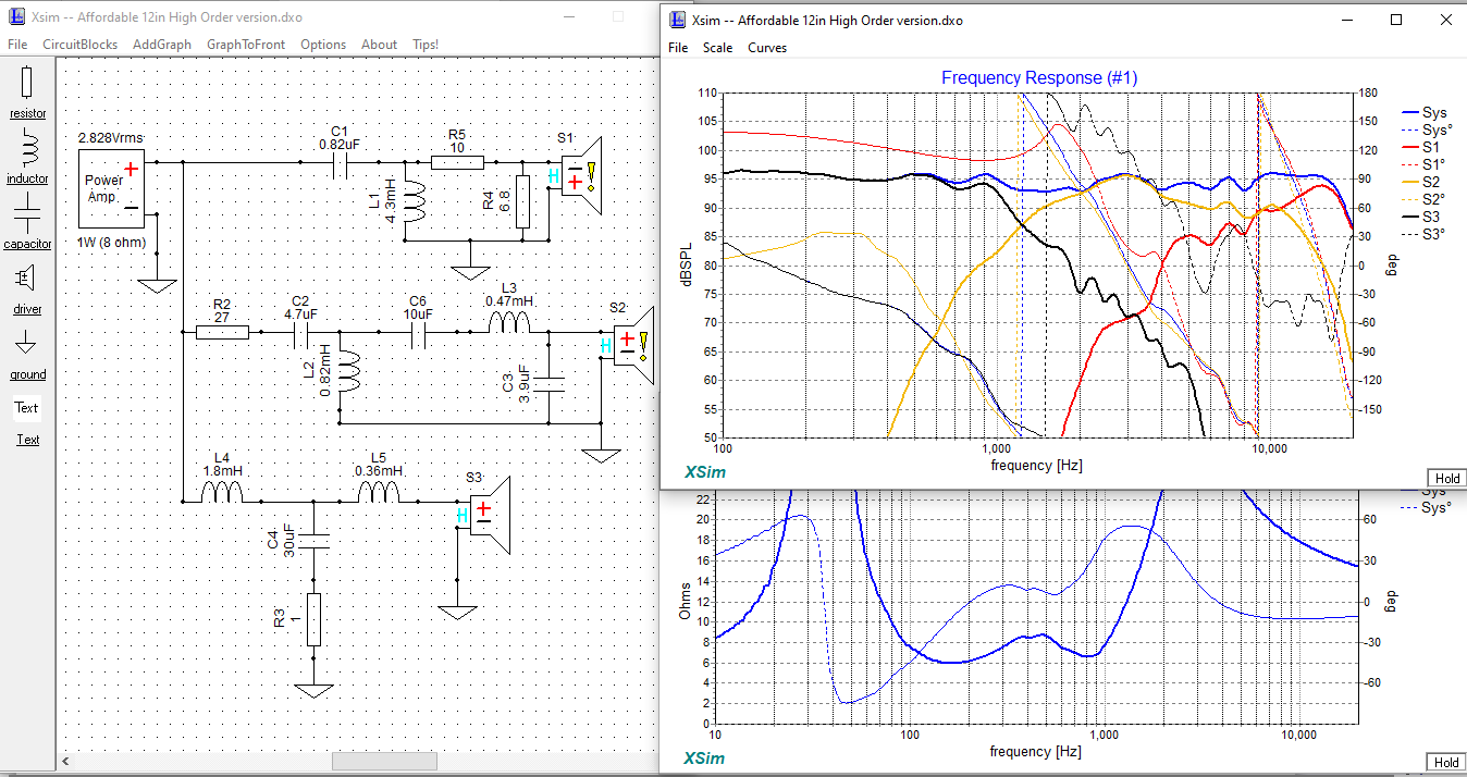

I reworked the xover for the above example but this time using 3rd order electrical. The frequency response is a bit more even.
I also reworked the 2nd order version to make the frequency response on the upper frequencies a bit more even. Also the resistive attenuation on the tweeter is slightly improved such that the impedance overall is lower which may be important for no-feedback tube amp. Too much impedance on the high frequencies could make the sound a bit harsh on the top ends.
Here are all four versions. The tweeter section was reworked to lower the impedance on the high frequencies and as said above, it helps if using no-feedback tube amp.
1. Faital 12in. bass driver - 95dB
2. Faital 15in. bass driver - 98dB
3. Affordable 12in. bass driver using 2nd order - 95dB
4. Affordable 12in. bass driver using 3nd order - 95dB

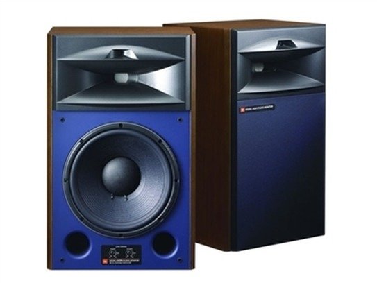

Cloning the "Uno" is probably beyond my diy skills. The JBL4429 would be a good alternative and closer to what I can do in term of diy. I don't have much info on the Uno, but it seems like it's also a 3way like the BJL with a conventional bass driver, a super tweeter, and a compression mid. I have not listened to the JBL personally, but I've heard a lot of good things about it online.
JBL 4429 Dimensions (H x W x D) 400mm x 635mm x 300mm (15-3/4” x 25” x 12”). Crossover frequencies are the classic movie theater "clean speech" range 800Hz, 7kHz. A 800Hz crossover supports using a 12" ported WOOFER with 90db sensitivity, and not a 12" MIDRANGE like the Faital 12PR300 with 95db sensitivity required with a 1300Hz EconoWave crossover. A cabinet width of 25", like the JBL 4429, must take advantage of the wide bandwidth directivity control from of a 24" wide horn/waveguide like the SEOS24, with a 1.4" compression driver.
