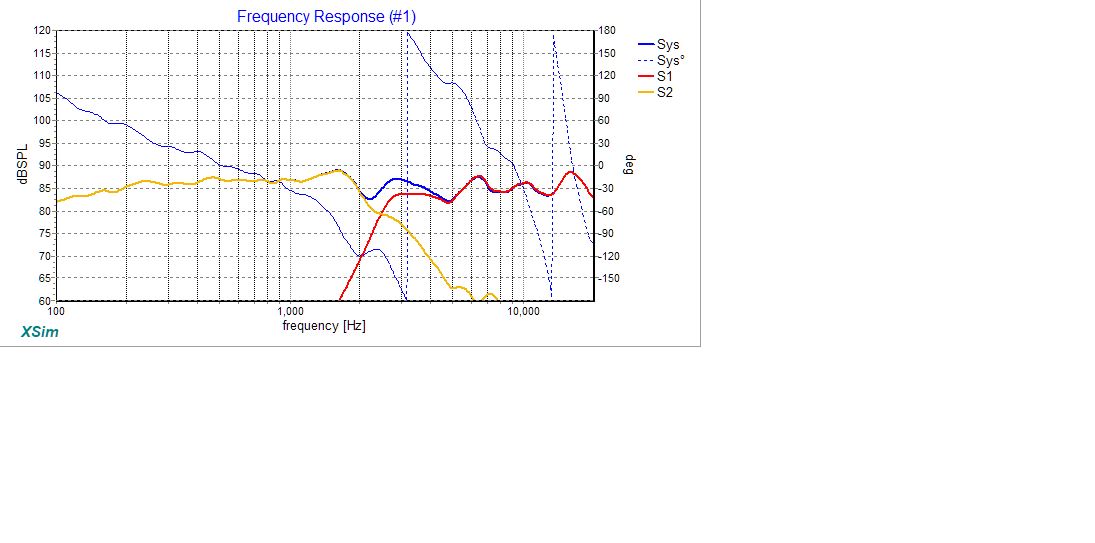

Here is my concern. For the crossover frequency between the bass and midrange, I think I am OK- I will probably do something in the 300-500Hz range, well above the midrange's Fs/low frequency (~90Hz). But for the coaxial...... strangely, the low end of the tweeter (4.5kHz) is well above the beaming frequency of the midrange (~3.4kHz I think). The Fs of the tweeter (2.8kHz) is below that beaming frequency, and the tweeter does have decent SPL below its rated range but I don't want to push the crossover to say, 3k and potentially damage the driver.

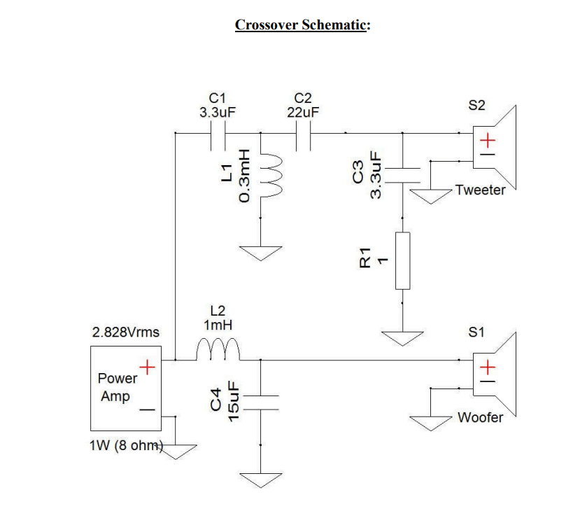

So the TL;DR is, what frequency should I crossover the midrange/tweeter at? To be fair I haven't noticed anything super bizarre about the sound; I have the drivers in a test baffle now crossed over at like 150 and 5k I believe. The coax sounds a little lifeless/dull with the plain DSP crossover I have vs the passive crossover it had in the PE box so I guess I can study the original crossover to see what frequencies they chose. Here is that schematic:
What do you think? Am I overthinking this? Subjectively my only complaint is that the coax sounds a little lifeless. I will take some measurements and play with the EQ for taste I guess.
It's hard to offer an opinion because we can't hear it or see any measurements. The datasheet suggests to be a 3k crossover would be appropriate but this is the acoustic target and may not be what electrically you will need to program the dsp to achieve this. Do you have a measurement mic? Time gated measurements are applicable in this range.
Parts-Express has the FRD and ZMA files online. It looks like you are using XSim, so you can play around with that.
There a a good bit of overlap between woofer and tweeter, which should make things easier.

advice how to "copy" a passive x-over.
That's another possibility...
I think the xover has too much BSC and the woofer is very peaky / difficult to linearize. I've tried this same coax. The tweeter doesn't gel well with the woofer and the needed xover point is too low for the tweeter.

Hmm, for polar matching and assuming the woofers are ~pistonic to the Vc frequency, which judging by how closely its TL modes maintain flatness, then the woofer's 2.5" = 4380 Hz = sqrt(47.44*4380) = ~456 Hz XO and the coax woofer's 1" = ~4311 Hz, making this the end of it matching the tweeter using traditional theory, so from this point on it's about finding a measured overlap (if any), but the ~4311 Hz isn't enough lower to be a power handling problem unless this is a ~max peak SPL and/or a high average SPL app.
