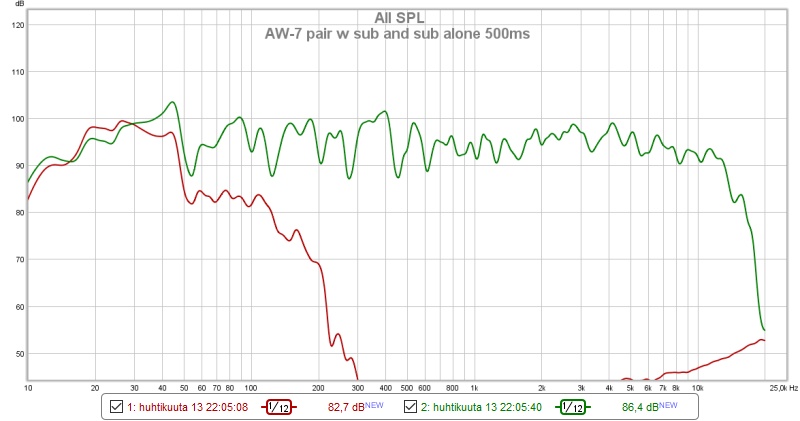

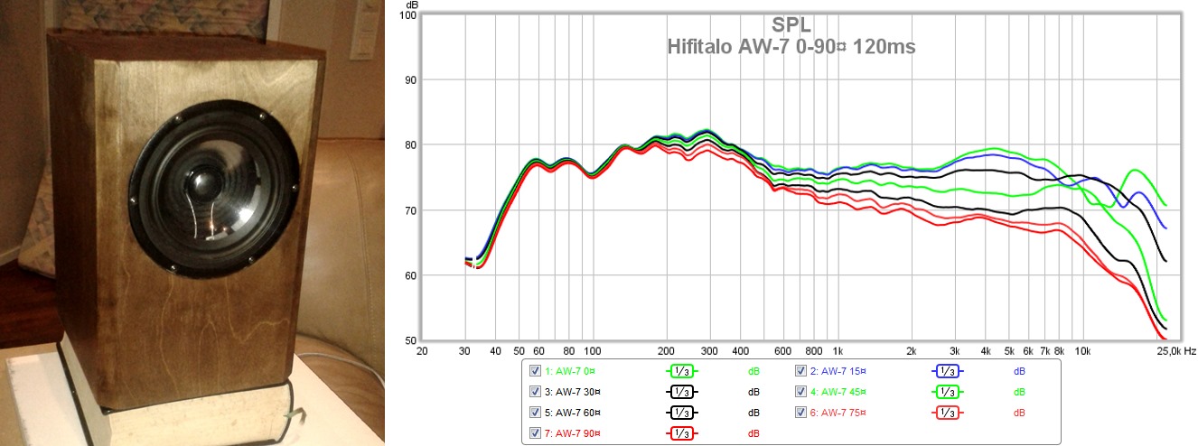

I wholeheartily agree with Adolf C! I have three SEAS T18s as my HT mains, closed 8 liter boxes. xo from a kit here Aw-7 rakennussarja - Hifitalo
Very nice in a small room even without a sub. With a sub and some eq, super imaging and soundstage in a SMALL room! But T&F and KEF LS50 are obviously not optimally cost-effective implications...
My AW-7 spatial response (120ms IR gating) and with a sub in HT room (500ms)
