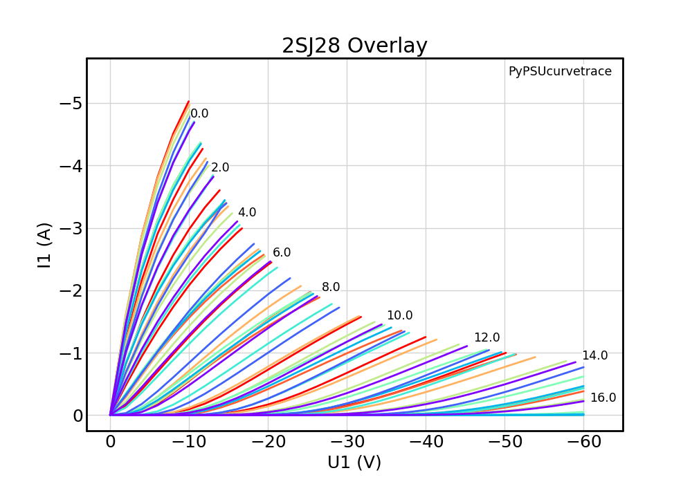

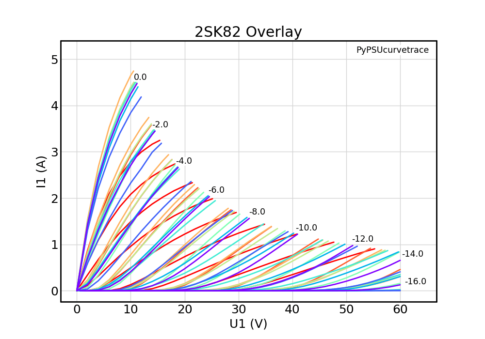

Take a look at the curve plots in the attachment. It's interesting to see how the 2SK82 tend to be more consistent than the 2SJ28 (with one clear outlier for the 2SK82). The quality of the matches will get better with more parts.for the matching. My understanding is that for the 2sk82/2sj28 parts there really is quite a large spread.
