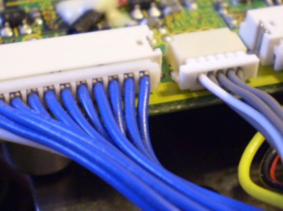

Are these the wires you may be talking about?
Yes I believe they do. I will take more pictures with the boards removed so you can see the lay out of the panasonic. I measured voltage on the connector on the right, to be exact the left most white wire. It had 3.5 volts with lamp out power on, and 120 volts with the lamp in and on. When I tried to unplug the connector to attach jumper the lamp shut off. I tried to unplug the blue wired connector and lamp got brighter then shut off.
The blue wires are the main power for the fans and the main board. The ballast is what connects to the lamp the ballast should have a power in connector then 3 4 or 5 wires going from the ballast to the main board. There should never be 120V in those wires.
Try unplugging the connector from the ballast then shove a small pin or staple into the connector end and with each wire touch that to a known ground spot like a screw head. Power the projector on if it stays on then thats your wire.....if not move to the next wire.
The ballast will not power on with that wire removed but the projector should stay on with no errors when you find the correct wire.
This is the ballast and these are the only small wires coming from it. These wires are the ones I will jumper to ground on a screw holding the main board down. No lamp in power up and should stay on with no errors.

It worked!!!! Look at post 4 above to see small connector from ballast to main board. The white wire was the correct wire. The unit stayed on with no errors. As soon as I pulled the jumper off the unit showed the error. Now I just need to re lamp it, and so far I only have 50.00 in it. What lamp have you used on your projectors?
