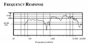

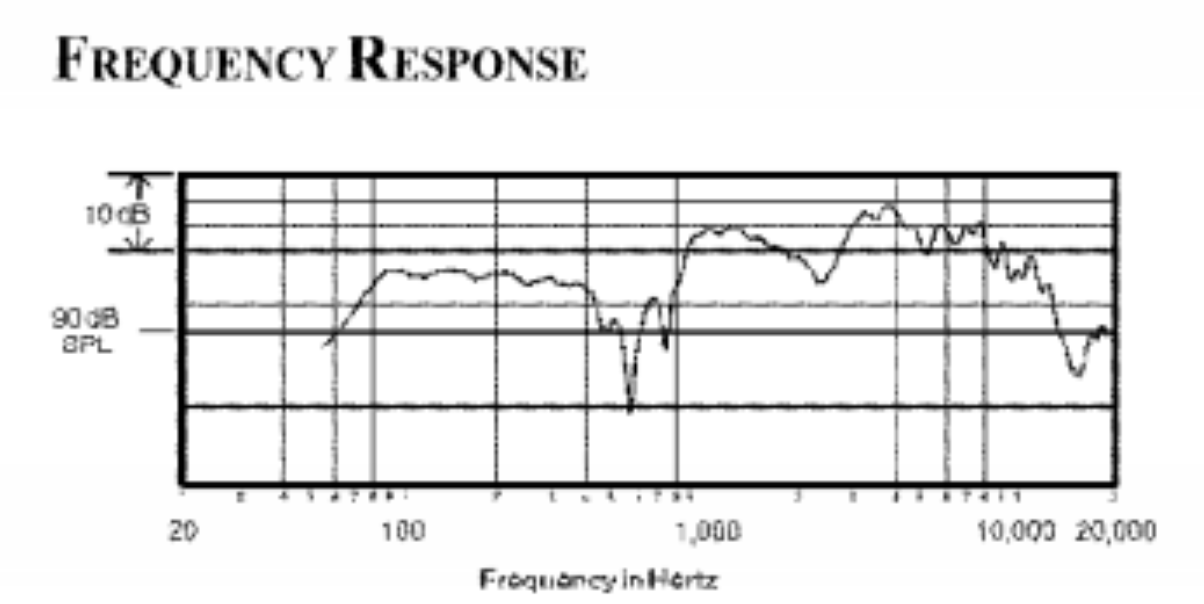

I had a look at the datasheet again. It is fairly obvious that the M200 midrange compression driver is the strongest, loudest and most valuable part of the system. One obvious clue is that four 12" woofers are required to keep up with it, and this begs the question, do they keep up at all? The grainy frequency plot in the datasheet shows that the M200 is substantially (about 6dB, maybe more) louder than the low end of the box. The box also has a "midrange boost" switch on the crossover, that can be engaged for extra midrange output and "vocal clarity".
personal guess/interpretation dislaimer
My hunch is that this is the natural sensitivity offset between the woofers and the midrange/HF section. Normally such kind of discrepancies are dealt with in the passive crossover by "padding" the HF output (using a voltage divider to lower the voltage sent to the midrange and HF section). I assume that the graph shows the basic frequency response of the box with "boost engaged", which basically means the pad of the mid/HF circuit switched off.
What is the conclusion from this? The original woofers are lacking in sensitivity.
end of personal interpretation
the conclusion from this is that when you operate your DIY box, you have to expect to have to set an according gain structure to significantly reign in your midrange, with anything between 6-12 dB or even more level reduction compared to your woofers.

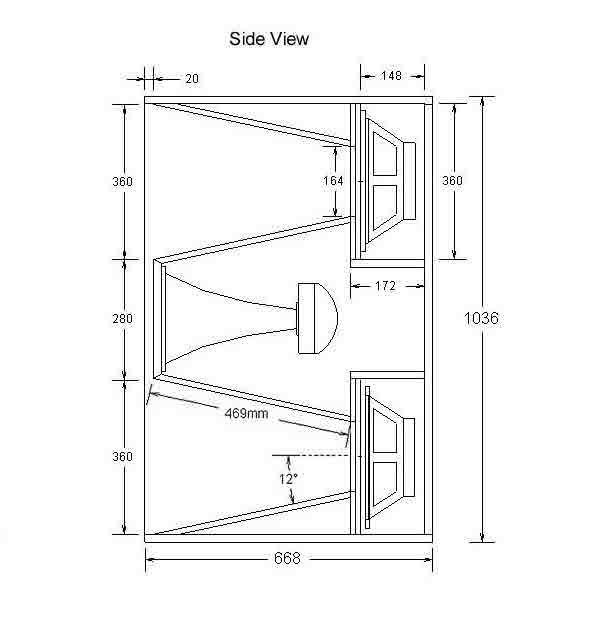

Getting back to the initially proposed two scenarios, I will try to make a couple of build suggestions for you for inspiration:

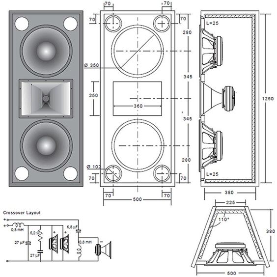

1a) Hornloaded box incorporating CSX mid/hi horn section mounted in the horn mouth, like for example in a Nexo TS2400 (see attached picture)
http://hornplans.free.fr/mkb230.html
pros: - If the community 12" woofers work well in the horn, you will have a much better level match between lowmid and mid/hf section.
cons: -big
1b) directly radiating box with one sensitive 10" or 12" woofer per box together with the CSX mid/HF section
pros: - small and light
cons: - less output
- cost of new woofers
2) DIY, for example a basic single or double 10"/1,4", or hornloaded PM90 if you are ambitious

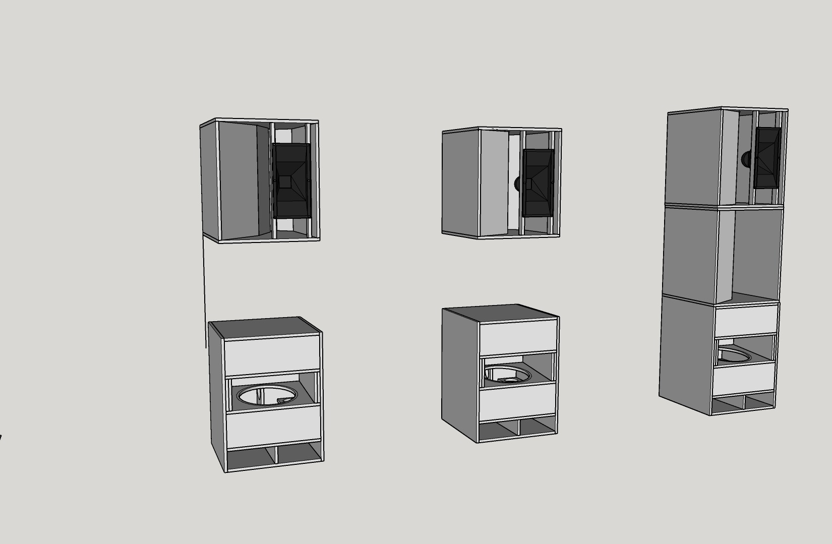

So my current thinking is to build
2 x Dual 12" hornloaded box with integral HF section (which HF remains TBC)
2 x 15" kickbin
OR
3 way mid/tops? 1 x 15", 1 x 12", HF
2 (second) x dual 15" ppsl sub
For now, I am going to research the dual hornloaded 12 designs you mentioned and maybe some others, and investigate my HF options.

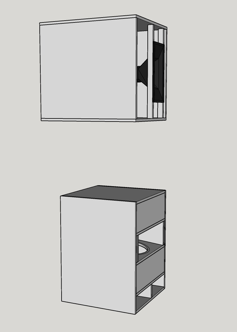

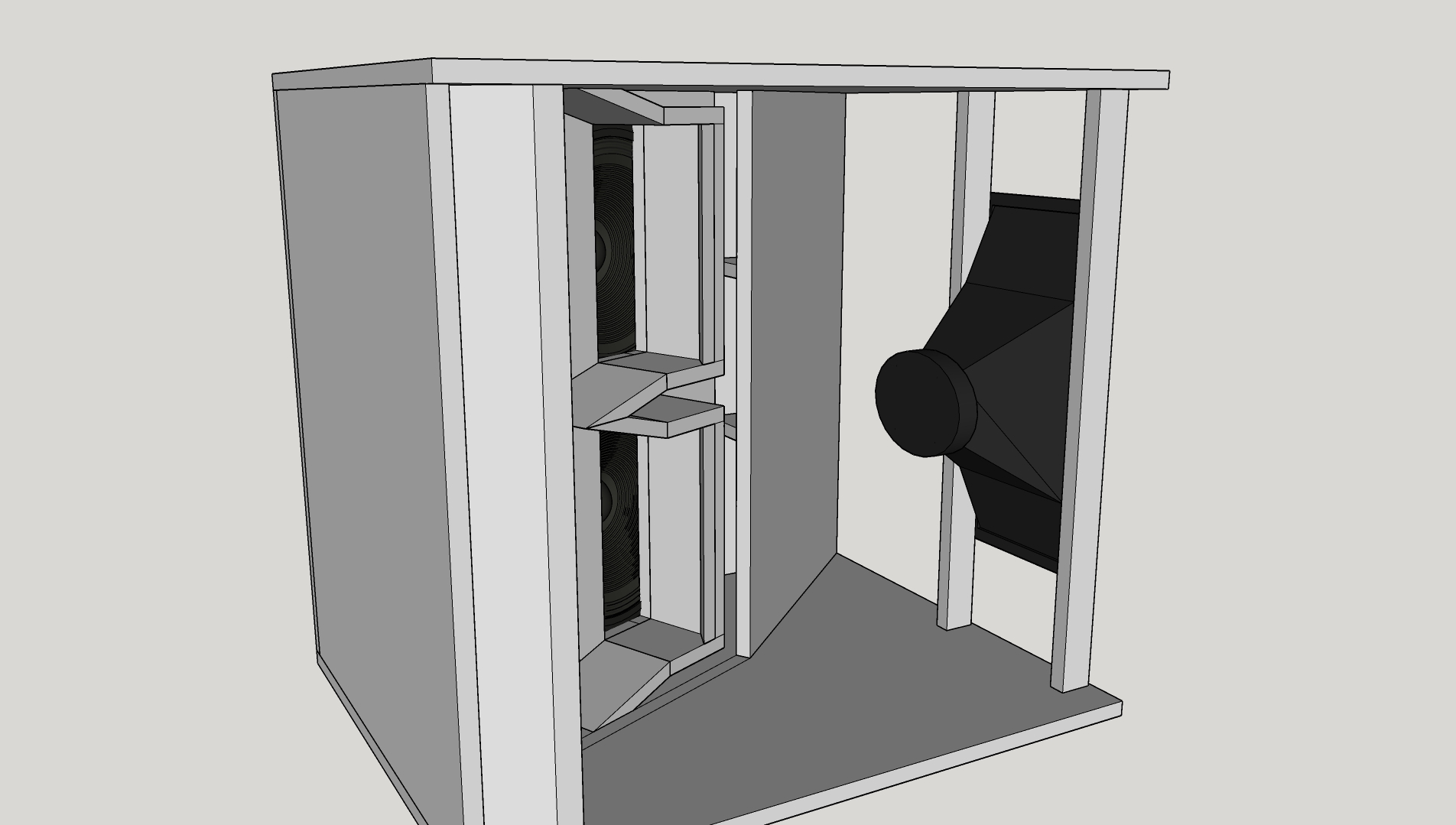

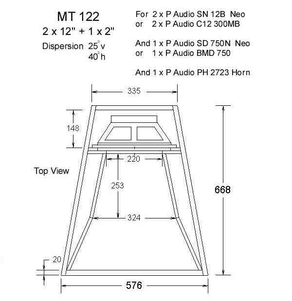

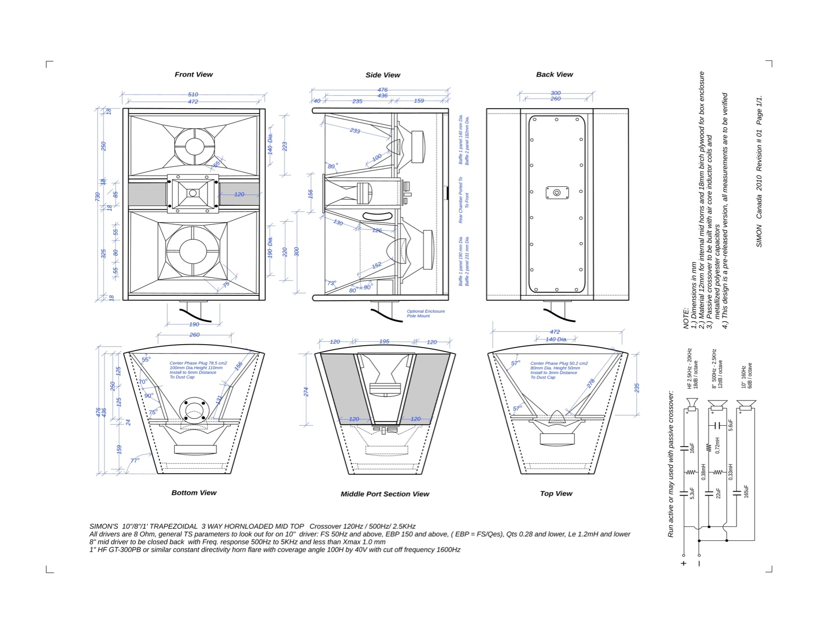

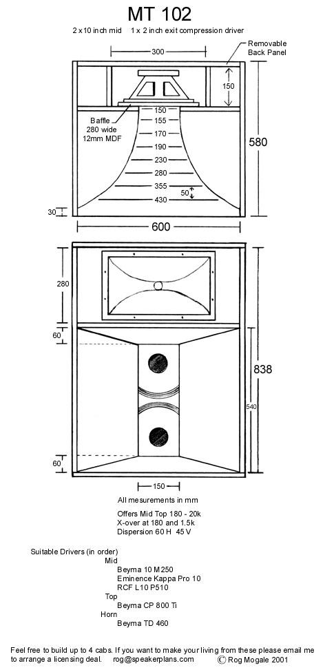

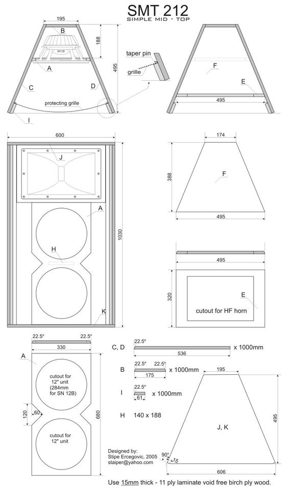

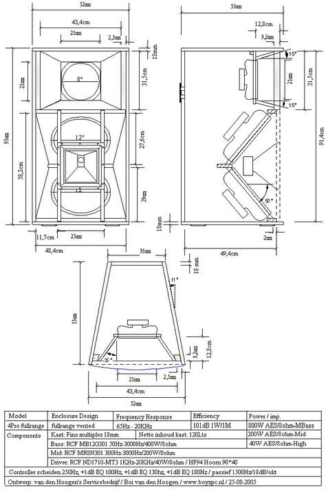

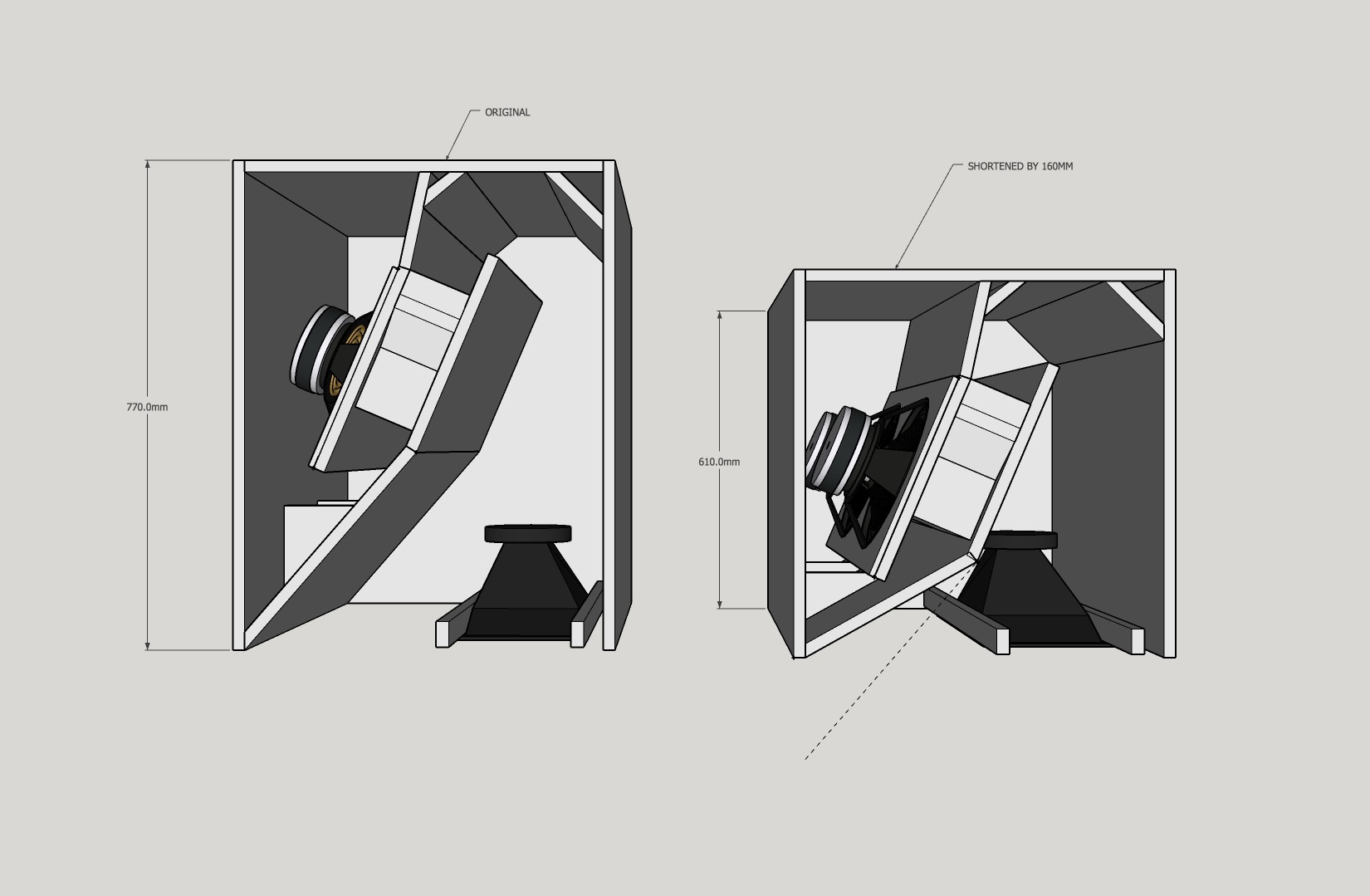

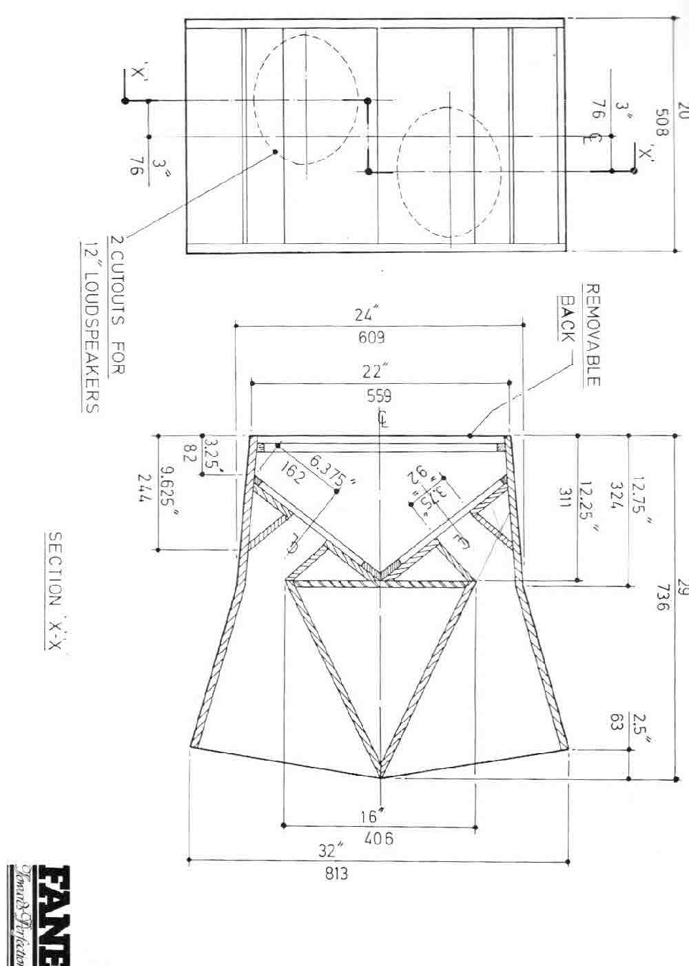

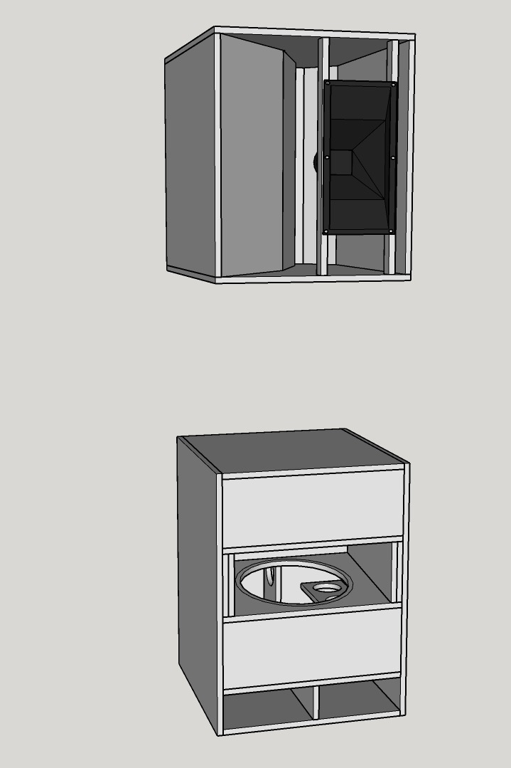

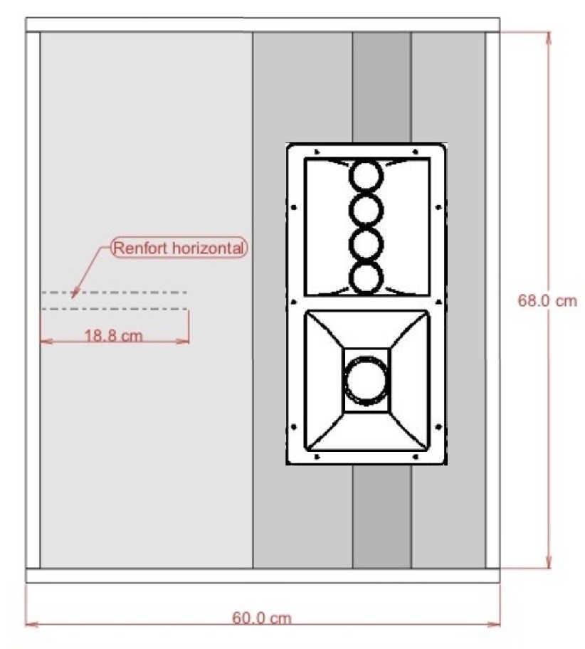

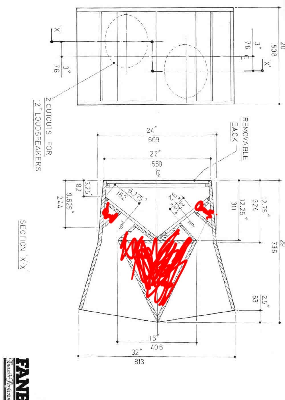

I am being offered a reasonable deal on some 4" darQ CDs with large flare horns and spare diaphragms, recommended 2.5k and above... seems high compared to M200s.
annoyingly i just made this post and lost it just at the last minute so here goes again-
I have found a bunch of cab designs that are probably varying degrees of inappropriate, but interesting for one reason or another. I suppose the fact that I will not be using the recommended drivers means they will give varying and unpredictable results. However, if i use a certain design, I can always upgrade the drivers to those recommended, should I ever be inclined.
Ill put them all out there for comparison.
There is the design you proposed, with front mounted HF section somehow... would fit nicely on my subs (which are 600 x 600)
or i wonder whether the HF could just get their own box/housing to sit on top?
Or I am wondering if i could adapt this design for 12"s, and whether that type of horn design will give the 12"s any extra oomph to keep up with M200.
With spare 12"s left over could make a pair of these as kick bins, which could fill the low mid Xover gap between the subs and mid tops.
other mad designs that may or may not be adaptable -
doing this sort of thing but with a 15 and a 12 instead is appealing but have no idea how that would work
these sorts of 212 dont really appeal, too tall and thin
another mid top option
Lastly - perhaps a design like this, but adapted and/or without the 8" section at the top. However, probably inappropriate and not visually my bag.
Anyway all opinions welcome, just chucking things out there really, as usual, without much expert understanding.
Currently I feel most good about the MT102 on top of some fane design kickbins i think.
Sorry i know it looks like im dragging up every 2x12 cab design from the entire planet, but these selenium designs are comprehensive and appealing
2 x 12 + HF http://wizardaudio.hu/hasznos/hangfal tervek/top/horn/pdf/Selenium PAS3MA1.pdf
2 x 12 + HF http://wizardaudio.hu/hasznos/hangfal tervek/top/horn/pdf/Selenium PAS4MA1.pdf
3 way, 15, 12 + HF http://wizardaudio.hu/hasznos/hangfal tervek/top/horn/pdf/Selenium PAS3MA2.pdf

All of the front loaded straight horn tops (smt, mt102,mt212, selenium designs) dont load below 200Hz.
The Fane 2x12" kick bin is unneccesarily large, awkwardly shaped with lots of unused dead space and wasted wood (marked red in the plan).
Overall, just comparing the designs, I would vote strongly for the mkb230.
Because it is folded, it has a longer horn path and goes down to 100Hz. So there you have your kick. It also goes up to 700 Hz, and could be crossed over straight into your m200 or another compression driver.
See my crude illustration (n.b: scaling approximated, not verified!!!) of coaxial mounting of your mid/hf section in the mouth of the mkb230.
You would still have the option to relegate the mkb to kick duty and pursue other mid/high options later on if you desire.

Sorry yes i should have dumped all those designs elsewhere and had a proper look at each first. I drew the fane on sketchup and put it on top of my subwoofer, it was very obviously not the thing!
Done a bit of sketching of the MKBs, think i have them modelled correctly. Sub thrown in for thinking about stacking...
There would be room for something between them in the stack (to get the horns up to about head height...) if that was appropriate - another one?! or something with one of the spare pair of 15"s)
Otherwise id devise a stand. I also like that it will be possible to change both horn and 12" drivers in future, quite futureproof.
Only current minor issue is that they are deeper than my subs! I suppose shortening the horn messes with the output, i roughly modelled the modified version (on right), shortens the horn by 160mm - obviously i would adust the angles to keep them gentler, but id be curios what effect this has.
The overhang isnt the end of the world but would cool if they lined up
Or I have to build another sub anyway so i could modify them instead and build both.
one more from the inside... to make sure im not getting it wrong...
phew bed time

Sorry forgot about your project, was busy with covid 😬
Unfortunately changing the box design will significantly alter the performance, making it a very different box altogether.
Consider the horn fold, any shortening of the box will result in twice as much shortening of the horn path. The lower cutoff will be shifted significantly higher.
