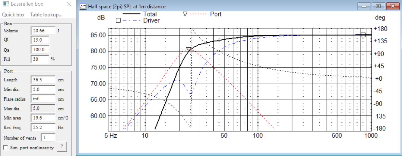

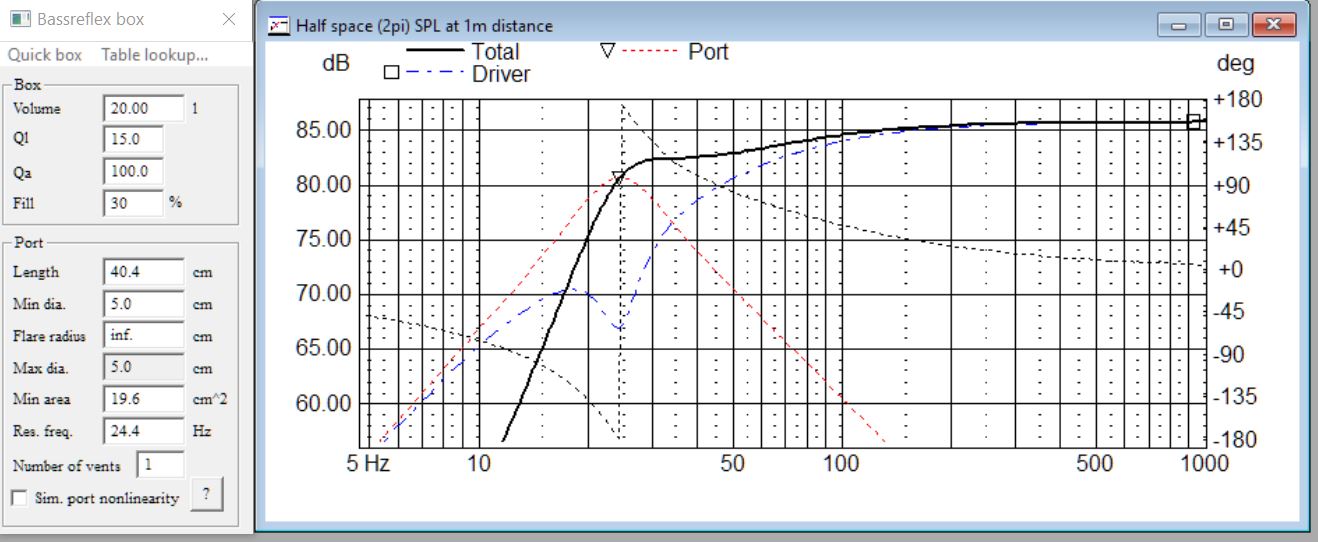

A quick calc using this HiFi Loudspeaker Design
ER18RNX, 18.24l, f3 47hz, port 5cm diam 12.8cm long
18W/8531, 46.5l, f3 31hz, port 5cm diam 10.36cm long
18W/8531, 20l, f3 48hz, port 5cm diam 15.3cm long
In 20l I have modelled the Dayton ES180TiA and this shows -
ES180TiA, 20l, f3 34hz, port 5cm diam, 21.7cm long.
You can use this calculator to give you a quick check then model with full response modellers.

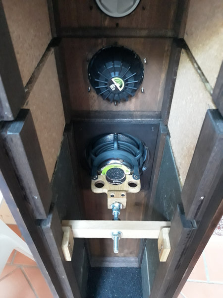

One tip is to have the port tube easily accessible so you can change the length. Theory doesn't always work 'in room' and you may need some fine tuning.
My SEAS L18 three way is 85cm x 20cm x 22cm and the port (5cm) ended up being 23cm to give the flattest bass response in room. This was a considerable increase in what I had calculated. The port is located in the bottom of the cabinet.

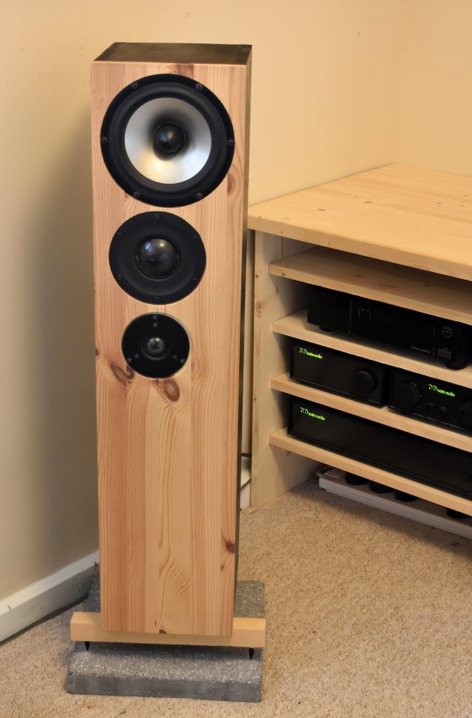

I use these drivers with a Scanspeak R2904/7000000 tweeter and active xo miniDSP in similar size cabinets.

My design uses the EM1308. I also have the RS52ANs. After doing many listening comparisons the 52s are back in their box and that's where they will remain![]()
Was there much in it between the 52's and the 1308's in the end?
Yes. The EM1308 had a far more natural tonal quality. Especially noticable on acoustic guitar where the 52s never lost a 'steely', 'hollow' quality, whereas the EM1308 had some of the most life-like reproduction I've heard.
The 52s can be detailed and dynamic but ultimately imparted their own sonic signature to everything.

I'd optimise it something like this...

They optimise into giving you a pretty standard EBS alignment.
With both the TB and the Reckhorn you can go with smaller cabinets and more 'maximally flat' alignements. These give you less extension but no 'premature' roll off towards the mid 20s on the Hz scale. So you pick how you want to tune your cabinet and build it with regards to size.
