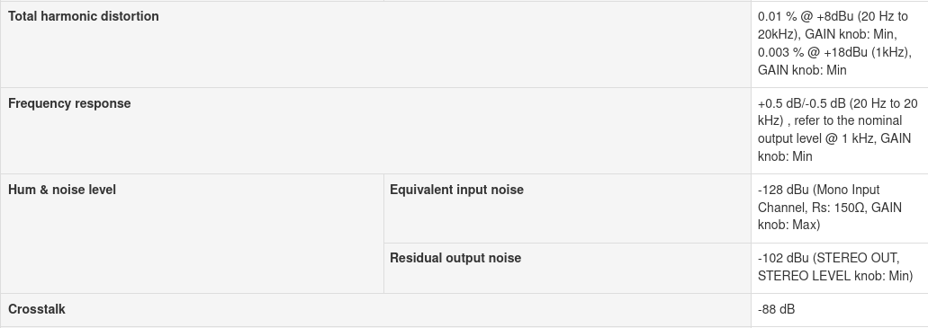

Yamaha MG06 has better sound quality if you just want level control:
very hard to compare the spec with the Behringer spec but I know in practice this mixer is much lower noise than the equivlent Behringer noise as I heard a system where a swap was made to reduce annoying background hiss to inaudible levels.
