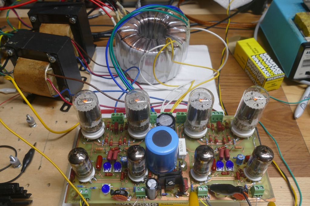

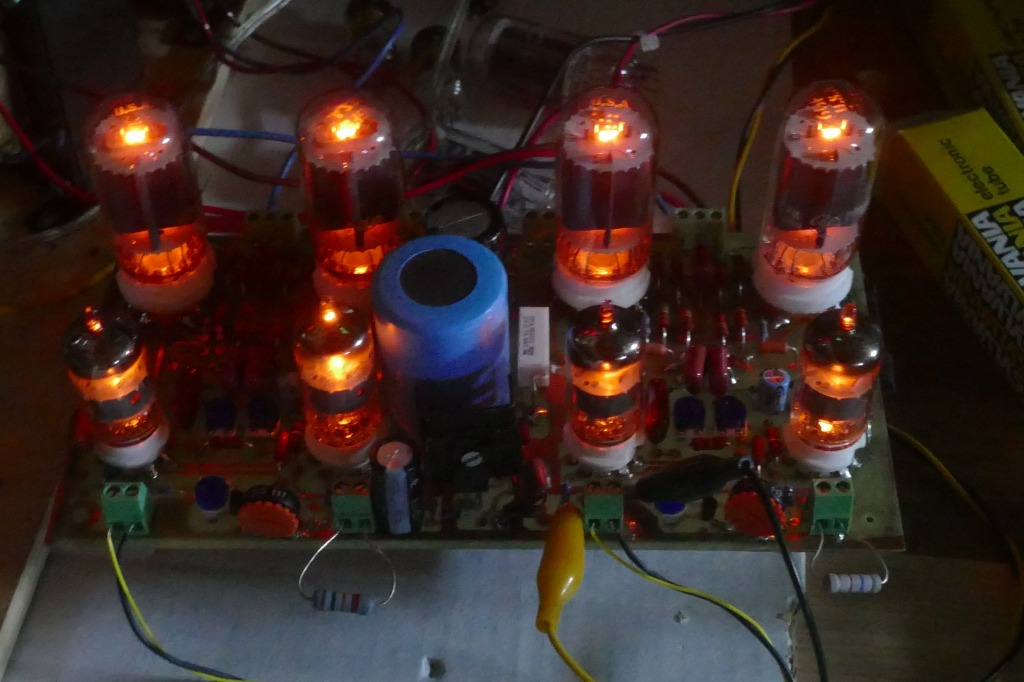

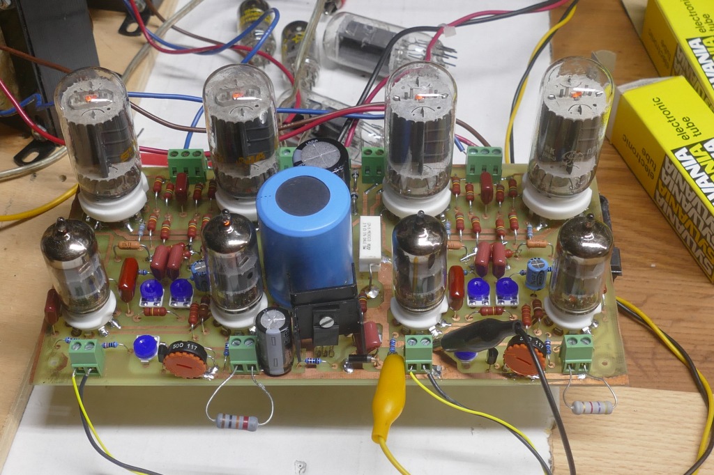

Maybe a 6GB5? If so, they can make over 100 watts per pair when squeezed hard enough. I was looking to make a cheap 100 WPC HiFi amp board with 13GB5's when they were on the dollar menu some time ago. About the time I had the board ready one person (or corporate entity) bought up ALL the readily available stock of 13GB5's in the US, over 20,000 tubes. Stan (ESRC) wouldn't tell me who, but he said it was a US buyer who got about 9,000 of them from him. Without a large supply of cheap tubes my amp design became yet another dead project.

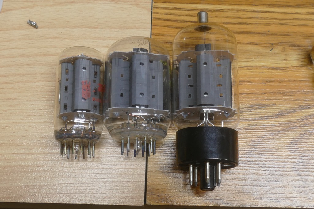

The 13GB5 amp did get reborn several years later with another even smaller $1 Compactron tube. This amp only makes 80 WPC on a regulated power supply or 50 WPC on an Antek toroid. These three tubes all have the same guts. The tube on the right is one that I experimented with a lot in my youth as they were commonly found in dead 1950's vintage TV sets. The center tube is the same thing in a Compactron bottle. The tube on the left is the same thing again with it's plate wings clipped a bit so it will fit in a tiny (smaller than a 6V6GT) Compactron bottle. It is seen in the pictures cranking out 80 WPC without anything glowing inside. The older octal version will easily do 100+ WPC. Stan had about 2000 of these little tubes when he passed, but nobody seems to know where all of his 4 million tubes went. Rumor has it that his Orlando warehouse is now empty, but I have not seen any real evidence of that, like say a picture through the front window.
6BG6, 6GB5 - could have gone either way. But I ventured a guess it’s was the former, since it’s closer to what you would “normally” use for a guitar amp. $8 vs $5 at vacuumtubes.net, but that socket will cost you $3 more so it’s a wash there. The economy might have been different when tubes could be had for a buck, and when magnoval and novar sockets were as common as dirt. Neither is true anymore. Trying to make watts, the GB5 is better - more heater power = more mA of plate current for a given screen dissipation. Your pic shows a novar base, data sheet says magnoval. Which is it - really?
