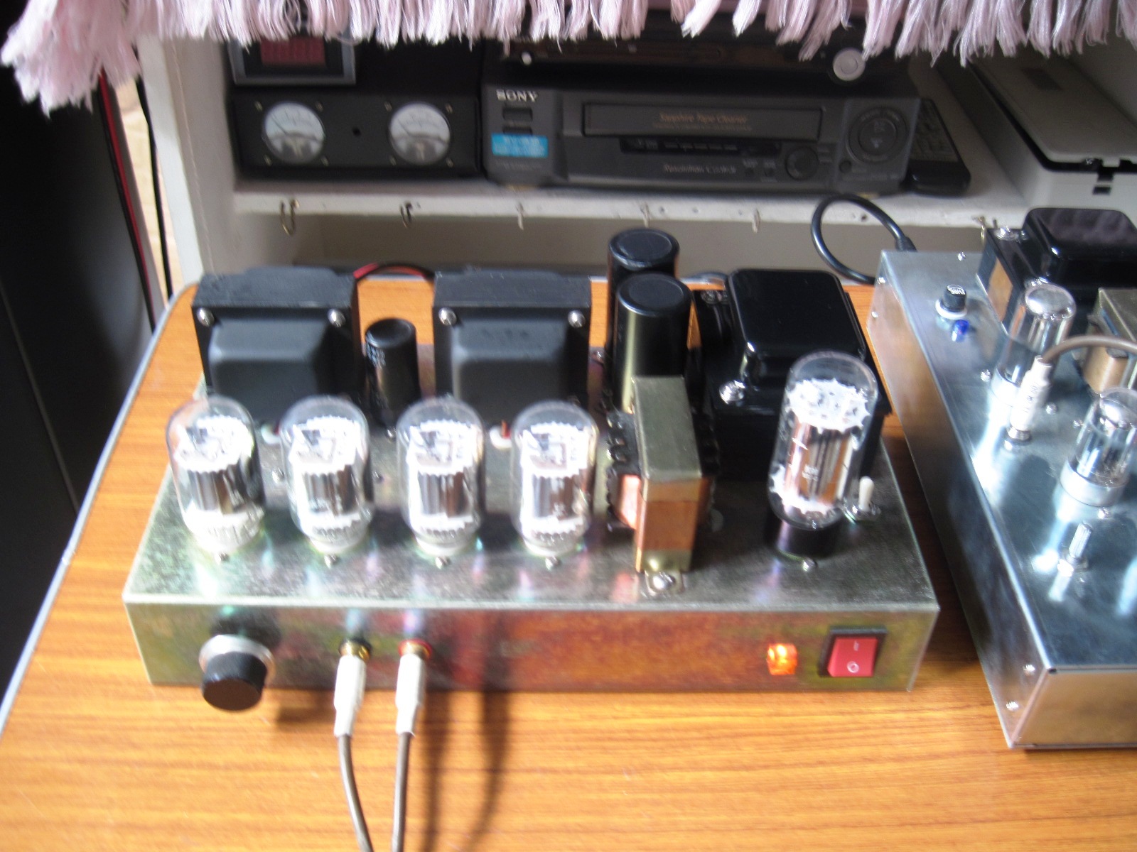

i purchased lots of 6BH11 when they were U$1 each at Rogalskies....
one compactron tube to implement a Mullard 5-20 or even a Radford 120...
Compactrons are wonderful!

for phono preamps, the 6C10, 6AC10, 6D10 are triple high mu triodes that can be used, the third triode can be used as cathode followers...
the 6BN11, a dual pentode can be configured a triode, imagination is key..

like all low power tubes like the 12ax7's, compactrons used that way can live forever, well almost...
btw, the 45's i see today, i can not differentiate between 2a3 nor 300b, they all look the same, same heights.... 😀
