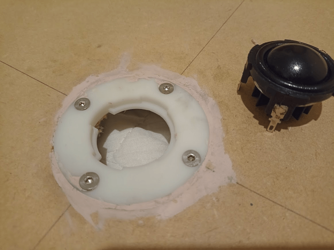

well a radius is a waveguide it will still have an impact at greater than a few kHz. Here is a waveguide I designed for >3kHz, its very shallow: https://www.diyaudio.com/community/...ture-tweeter-array.388439/page-3#post-7300287
I recently used JLPCB for some small 3D prints at very low cost with exccelent quality so perhaps using a 3D printing service you could make a more sophisticated small waveguide?
what material you choose?

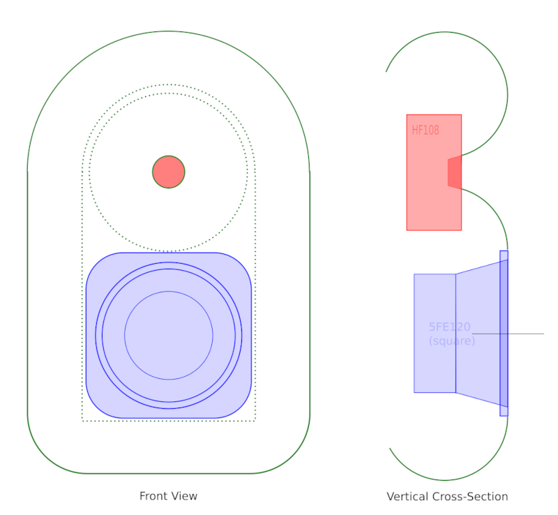

Thinking things through a bit more, turning a round doughnut into more of a juke-box shape will allow a nice little 2-way. Something like the following:
Just showing the outline of the front of the baffle (in green). I've not yet thought about the inside, or shape of the back of the cabinet.
I found a mention by Linkwitz that round-overs start to become effective when their radius is about 1/8th of the wavelength. These are about 1.5" or 38mm radius, which should mean they start being effective by about 1100hz. Dr Geddes feels that the region about 1khz or lower is better for compromises than above it, so I'm happy enough with 1.1khz. They make an overall cabinet width of about 215mm or 8.5" which seems about right to me, for a desktop speaker.
Driver spacing here is about 125mm or 5" centre-to-centre. That would be within a quarter of a wavelength if crossed around 700hz. Likely I'll cross a bit higher but it shows that things are at least reasonable. Here I've used an example of a 5FE120 for the woofer; it is about the right size and shape, has a narrow frame/bezel and will do okay in a small sealed enclosure. I could go for a smaller woofer, as this speaker is intended for use with subwoofers, but actually smaller doesn't gain very much and I'm interested in it having sufficient dynamics and impact.
So I'll need to do a lot of testing first (no idea how a compression driver will work low in a doughnut) but that is the rough concept, at the moment.

Donut, circuilar profile on the waveguide, works fine, although it beams some. You can optimize bit further if you wish, see the ath4 thread.
If you put the woofer behind the waveguide and use just small hole for it's exit (acoustic low pass filter), it would be close to Multiple Entry Horn -concept.
Definitely use roundovers on the high and mid transducers, to reduce effects of edge diffraction on listening window.
Reactions: Kev06
It is interesting to hear your thoughts, thanks. I had wondered about making it somewhat like a small MEH (albeit without an actual horn) or maybe like a Cabasse spherical affair, but it seemed to be getting over-exotic. However, maybe not; it would only be an oddly shaped bandpass enclosure, so could still be modelled easily enough at a basic level.
I'd not gone down the waveguide route because a proper effective one would be huge, and I don't particularly need to restrict the directivity in any case. However if my anti-diffraction doughnut would actually cause more beaming then it is something I'll need to look into, thanks again. Looks like 'another' thing I'm going to have to learn about!
