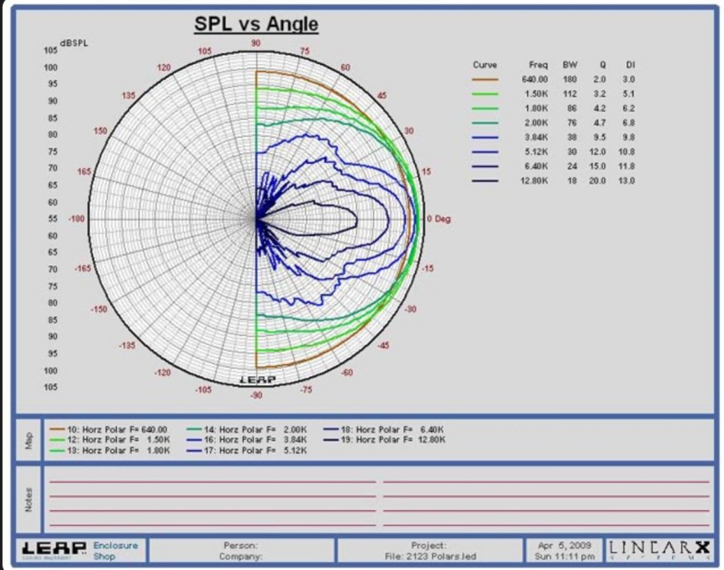

The interface of driver and horn by far make the most significant difference in character of sound.
I personally really like the NSD1095N on smaller horns with a higher xover. The treble (once leveled and contoured to suit the neighboring driver) has the most neutral and analytical quality, very close to a good dome tweeter. The plastic diaphragm drivers sound more veiled and become very glazed over sounding at high SPLs, but they're far more forgiving to less careful EQing.
If you listen to brass instruments alot and want the immediacy in dynamics with the harmonics and less veiled top end, a well designed metal diaphragm driver on a decent horn will sound more accurate, but it depends on how severe its breakup mode is. The breakup mode can really ruin the sound, especially at high volume levels. Suppressing it makes a huge difference as does whether the breakup mode falls in the audible spectrum. Even if BU is inaudible by itself, it can down modulate into the lower frequencies, increasing IMD.
Phase plugs also can perform differently on various horns. Its not only the driver exit angle which can be incompatible but also the phase plug design with the geometry of the horn throat. Impedance reflections inside the horn can severely ruin the clarity and raise distortion levels. Some drivers rely on high Q lower end rolloff slopes to enhance performance at lower cutoff. These can sound mouthy and shouty when the driver HP is pushed closer to the horn's lower unloading point, especially when the diaphragm loses control due to insufficient loading / reactance. EQing will help this but it won't totally get rid of it.

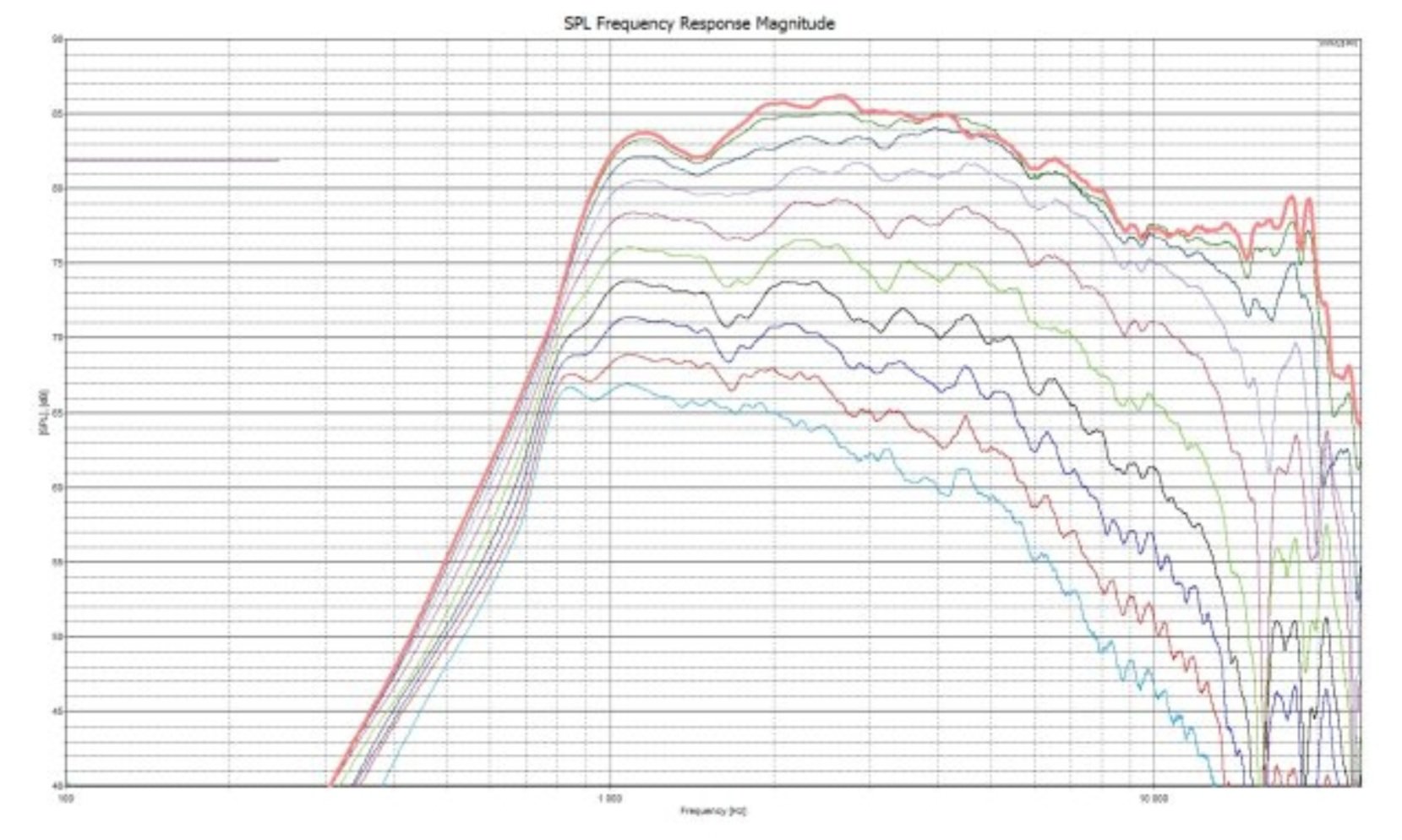

A poor choice of horn + driver combination is one of the primary causes of odd order HD IMO. High compression ratios coupled with excessive SPL, without notching/EQing out the breakup range frequencies, will also generate high levels of odd order HD across the entire midrange frequencies.
Excess HF diaphragm breakup feeds into this with resulting IMD being down-modulated. It can become extreme, producing various combinations of undefined multi mode distortion, essentially resulting in the generation of noise, which is no longer harmonically associated with the music being reproduced. We used to call this phenomenon "diaphragm scream" back in my PA sound days.
The various trigger levels for these severe modes of breakup to occur aren't linear or gradual and therefor can't be easily EQed or notched out.
Larger diaphragms do better, playing cleaner at higher SPLs, but these can produce some of the harshest breakup modes, especially in the audible range.
The larger available diaphragm surface area enables a wider range of breakup modes, which can add together higher in amplitude and be triggered more abruptly than those of smaller diaphragms.
The biggest variable in generating uncontrolled severe midrange breakup are the combinations of modes occurring at the same time at very close frequencies ie. multiple modes of phase/time shifted breakup taking place in different areas of the diaphragm. This is all of the available diaphragm surface area going out of control simultaneously in unsynchronised, unrelated fashion. You can have radial, axial and tangential modes all at once without any harmonic relationship if the diaphragm is large enough. It can be so severe that the diaphragm ruptures or fractures, especially undampened aluminum or beryllium diaphragms. Titanium is very tough and doesn't usually fail mechanically, even when the diaphragm bottoms out hard on the phase plug.
