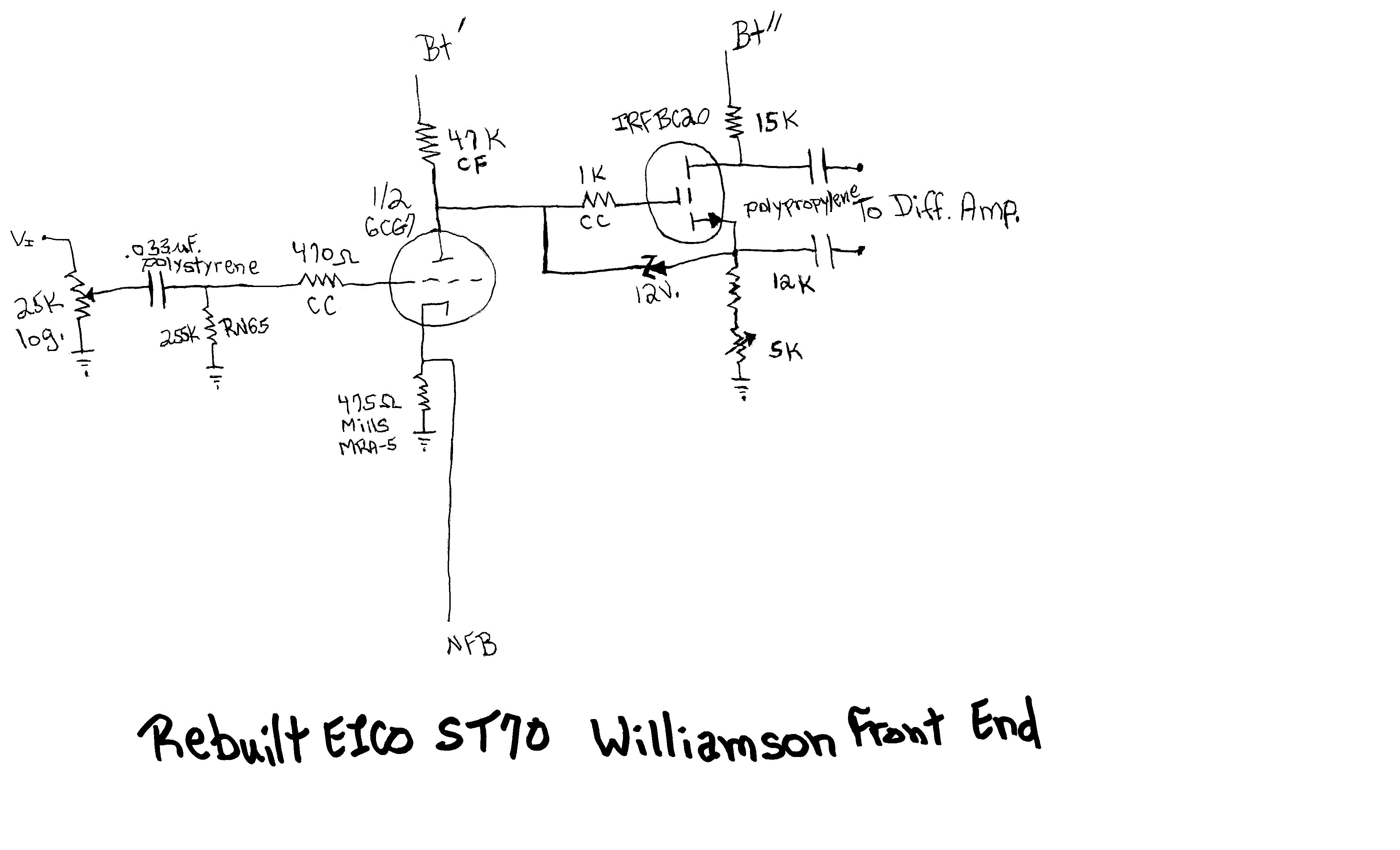

FWIW, Mike Samra and I have been and continue to work on a radical rebuild of an EICO ST70. The plan includes conversion to Williamson style circuitry and there is 1 Noval and 2 Octal sockets available for small signal purposes, which is not enough for "textbook" Williamson. Hefty power MOSFETs serve in the "concertina" phase splitter role.

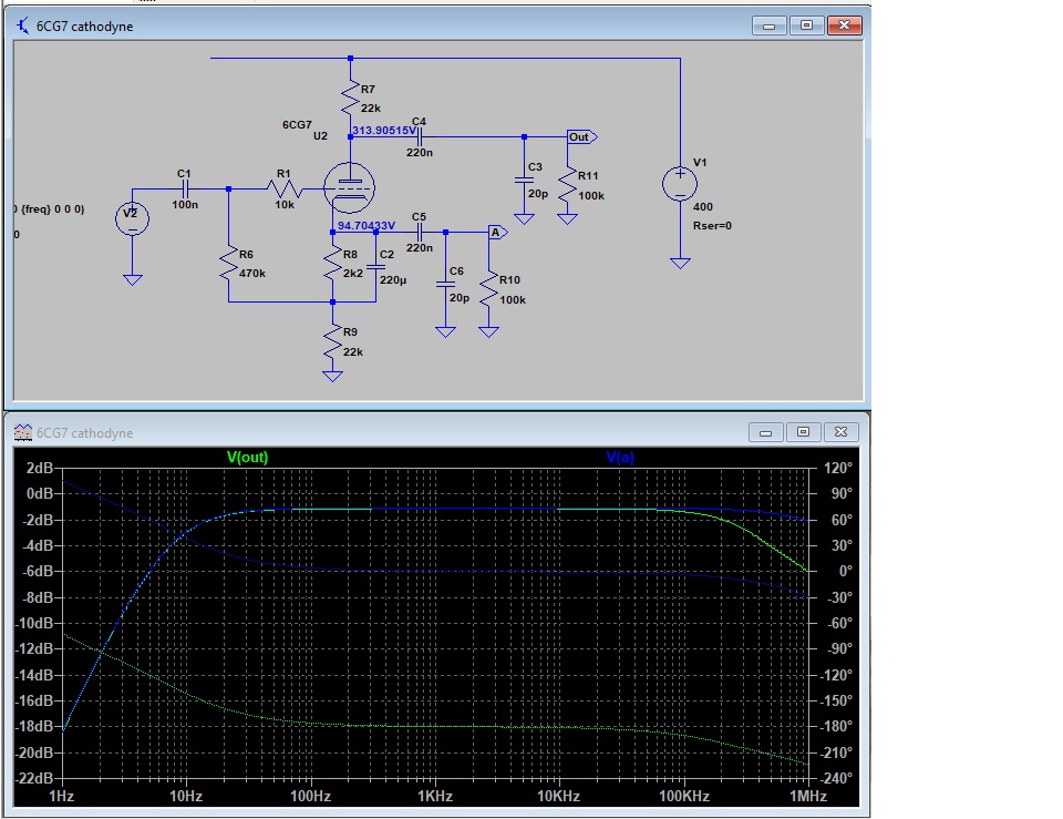

The frequency response of the outputs are not identical due to G-S capacitance.
If the load impedance is equal at the outputs, then the response is equal (within audio frequency range).
Broskie has info about the split load phase splitter (concertina) and Zo.
Dump those 9 pin sockets and install some 12 pin sockets.

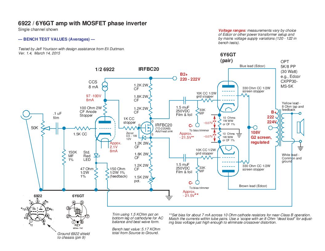

Only a single 9 pin socket and a change is NOT happening. Experience working with Jeff Yourison on his 6Y6 project shows the FET split load to be excellent. Volts were in really short supply and a triode's inability to swing close to the B+ rail would have ended in a failed project. Tom Bavis stepped in and helped get things squared away. Even with a FET's ability to swing close to the B+ rail, Jeff was initially experiencing some clipping.
As alluded, it has insignificant affect on frequency response or distortion if used appropriately. The Williamson amp followed it with a balanced driver stage before the output stage, which avoided issues related to large signals and non-ideal loading that often show up in other amps.
As with all use of MOSFET's, especially where there is a large difference in drain voltage, cascode them so the input capacitance does not change.
