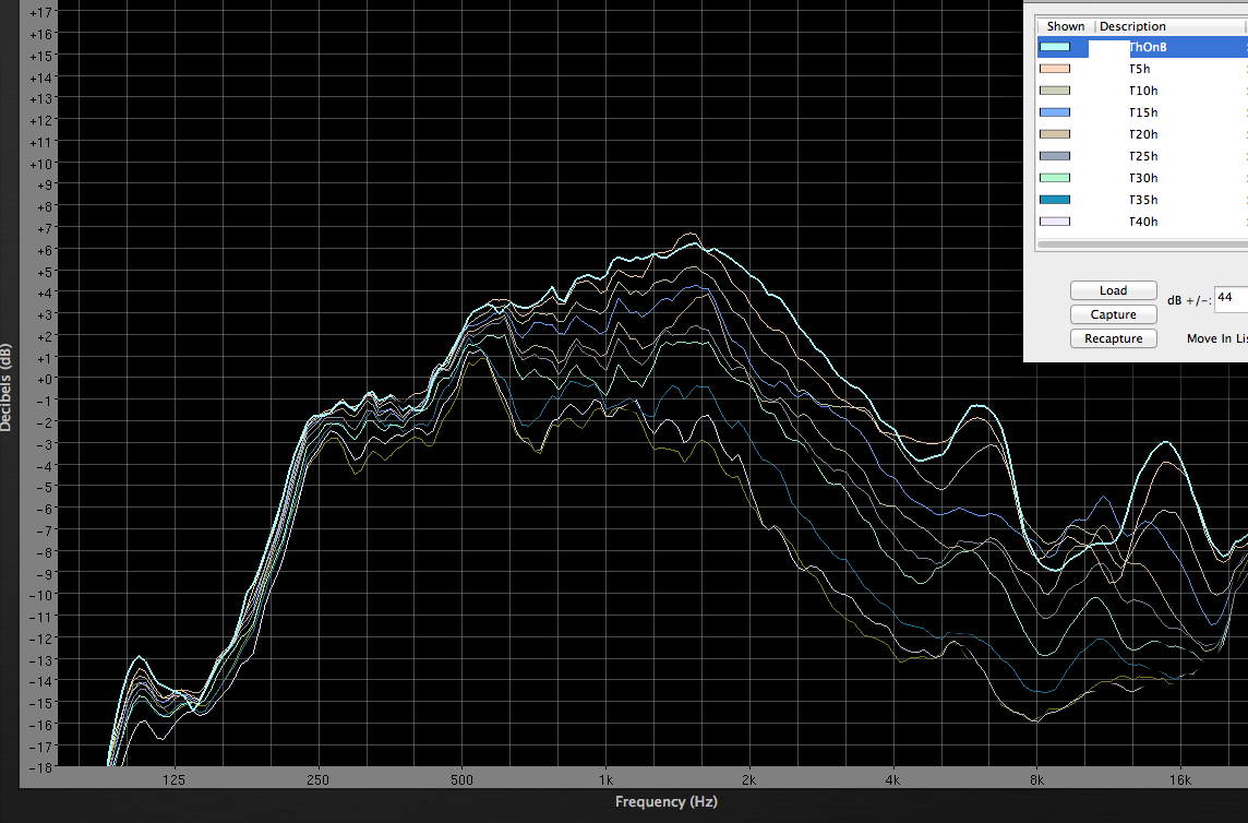

The horizontal polar response of a TC9 on a 45 x 30 two part conical horn below is with no EQ applied, less than 6 dB of correction would be required to flatten it from 250 to 16kHz. The curves are at 5 degree increments, note the constant directivity with frequency- the horn sounds the same over it's intended coverage pattern.
The prototype horn was constructed in less than an hour from cardboard and tape (a plastic jug for the back chamber, I'd expect even better results with more attention to detail.
More details in post #860 here:
http://www.diyaudio.com/forums/multi-way/285030-bookshelf-multi-way-point-source-horn-86.html
Art

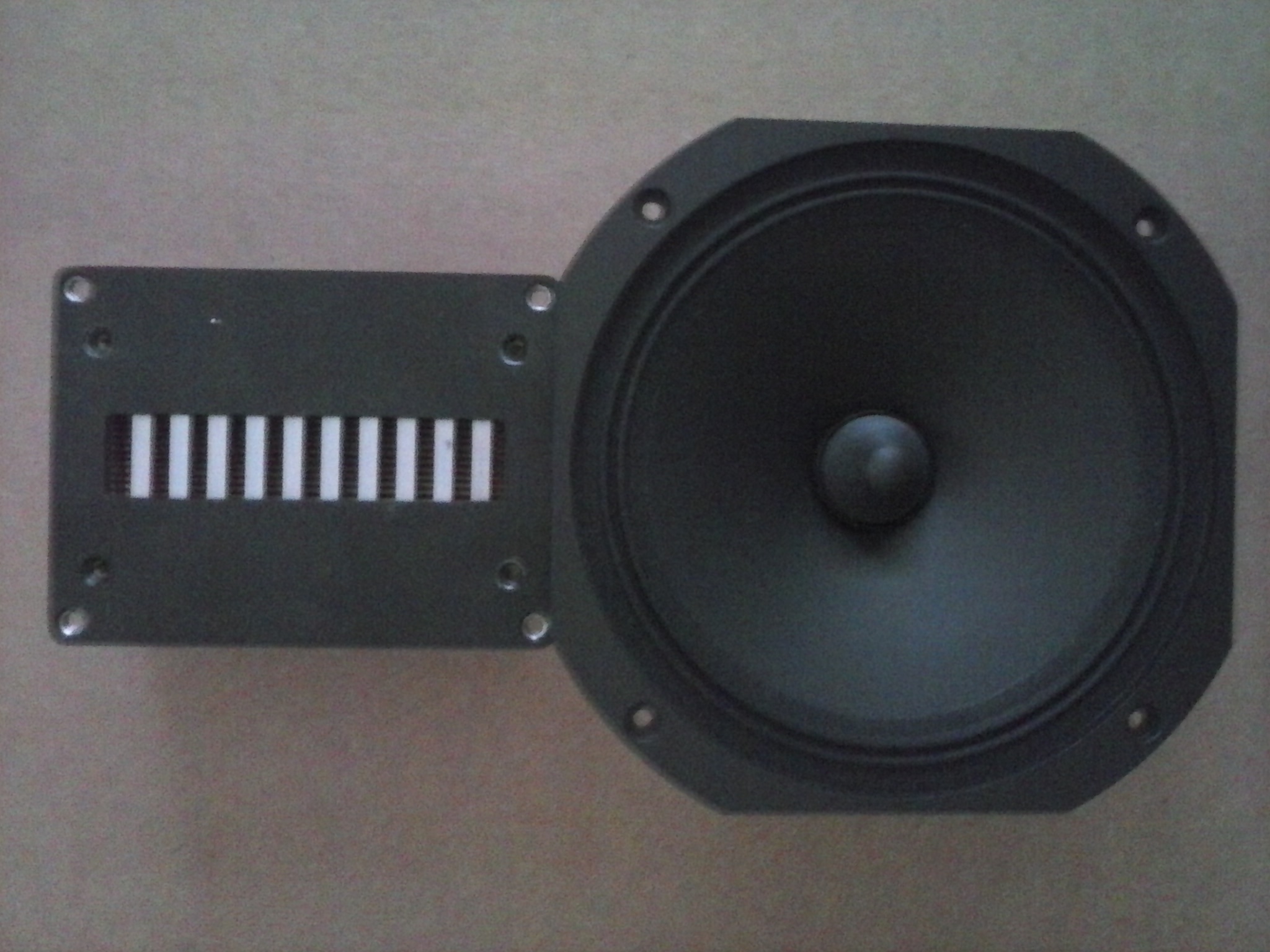

I also have been searching for a high efficiency midrange to pair with TPL-150, and will try this before diving into midrange horn territory (or not when it turns out to work well enough):
This combination will have some 97 dB efficiency from 300 Hz upwards, and crossover to the TPL-150 will be around 1900 Hz to prevent the midrange from beaming.
Very short waveguide for the TPL-150 for vertical alignment with the midrange.
Sorry for the 90 degrees rotation.
