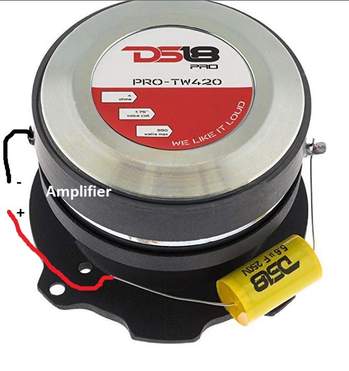

Hi There! I have a tweeter and I want to connect it to the amplifier of my computer. Those are the specific for my speaker: DS18 PRO-TW420 Aluminum Super Bullet Tweeter 1.75-Inch 550W Max/275W Rms with Built In Mylar Capacitor Filter (1 Speaker)
I am aware that this is a basic question, but I am a bit confused cause I don't see any wire coming out of the speaker to connect it to the output of my amplifier.
If it is anything like this then you wire the free end of the cap to the amplifier + output and the other tag to the - or ground. (and actually the polarity doesn't really matter for what you describe).

275wrms tweeter, from a PC unlikely to output 2w.
Perhaps at such low power, the 1.75" tweeter wouldn't mind a quick look at the amp, but just to see if it's working. No HF filter (capacitor) required. Though brushing a 9v battery is equally as useful. It's not going to pop easily. Though it's not meant to bounce about to bass. Ive seen compression horn drivers of around that size run full range at low power before. Didn't even sound that bad, for what is was

The basic problem is that computer outputs are low level, as stated before. They can drive headphones well enough but not speakers. Speakers are too heavy a load for most computer audio outputs.
That said, you could try it. Be sure you have a capacitor in series with the tweeter. Although the computer's output isn't likely to be strong enough to damage the tweeter with white noise, why risk it? White noise contains all frequencies, and you want to keep the low frequencies out of the tweeter.
What you really need is a little desktop amplifier to drive that tweeter. to 105dB And the capacitor in series to protect it from the low frequencies.
