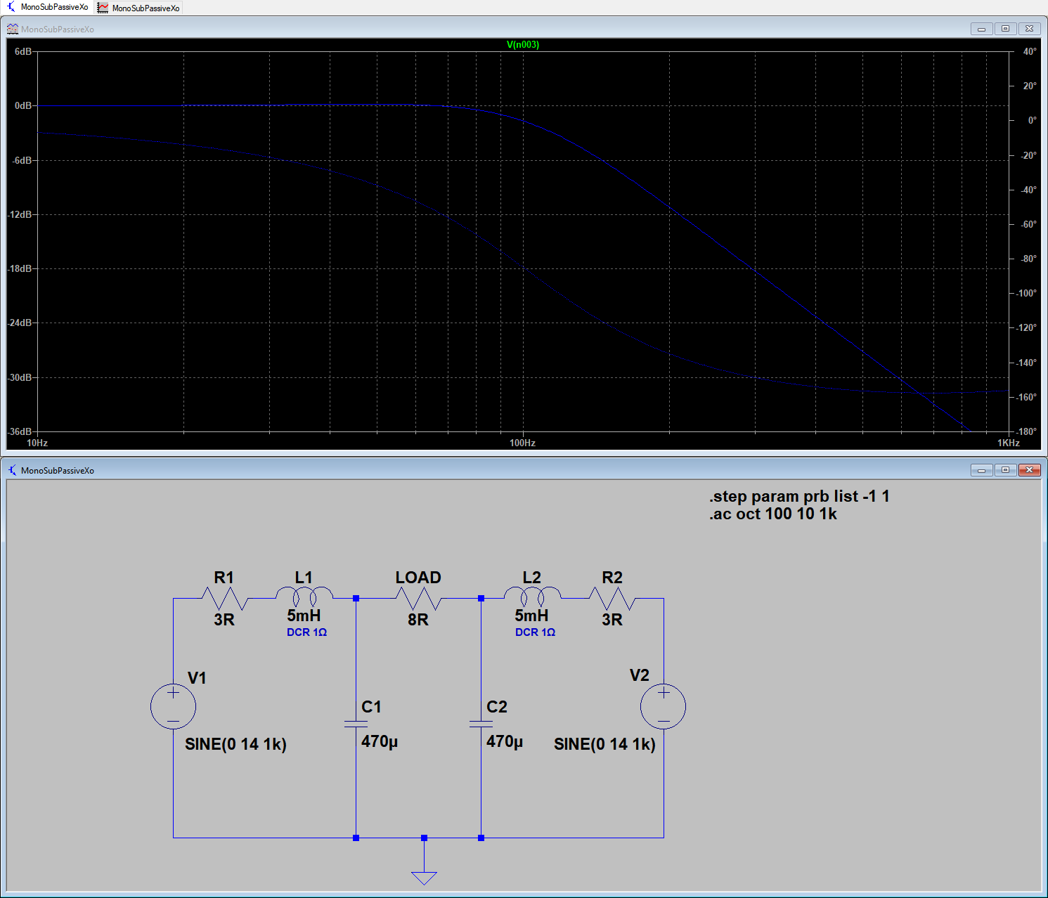

Theoretically you can with measures, the 8Ω load between + + channel outputs appearing bridged acting like 4Ω per side. Hugely inefficient to filter passively as it will also take 4Ω source impedance per side not to severely peak the bass response at one frequency and also avoid amp overload. Damping factor consequently goes south to only 1 and there is as much dissipation in the sum sources impedance as in the woofer itself.
Takes two low pass networks one for each side (channel) with the parasitic R in coils plus series high power resistors equaling 4Ω per side. The woofer's sensitivity must also be 3dB/W higher than the main speakers. Dual voice coil woofers avoid the bridge method and extra summation resistances / losses. Even then the high mH value passive crossover coils are still costly and the total filter inflexible.

Budget and preference for plate amp models aside, L-Pad signal dividers can be included in RCA barrels to convert high level speaker output signals to line level when there is no extra preamp output. Two 1/4W resistors fit. 1kΩ series to 100Ω parallel for instance can divide by ten times or 20dB.
