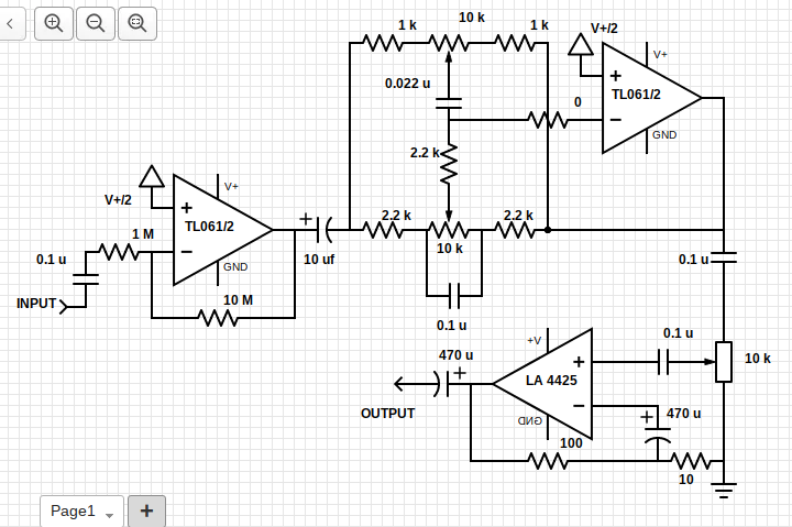

Any experience with LM3886 chips? I've an issue with my practice amp. And I've practically no electronics experience. So if I go with a chip amp, I'll need a preamp stage anyhow? Is that correct?
Yes. Any number of booster/preamp pedals could be used. Or a TL071 in non inverting mode, with a simple
If you've no experience, start with a known good design, like a Ruby and then start fiddling (e.g. adding a tone control, like the tone mender)
Or build Hitswares "Move over" which gets you most of the way there for less effort
Not sure what you exactly mean by that?Any experience with LM3886 chips? I've an issue with my practice amp. And I've practically no electronics experience. So if I go with a chip amp, I'll need a preamp stage anyhow? Is that correct?
Do you want to build an LM3886 based amplifier?
If so, fine, welcome to the hobby
To make it usable as in a band rehearsal or live situation, which involves carrying it around, you´ll also need to build a power supply, a preamp, house it in a suitable chassis, a cabinet (even if 4 wood pieces nailed together) , etc.
Which is all perfectly doable, but takes a certain "learning curve".
As suggested above, and given
, I´d go step by step and gain such experience along the path.I've practically no electronics experience

IMHO.. You can get the same type of sound in a preamp, without the heat and high voltages, by using 4000-series unbuffered inverters and biasing them as opamps. I built several preamps and fuzzboxes in the 1970's and 1980's like this.

That amp was designed at a time when four members of the band all plugged into the same (very expensive) amp - that's why it has four input jacks and so much duplicated circuitry. With fairly minor changes, you could get rid of three useless input jacks, and free up one triode to use as a cathode-follower buffer after the tone control.I found a schematic I like very much for the tube gain stage (http://www.drtube.com/schematics/londoncity/dea70.gif) and would like to try to attempt this.
Using a buffer like this will make it easy to feed the signal from the treble pot (via the buffer) to your LM3886 power amp. Yes, you may need to use a pair of resistors to divide the signal down. Even after tone-stack losses, the signal might be big enough to damage a following solid-state power amp.
1) Connect the ground wire from the chip amp to the ground wire of the preamp....the "treble" pot of the circuit. If I were to build everything up to this point how can I successfully link this to the chip amp?
2) Wire a 1 mega ohm and a 100 kilo ohm log (audio taper) pot in series. Free end of 1 Meg to treble pot wiper. Free end of 100k pot to ground. Pot wiper to chip amp signal input. This pot acts as your volume control.
You might need to adjust the value of the 1 mega ohm resistor to find the right value, so you can get full power out of the 3886 chip amp with the new 100k volume pot turned up to maximum, but without driving the 3886 chip into clipping (which will almost certainly sound absolutely horrible.)
I hope that helps!
By the way, please be aware up front that the result probably won't sound as good as the original all-tube amp...for one thing, the phase splitter generates "tone" too (lots of odd-harmonic distortion, to be a bit more specific), and this will be missing from your modified version.
-Gnobuddy
