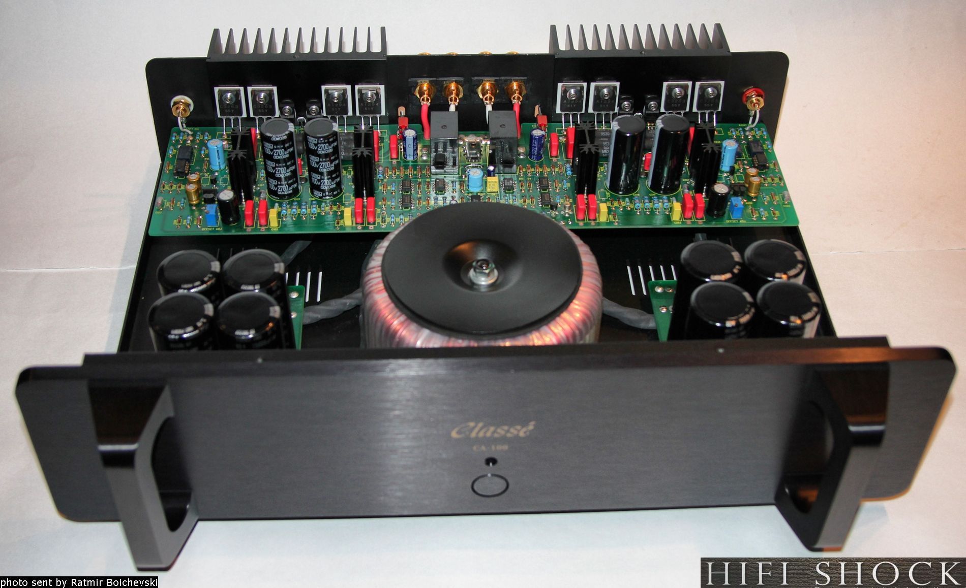

Rca connectors - resistor
Id like to ask why there are two resistors atached one on left and the other on the right side of amplifier rca connectors , in the original photos of classe ca-100 amplifier there is no resistors?

check your power amp output noise without interconnects and then with interconnects and finally with the interconnects shorted together at the barrels.
These 6 measurements should show deficiencies in the power amp wiring.
I did that but not with speaker connected and there is no difference with or without cables and even if i shorted togheter at the barrels i look closer and there is one positive cable to rca , one negative or ground is connected from xlr connector below the rca and between these two cables are resistor.
Regards
If you measure output @ 0.0mVac for all six test arrangements, then the Power Amplifier has been wired to be tolerant to the way the interconnects are wired.
That means the wiring fault is inside the Source.
THX Andrew for help i did check again and it is 0 mV , if i connect speaker cable and interconnects to power amp still ok but if i touch the tip of IC the middle pin on rca from power amp i hear a poping sound from speakers .
The line-out connectors from the tube preamplifier are not balanced for use with XLR connectors and I assume the input sockets on the CA100 amplifier have not been properly modified to accept a balanced input either, so what part of your system uses XLR connectors, which usually means a balanced line?
I guess the amplifier has been modified, since you say there are additional resistors between an XLR socket and original RCA input sockets on the amplifier but it would not make sense to change to a proper balanced 600 ohm line, just for the sake of it. I'm guessing XLR cables are for looks or for when the amplifier perhaps was used with another preamp. that did have balanced outputs.
Personally, I would remove the XLR adaptor wiring and use both units as designed, with RCA connectors. You probably wouldn't like to pay ($$$) for a transformer to adapt the PV10 to a real balanced line anyway.

Thanks Ian for replay my sistem is cec cd player tl5100z , conrad johnson pv10a and power amp classe ca100 , those resistors where removed no i will leave as is.
