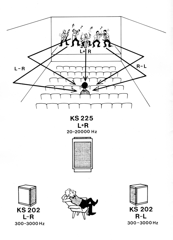

In another thread I found on this forum there was a link to the SALORA ORTOPERSPEKTA. This is an arrangement of a center speaker reproducing L+R plus two side speakers reproducing L-R and R-L. The figure is attached.
I could do this kind of thing with a center "console". This might work well since it no longer needs to create the entire stereo image itself (the console is monophonic). So it can be a subwoofer array plus mid and tweeter or the like. I have a nice pair of DIY dipole speakers that I use now, and these are already located near the sides of the room since I designed them to be widely separated. Adding the center console, I could switch the system to the ORTOPERSPEKTA reproduction mode or use the dipoles alone.

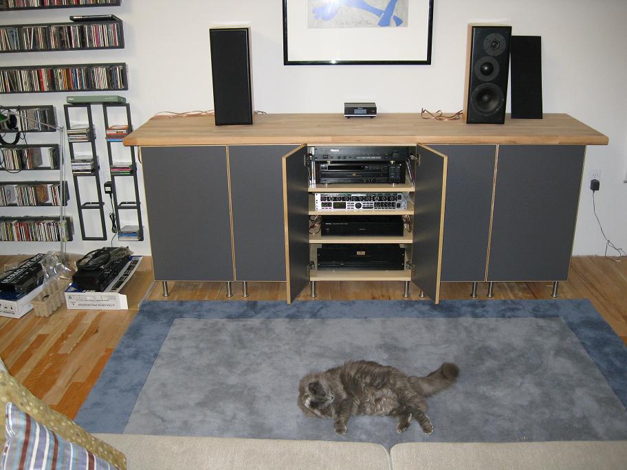

This really isn't so bad if the box is large. Think of a large wardrobe or chest.
In a previous home I used a row of IKEA kitchen cabinets with a butcherblock counter top. This measured about 2 feet deep, 3 feet high, and 8 or 9 feet long. I converted the large cabinets at each end of the row into subwoofers with downfiring woofer and port. The entire thing was on legs about 6" high and from the front you could not tell that it contained the subs, power amps, and the rest of a stereo system. Two small monitors were located on top at each end to provide everything above 100Hz. It's now been moved to our present home and the subs removed and converted back to shelves. It still holds a small stereo system and is used in a spare room for storage.
A console could be the same dimensions or larger and all of it could be used for the loudspeaker. I think it would be interesting to try, and I know from the above system that it can be made to not be visually objectionable (for me) with the right design execution.
Edit: I added a picture of the IKEA cabinet stereo "console"
