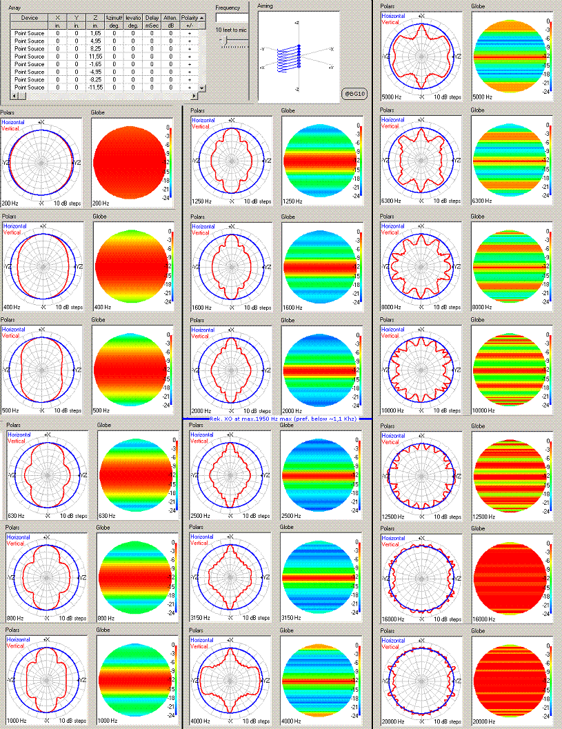

Hi Elias,
Agree, IMO, short arrays using 3-inch FR drivers sounds bad above 3 kHz where the vertical dispersion suddenly becomes huge even if the real driver is narrowing the upcoming secondary lobes.
FYI: This can be clearly being seen and estimated using a point source simulation: see picture (1)
b

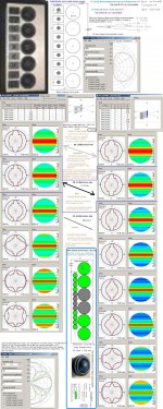

Hi
’ Array made right!’
Of courseall arrays built by DIY’rs are right but this example looks for me like a typical first short array design-shot where the performance numbers given supplied are colored with a grain of wishful thinking. Note: I don’t dismiss the DIY’rs subjective impression when he is stating: ‘It sounds good’ as this is just an opinion based on unknown preferences.
Just for fun:Cloning an avatar-array: See picture (2)
b
