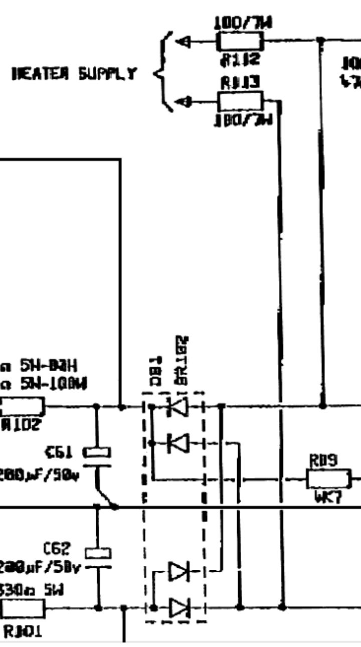

Here in the Marshall Valvestate 80 Guitar amp they feed 12AX7 12V filament straight from 30+30 VAC main supply windings, using two 180 ohm 7W resistors as droppers.
Current is barely acceptable 133 mA , not sure how much is needed for the initial cold filament current surge.
Yes, they do eventually stabilize, at least with Marshall labelled or Sovtek tubes.
Again, in higher power amps dropping from 63-70V DC rails problems appear 🤷
They are often mentioned in relevant Forums.
"Technical parameter" considered is co$t , not performance 🥴
