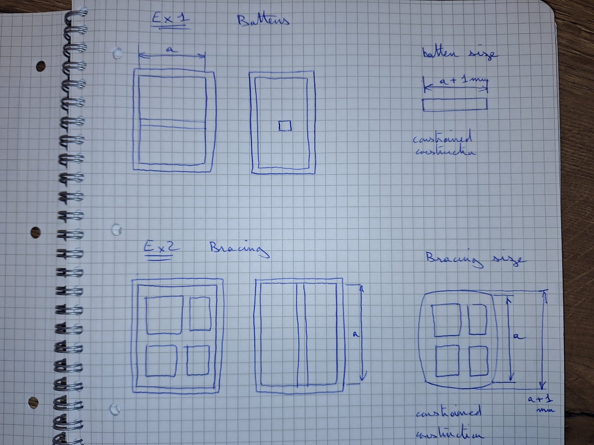

Hi , thanks for your answers.
In order to be sure you correctly understand my question , I add a document to show you 2 examples :
1) with batten
2) with bracing.
You will see than on both example : the size is a little bit more important in order to be able to bend the panel.
I 'm sure the frequency will encrease , but I don't know how to quantify this , or if there is an empiric rule.
For my point of view, it's an interresting way to assemble a cabinet because we increase the panel frequency : without increasing the cabinet weight , size , panel thickness , bracing quantity.
Joel

Pre-stressing might be the term for what you're describing. You could get the same effect and easier to build with brace L=a-1mm...

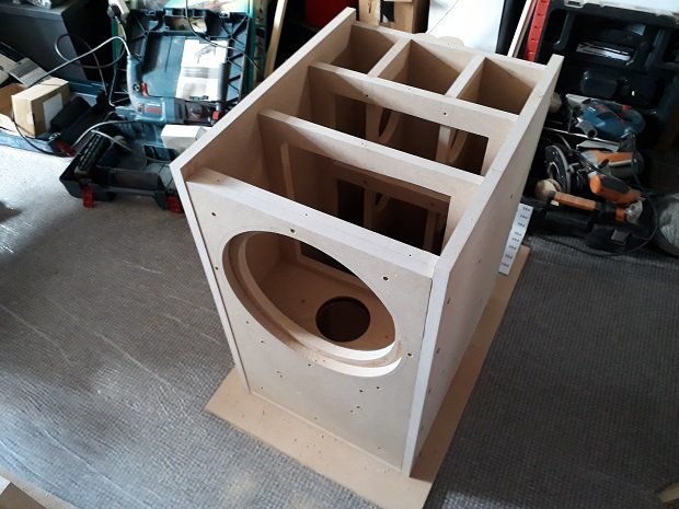

This is an extensively braced cabinet, it's made from 3.4mm ply, so is lightweight (1kg for an 8 litres enclosure) but very stiff, giving it a high natural resonance, well about the 250 (approx) Hz frequency of the bass driver. This works really well. Lots of ribs, and braces.

I am no structural engineer, but bending a board (by applying a bending force/pre-stressing) makes it more stiff and thus raises panel resonance frequency.

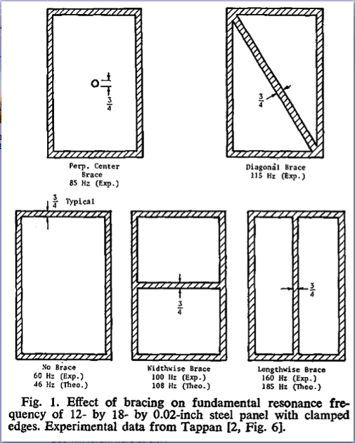

There's this old figure:
Thanx for posting the Tappan Andersonix: Here is the original, a bit bigger and easier to read.
Basics are that dividing panel into smaller panels pushes the (potential) panel rresonance higher in frequency. As Tappan shows a brace in the long direction is most effective.
A brace is more effective if it braces 4 panles. I also like to place them at “irregular” intervals. I like to place the holes in the brace to serve to break up higher frequency eigenmodes.

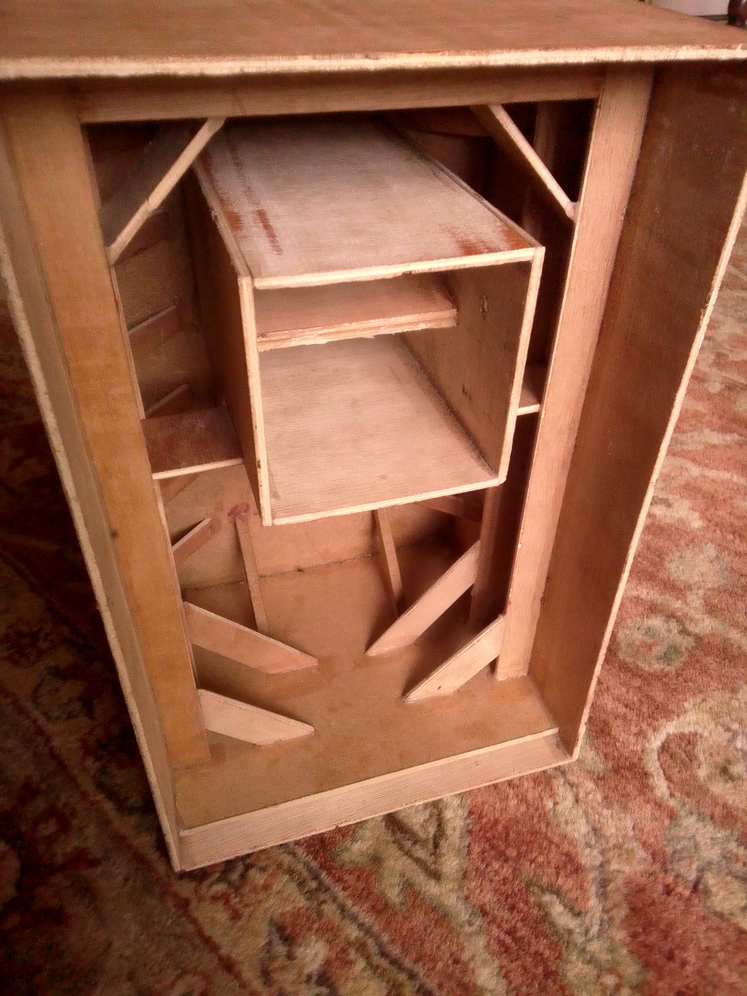

Here an over-the-top example,
Prestressing panels does not hurt. A brace that is a tiny bit too bit, or GM’s frequent suggestion of a ready rod tightened up just enuff to stress the panels,

To be clear material stiffness doesn't depend much on how an object is stressed (bent), but the stiffness of the object itself depends heavily on its shape and its support - which is why a dome is much more rigid than a flat sheet. Its all about how a small change in shape translates to compression/tension and shearing in the bulk material, and that is a complex function of the shape and how it is fixed to other objects.I am no structural engineer, but bending a board (by applying a bending force/pre-stressing) makes it more stiff and thus raises panel resonance frequency.
For instance a pit-prop that's cemented into floor and ceiling is twice as stiff (against buckling) than one that simply rests against floor and ceiling.
Pre-stressing in the opposite direction would be useful if the load was in one direction, but here the cabinet is breathing both in and out. So build it from cheap surplus ply and add bracing as needed later.
