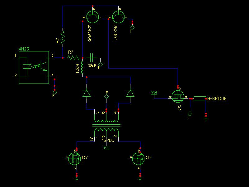

I need to include a Hi Side switch be used to turn on or turn off power to a Full H-Bridge. The Hi Side switch will consist of several parallel Mosfets that will remain continuously on virtually indefinately. This will rule out the use of bootstraping or transformer driven gate drivers since there is no practical way to refresh the gate voltage if the Mosfets aren't constantly switching.
To address this I was thinking of creating a floating supply using a small push-pull PS. The floating supply should be able to maintain a steading floating voltage to keep the mosfet turned on indefinately.
Besides creating my own with a Oscillator + Opticoupler + Gate driver Totem Pole Transistor pair, Is there an off-the-shelf device that does this? I am looking for methods to keep the part count to a minimum and to minimize PCB real Estate. Below is a simply schematic of a floating supply used to drive a High-Side Switch.

How about a standard bootstrapped high side driver IC powered with a charge pump? You can drive the charge pump with the own oscillator of the system through a buffer, or with a separate 555. Note that most IRxxxx high side driver ICs don't require more than 0.5mA for steady state operation, so the capacitor values involved are going to be very small.
On the other hand, you can use a high and low side gate driver IC and employ the low side section as a buffer to drive the charge pump to power the high side.
Note that you can even drive the charge pump from the own switching nodes of the H-bridge if they are continuously oscillating.

Since speed does not seem very important if it stays on for a long time, you may also be able to use a drive-powered MOSFET driver. They use an internal photocell.

Ok, I found IRF's AN-978 which basically uses a 555 Timer to pump charge the Bootstrap cap of a high side driver. I noticed that the gate drive output creates high frequency output dumped into a cap. Should I be concerned with generating noise?
http://www.irf.com/technical-info/appnotes/an-978.pdf
(see Page 18, Figure 17 - Ripple on Bootstrap Cap Voltage)
I think when I drive power through the H-Bridge, the ripple will be worse because the load is dynamic. This might create instability between the High Side MOSFET Switch and the H-Bridge. I think this problem can be addressed by adding some output caps and an inductor between the High Side switch and the H-Bridge to smooth out the load. Although this increases the part count and PCB real estate. Perhaps I can get away with a larger bootstrap cap and a small inductor in series?
FWIW: I found these high-dide drivers with integrated an pump charge (LM9061, LTC1156, LTC1161,MAX1614,MIC5011), but these all appear to be limited to voltages (Max ~26V) below my requirements. Alternatively I think N-Channel ORing Controllers such as the ISL6144 (up to 75V) might work with higher input voltages. Another Option I just though might be worth investigating are hot swap controllers.

Thanks, but in order to use this you need to have a voltage source 10+ Volts above the High side drain voltage. This is the same as using a floating supply.
I am thinking of using a Push-Pull controller such as the IR2085 or UCC3808 coupled with a opticoupler gate driver FOD3180. I think I'll have less issues using a floating gate driver instead of a charge pump. The only issue I've run into, is finding small transformer that is configured for push-pull. I may end up having to winding my own.

What is the rail voltage? 12V? 24V? Higher? If it's say, 24V, then you can simply use a really BIG P-Channel MOSFET, like the Harris RFG60P05E, with an Rds(on) of only 26milliohms! Paralleling enough of them would eliminate the Rds(on) issues.
If this is hi-voltage (120-370VDC), then can you use alot of 500V-rated P-channels in parallel? Using the P-Channel devices eliminates the need for a bootstrapped supply because you simple pull the Gate 15-20V below its drain to fully turn it on. Just a thought................

I will be running from 36V to 48V. I am avoid using P-Channel devices, while I could stack a bunch of them, it would increase the real estate required.
how about a 555 through a couple of capacitors to a bridge of 1n4148's with the positive on the drain an the negative on the gate. n-channel fet of course. no relation to steve.... well maybe.....
I thought about that, but the load will be an h-bridge. I am concerned about driving pump charge off the load might create some issues from all of the switching noise. I think my best bet is to use an isolated floating voltage source, and there really isn't much a of a difference in part count or PCB real estate.

About 50A peak, 48V to 36V, very slow (turned on during startup, turned off during power down, or overload). That BTS660 does seem like a nice solution. Although I've already order parts to prototype a floating voltage driver. If I run into some issues, I'll try out the BTS660. Thanks for the suggestion!
