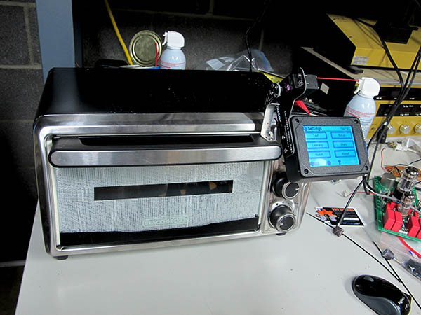

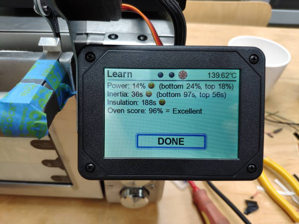

I had been using a toaster oven, or hotplate for SMT stuff. Decided to spring for the Controleo3 MCU controller. Just ran the learning cycle and it works perfectly. You can use the controller for reflow or baking IC's.

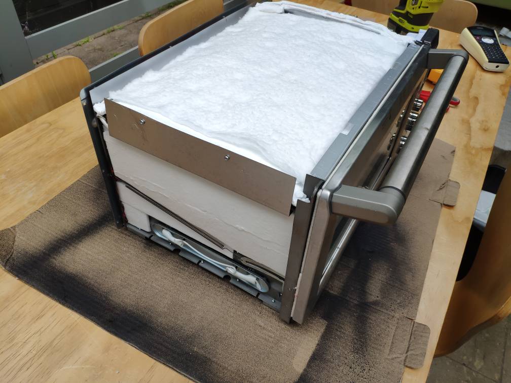

The kit comes with solid-state relays, ceramic blanket, various other insulation and of course the touch-screen and MCU.

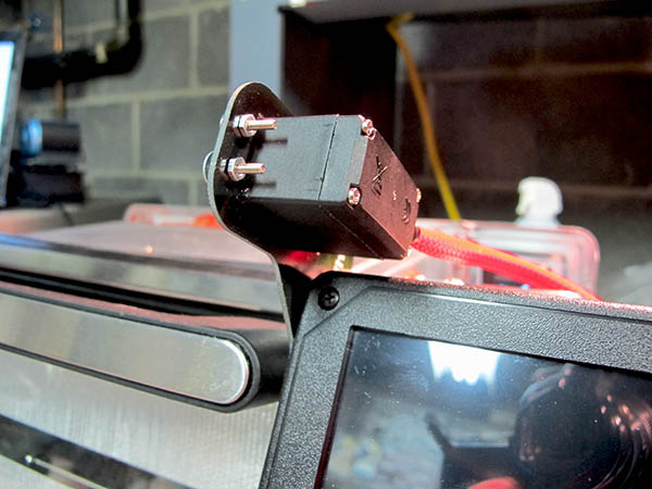

There's a servo which opens the door to cool the oven down -- much better than the "armstrong" method.

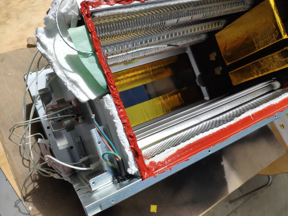

I was fortunate to only cut myself once in taking apart the Black and Decker oven.

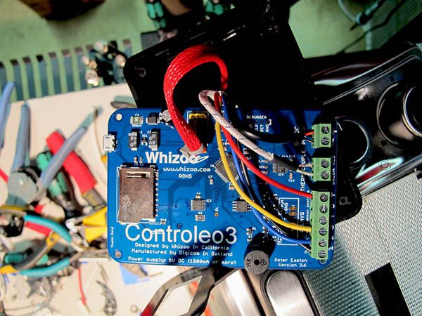

Whizoo gives you two "profile" examples -- these can be downloaded to Notepad and modified to fit the profile of the SMD paste you are using. In my case Chipquik leaded (keep it refrigerated.) These are then written to an SD card.
I did time and temperature for about 10 runs until I created a profile which matches the graph on the Chipquik datasheet.
The servo allows you to visit the gents while your board cooks.

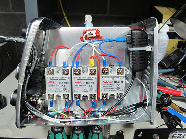

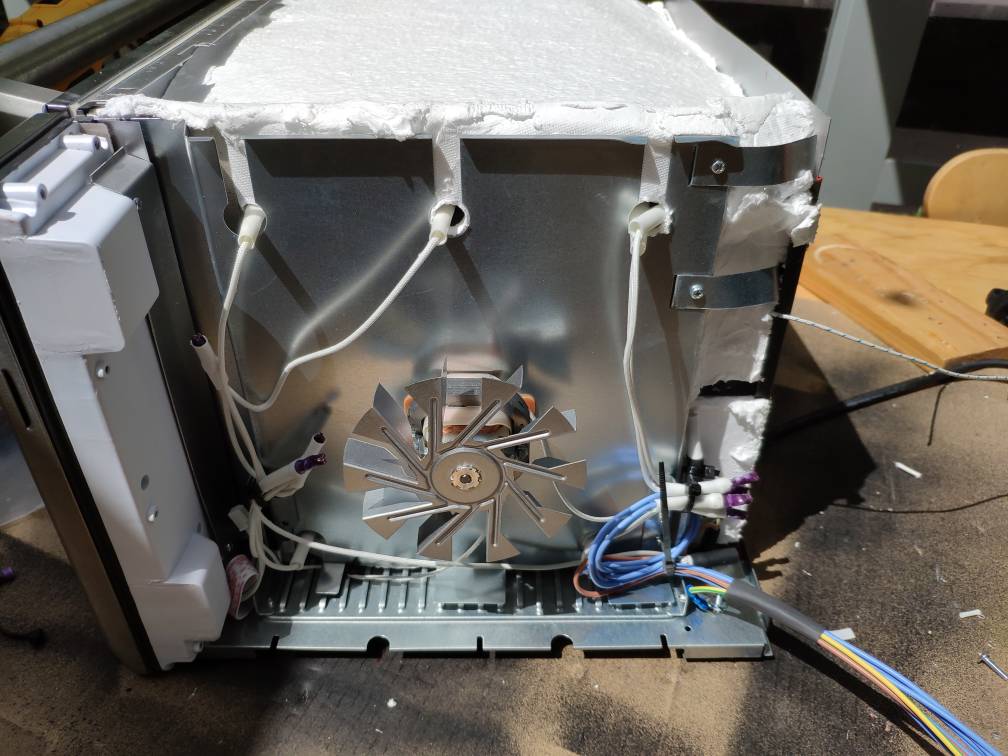

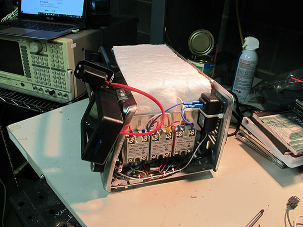

The oven works quite well. The very thin sheet metal of the Black and Decker oven is difficult to work with, and plan your drilling with care.

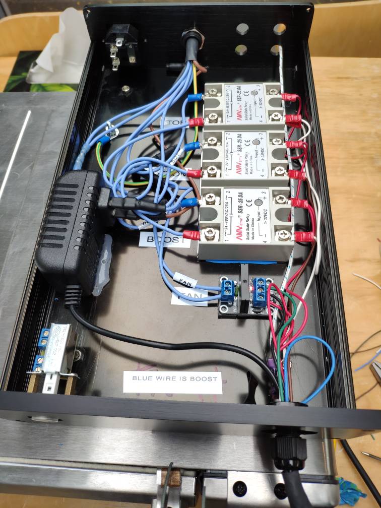

I chose to put the control SSRs in a separate enclosure which made the build easier.
Good idea.
