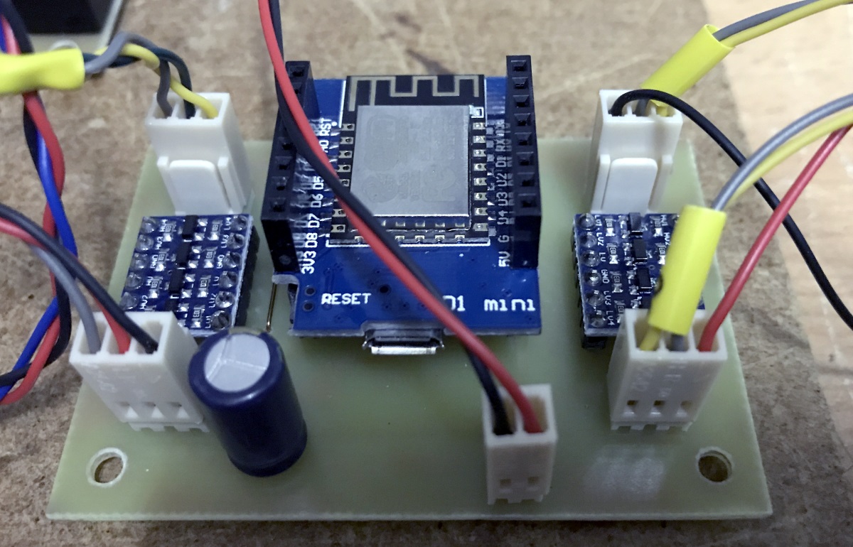

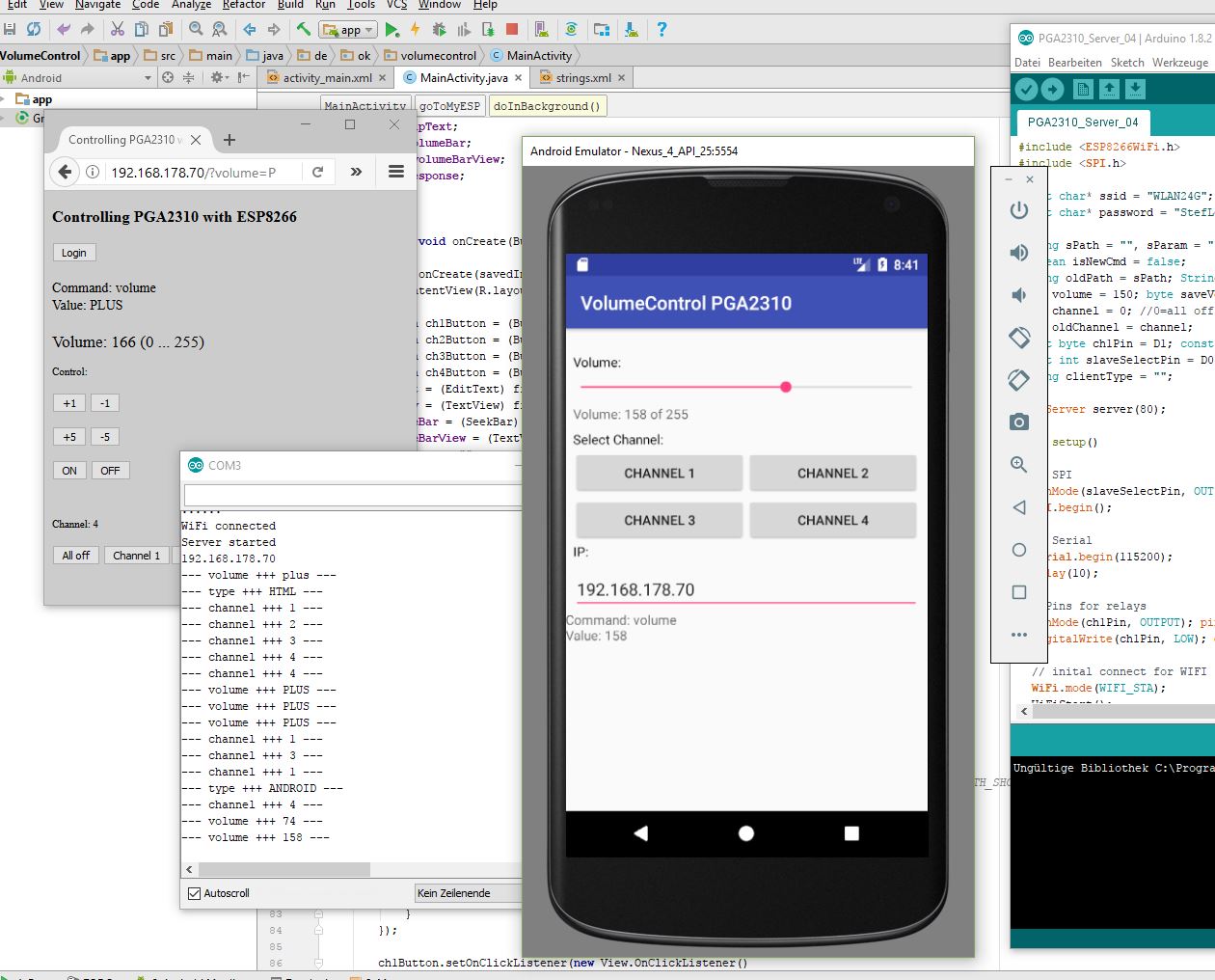

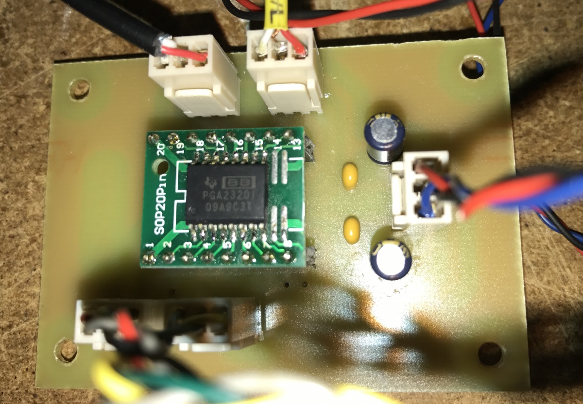

Hi, the first step is a program for the ESP8266. I have used the D1 mini or the D1 and programmed with the Arduino platform. After installing the ESP8266 components, this goes quite well.
The sketch follows the example from here:
https://blog.thesen.eu/stabiler-http-1-1-wlan-webserver-mit-dem-esp8266-microcontroller/
I uploaded the sketch as attachment.

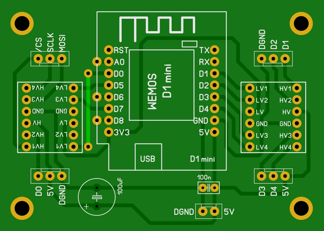

To have only one way for the control data, I want to control the web server via the App as a webclient. This can do Android pretty easy. I had on the way already controlled a LED Strip, so I have to implement the same for the PGA.
The picture shows the PCB for the ESP8266. I use 2 level converters to get from 3V3 to 5V. The ESP itself provides the 3V3.
For the tests it does not need a PGA, the ESP is completely enough alone. The you can play with the Serial and the browser.
For the tests one does not need a PGA, the ESP is completely enough alone.
The serial monitor is required to find the IP address of the ESP. But you can also look in the WLAN router.

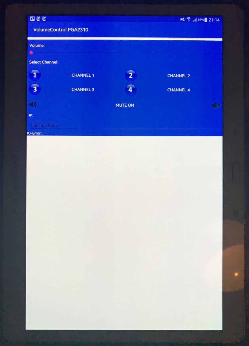

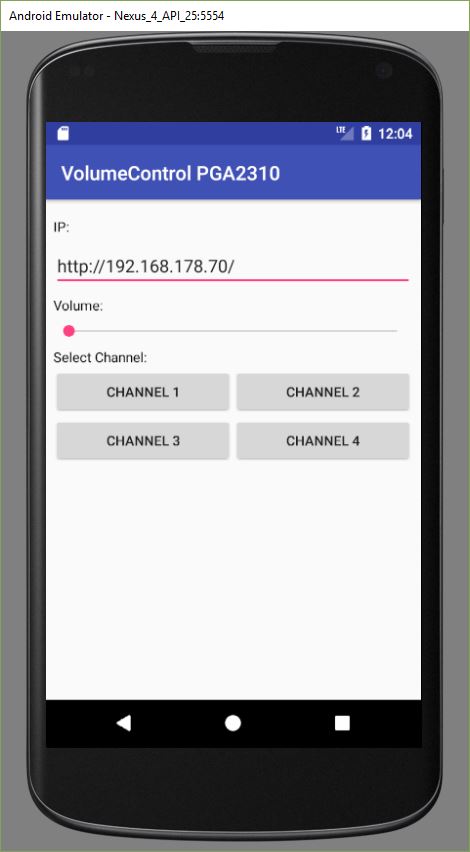

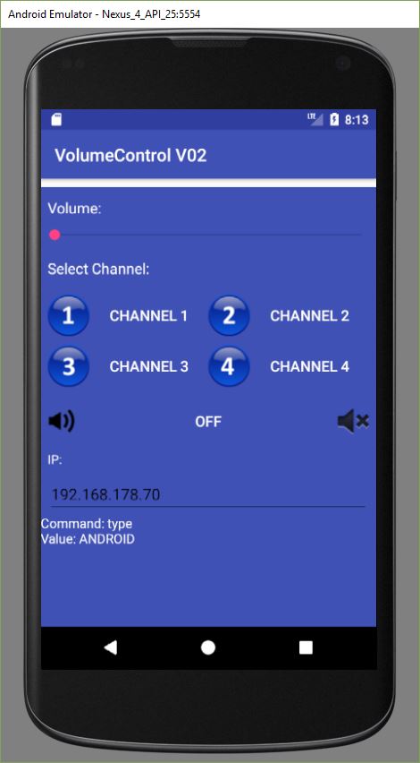

Progress
I've made some progress. The Android app can control the ESP. At the moment only a few basics are implemented, but the access via the webclient works. Maybe I can get an intermediate result at the weekend and maybe I even understand one day, what I have programmed :)
Best regards
Olaf

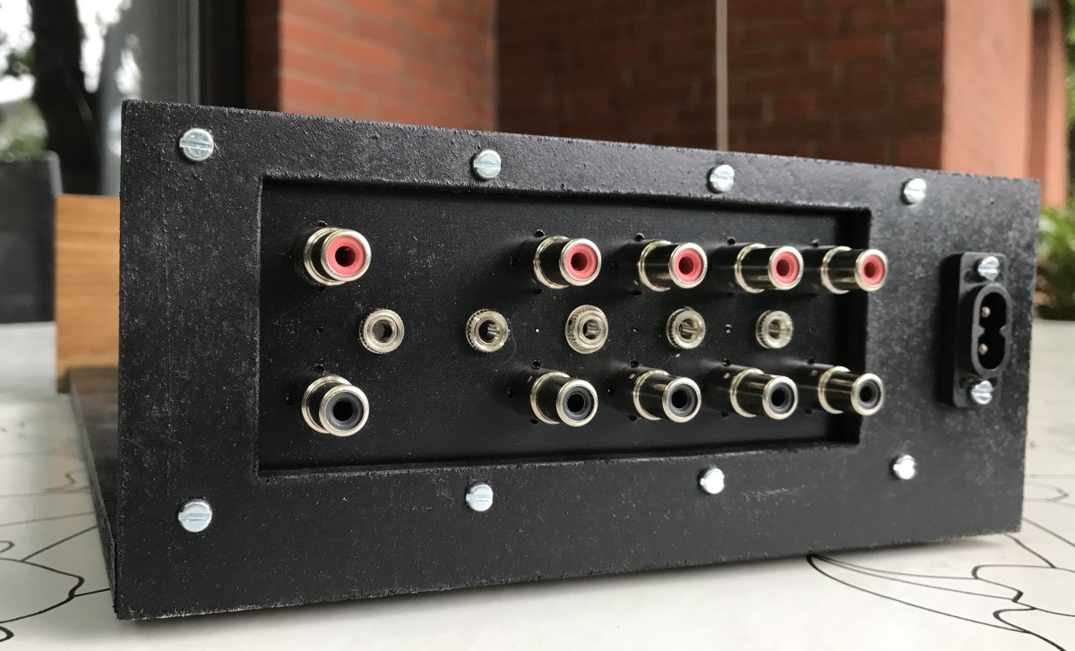

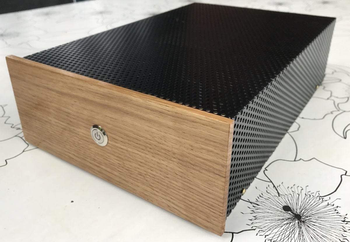

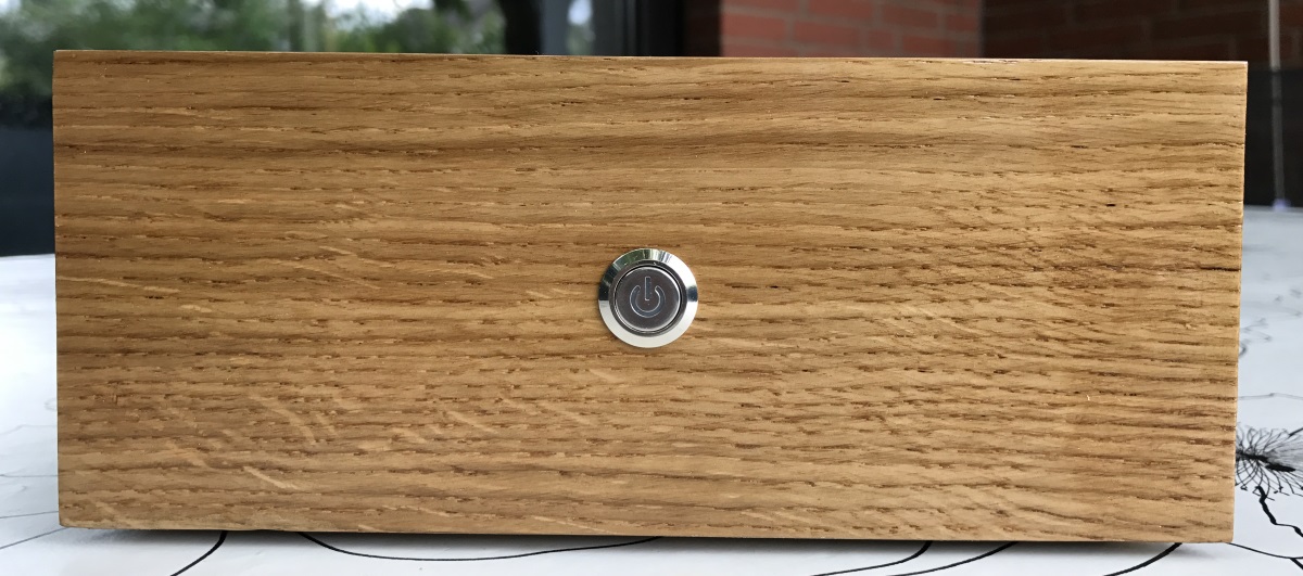

Progress

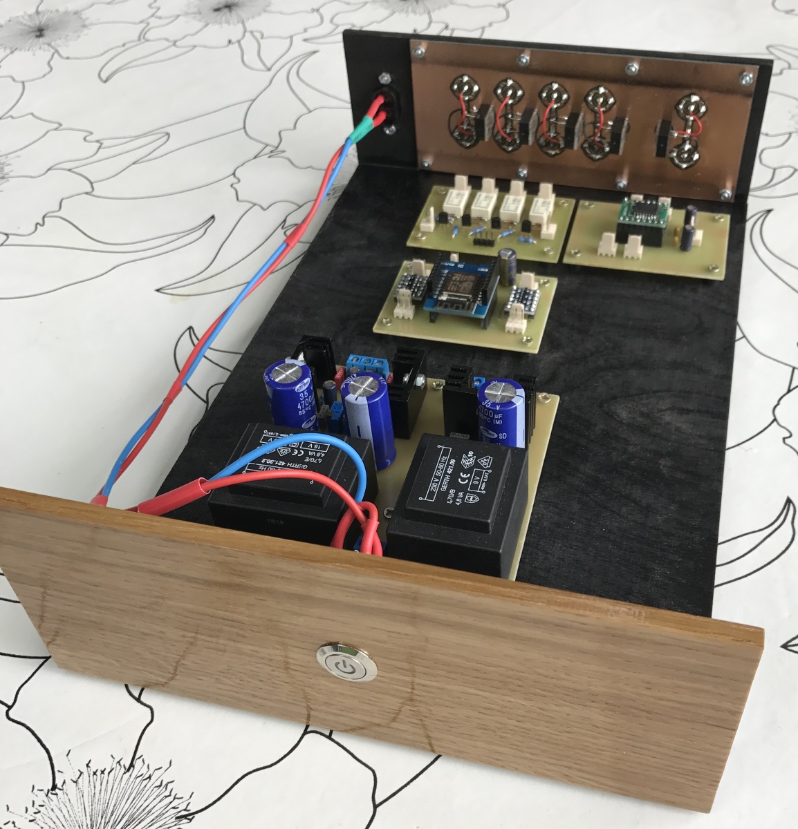

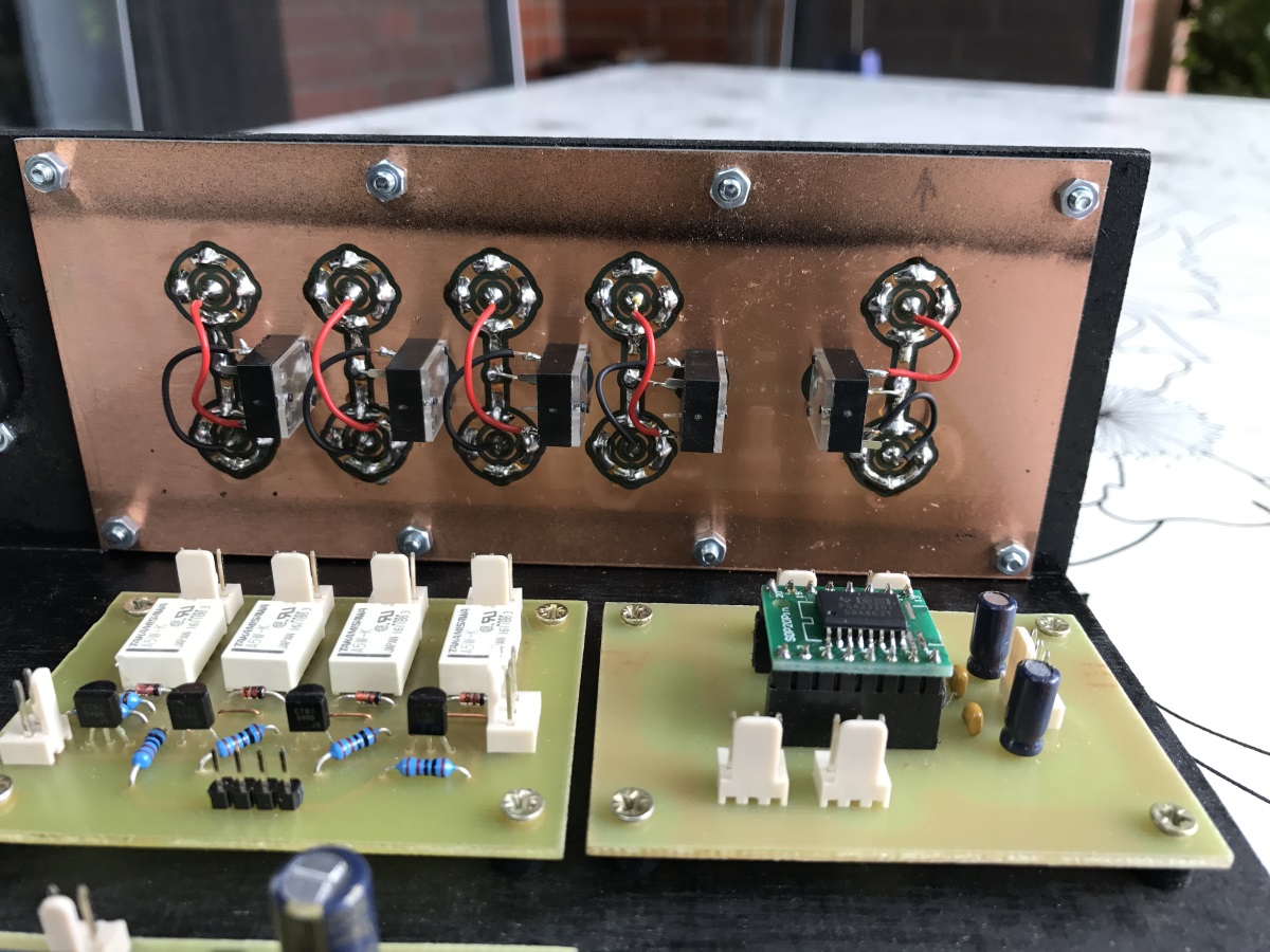

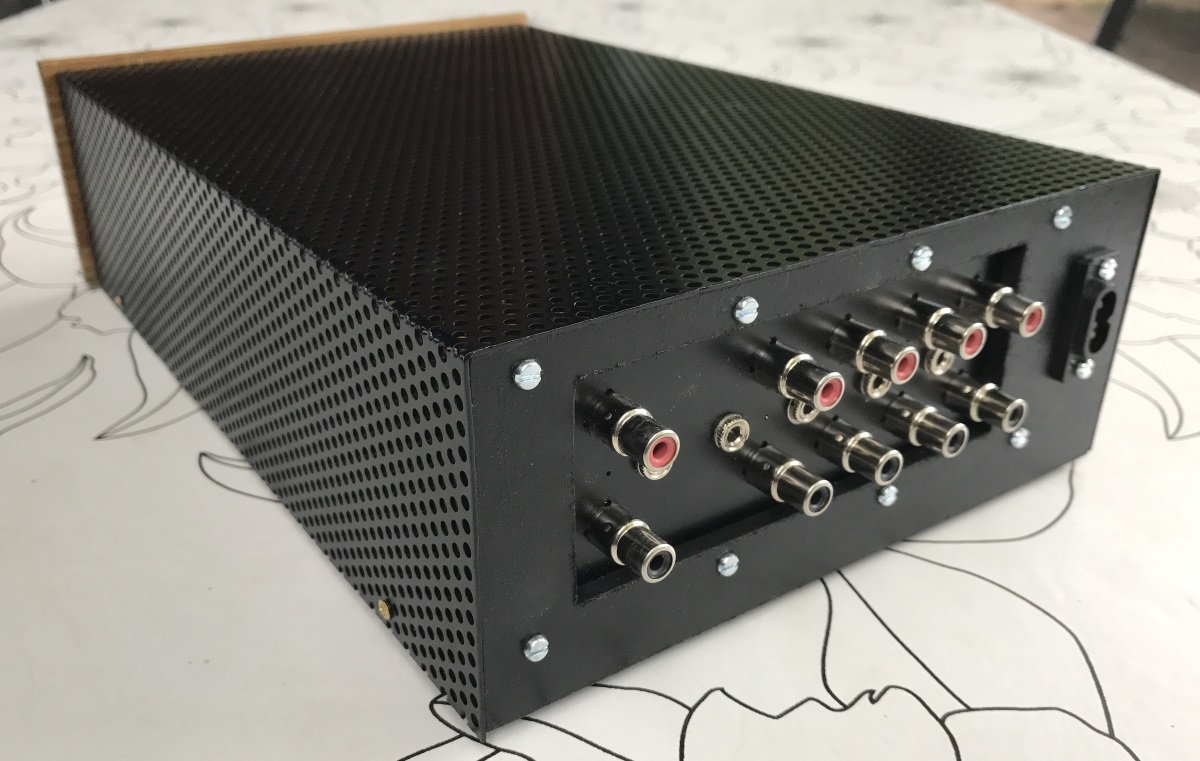

Hi, the next step is a simple case. Software testing with loose wiring is no fun, so I want to wire everything first :)
I have even found a nice oak board for the front plate.The cover I will make from aluminum perforated plate. Hopefully this does not affect the wireless sensitivity.
The next steps will follow soon.
regards Olaf

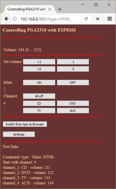

Next step

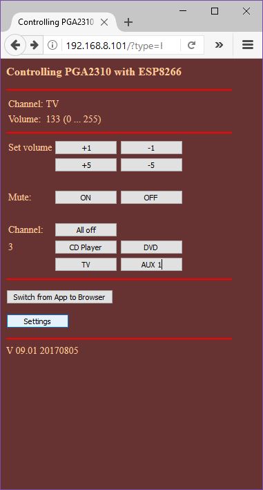

Hi, here everything works now.
I recommend the following procedure:
First use only one ESP8266 without PGA23xx
Install the arduino sketch without errors
Call the ESP with the command "yourIPforESP" /? Type = HTML with the browser
Then you should see the interface in the browser
Then copy the android project into the folder for the android studio projects
Start android studio
Select "open android project" and select the new project folder
Follow the instructions of android studio to simulate and test the app
The first steps without experience with android studio are not funny. It takes a lot of patience and often google to bring everything together. Unfortunately, I'm just a beginner. I find it much easier to program an app than to understand all the settings in android studio.
regards Olaf

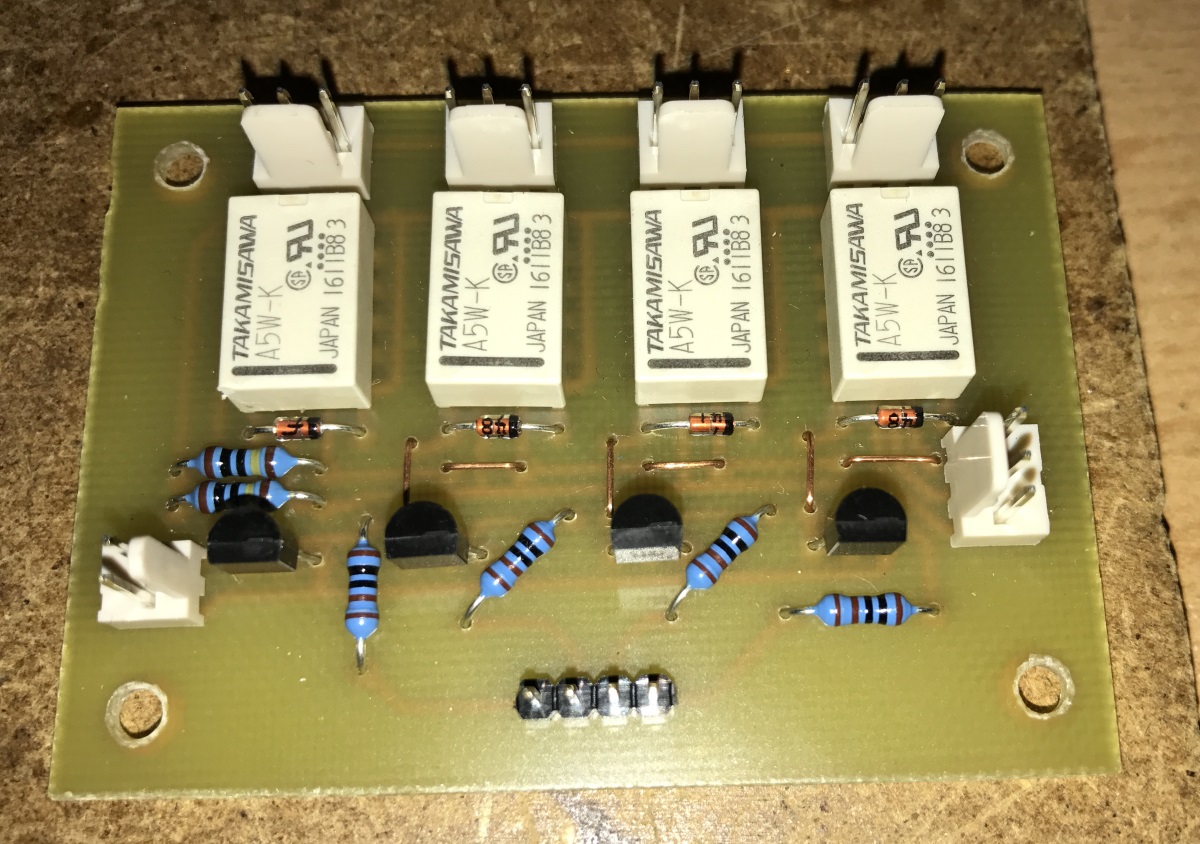

Hi, I will upload patches and updates from time to time and a better project file. There are still many functions missing:
- Store start values for each channel
- free selection of names for each channel
- Balance
- Reread the current values from the ESP back into the app
The circuit boards are also not yet as I would like. The main functions could be summarized in one PCB.
Many possibilities for a new version :)
Regards Olaf

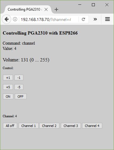

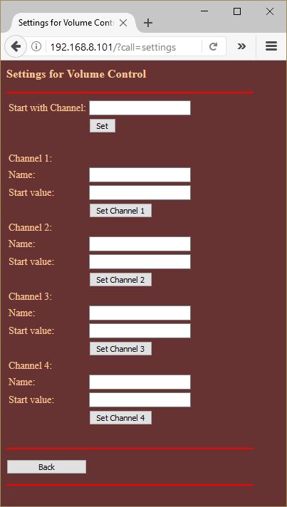

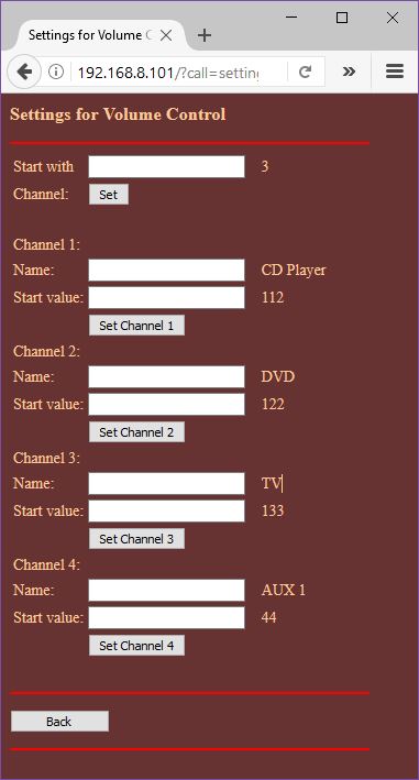

Progress
Hi, I have made some changes, but so far only for the browser.
In the settings you can now save the names of the channels (text on buttons) and the starting value of the volume per channel. In addition, the channel to be selected after switching on. All settings are stored in the EEPROM and are read out at startup and can be changed on an HTML page.
Before I post the code, I have to make a bit of cosmetics :)
greetings
Olaf

New Software for browser
Hi, here is the next version for the browser. Added settings and some information for better usability.
This version should be enough for the browser. In the future I will continue with an update of the Android app for the same functionality.
regards Olaf
