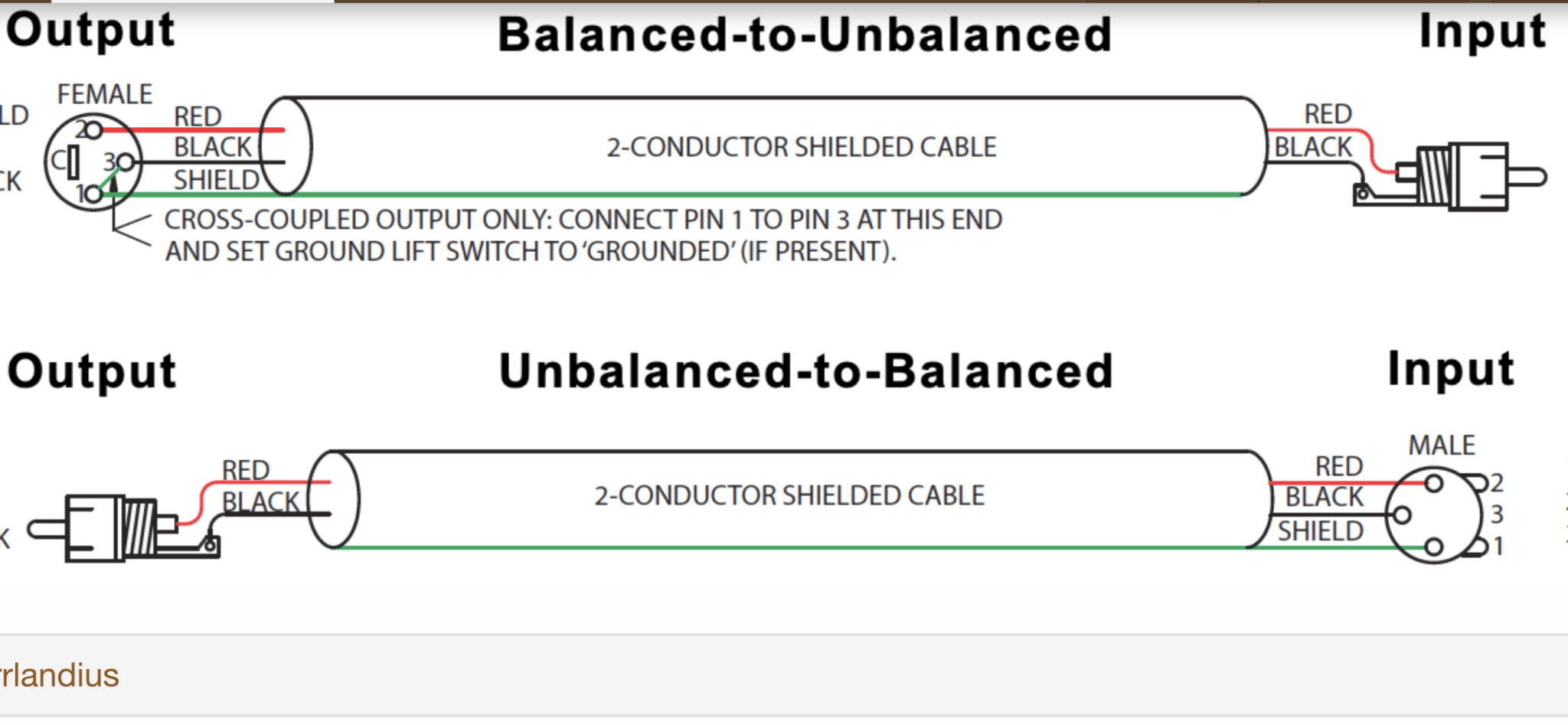

I'm looking at building an amplifier from Class D modules (ICEpower). I am using balanced XLR cables everywhere in my system, so would like to build this amp with XLR input, even if the amp is not designed for balanced input.
How much of a problem is this? I thought I should be able to connect the ground pin to the chassis ground, and add a resistor between the XLR and the amp input? Or is there more to it? Or a potentiometer? I don't the correct value at the moment.

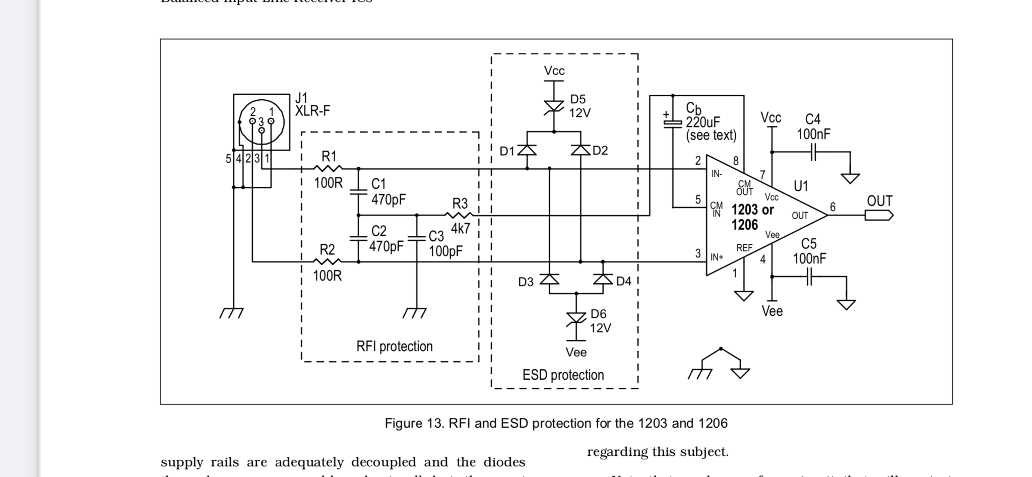

To convert a balanced signal to an unbalanced input.
You either have a conversion module with op amp, or go through signal conversion transformers.

Connecting the cold point to ground is not the best option!

Just use the + pin on the XLRs. +R and +L with Gnd make a 3 wire single ended input, the source does not care.
I would not leave Pin 3 un-terminated in your XLR input connector. Put a resistor from Pin 3 to ground with the same value as the input resistance of your Class D modules.
Not absolutely necessary, but with this configuration both sides of your balanced interface see the same resistance at the load end.
As mentioned, a transformer scheme or dedicated circuit would be preferable though.

Thanks! A conversion module would be just fine.To convert a balanced signal to an unbalanced input.

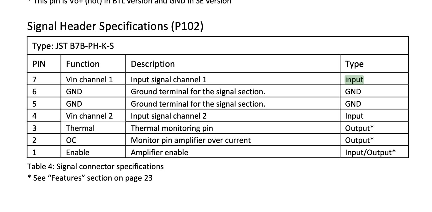

I'm not an electrical engineer, but this does not look like a balanced input to me? This is from the data sheet of one of the ICEpower ASX series amps. I was told by someone who I believe to be an electrical engineer, that these amps are not balanced. And I see no indication that they are balanced.AFAIK Icepower modules have balanced inputs.
To corroborate, in the amplifier's manual, they show a diagram of the configuration they used when certifying the module, and they showed 2 wire inputs, not balanced inputs.
Is "single ended input" electrical engineer for un-balanced? The ICEpower manual describes the inputs as single ended, and I didn't know if that meant what I thought it meant...make a 3 wire single ended input
@fredygump Not sure about engineer speak! It is just plain audio terminology really. Yes it means un-balanced.

I see above you have doubts these are balanced anyway? mamocel suggests they are only balanced in bridged mode. Looking at the chart you posted he is probably right.

It appears to me that this series of amps has un-balanced inputs in all configurations. I would want to see it stated in a manual or data sheet somewhere if someone says otherwise.I see above you have doubts these are balanced anyway?

Datasheet
That corporation https://www.thatcorp.com/datashts/THAT_1200-Series_Datasheet.pdf

I built an adapter cable from a 1/8 TRS to dual RCA cable.. simply cut it in half and added XLR male and female connectors to facilitate extending it to any length with a standard XLR cable. This gets used to connect a remote laptop to a sound system at wedding events, that laptop feeds video to a projector and is usually some distance away from the mix position. In this cable pin 3 of the XLRs is unused and not grounded and in most cases this link is completely noisless, if some noise is picked up I insert a transformer isolator in the link.
I have also used simple balanced to unbalancd cables to connect consumer and pro gear without issue, leaving pin3 open and ungrounded on the balanced end is actually the safest method for the equipment.. some gear can be damaged by grounding an input leg so best to try that first, if it's noise free there is no need to do anything further.
