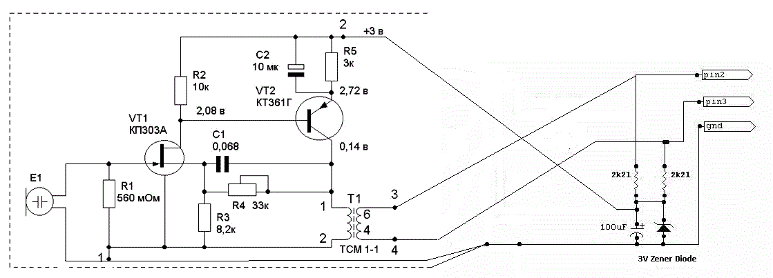

I attached the schematic 🙂
There's the original schematic, I've done nothing but only changed the 10uF electrolytic cap with a new one.
The phantom part is an add-on. Very simple, two resistors, a cap and a zener. Would this work? It would be very easy to implement, without the batteries there's a lot of room in there.

Have you taken the internal resistance of the phantom power source into account, typically 6.8 kohm or 6.81 kohm from the 48 V source to pin 2 and 6.8 kohm or 6.81 kohm from the 48 V source to pin 3?
Simply that there are two well-matched resistors of 6.8 kohm between the actual 48 V supply and the microphone input inside your mixing console (or whatever equipment you are using to supply the phantom power). Hence, the current through your zener may be smaller than expected.
By the way, if you are using a mixing console with a transformer at the microphone input, it can also be a single 3.3 kohm resistor to the centre tap of the primary.

The original LOMO schematic shows a somewhat poor design, mainly because
* DC is passing through the output transformer (ugh !!!!)
* even with your conversion, it is still powered by 3Vdc (ugh!!!!)
I guess you may search around and build a much better preamp, which either fully replaces the transformer by balanced Op Amps or whatever or at least does not pass DC current through those windings.
And using a better share of those 48V available.
A preamp fed 15/18V would be immensely better.
