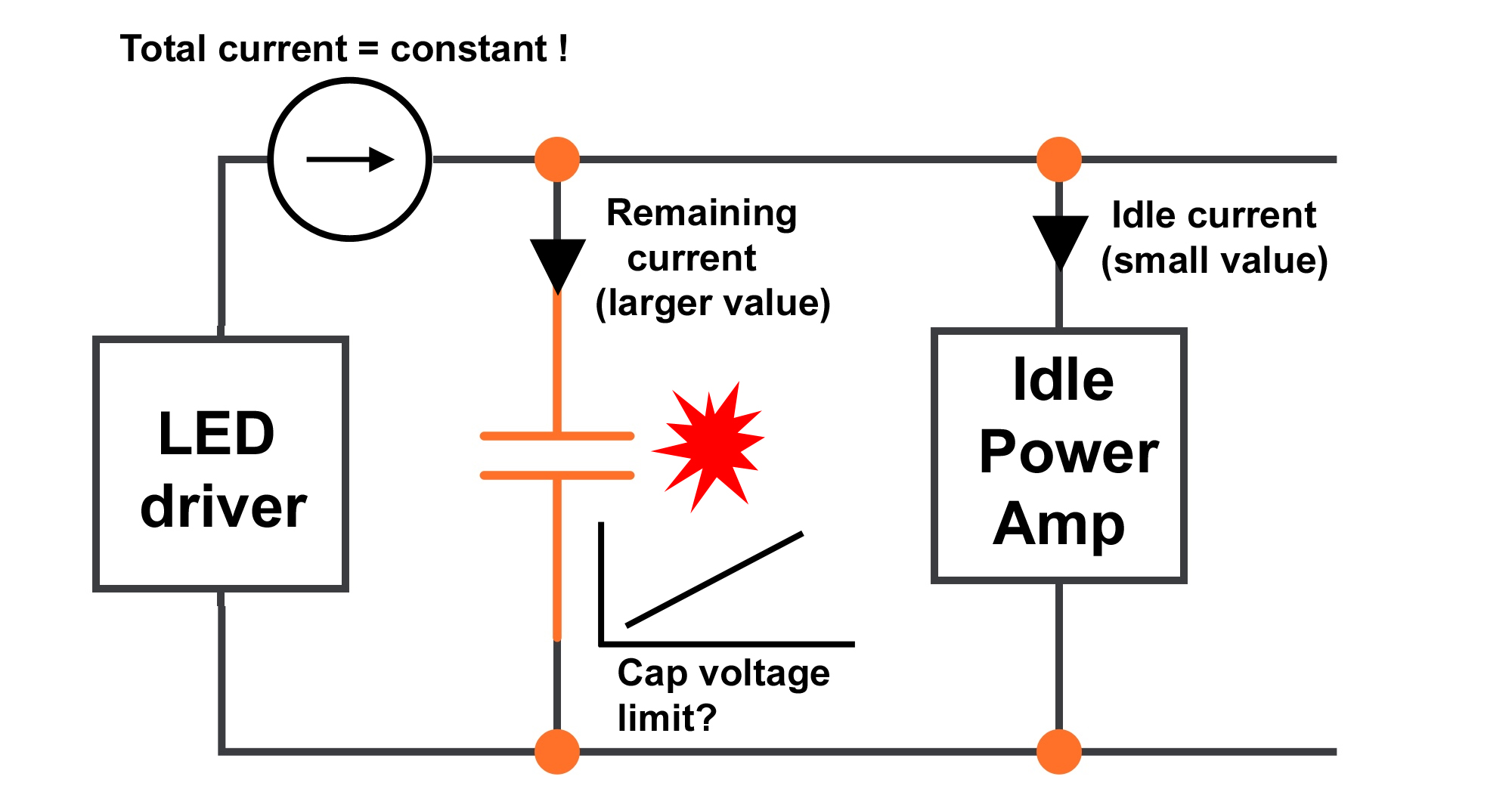

And if you really want to hack it, find LED drivers to use as SMPS...
However, a small problem with LED drivers is that many (but not all) are constant current supplies (vs. constant voltage.), which in turn is because it's the LED current (not voltage) that controls their luminous flux output.
My point exactly, constant voltage units may not respond as fast to load variations as constant current units.
LED drivers from old units do not work on newer lamps as they are bulky, or the new designs are driver on board which means the lamp PCB has a direct mains input. No driver is needed.
So they are being scrapped. Which means available for a song.
I feel they would work, no harm in trying.
Naresh,
Consider an amplifier at idle (or low power) powered from a constant current source, and think what would happen to the bus capacitor under such conditions (see picture)? And, I think you already understand that we can't omit the bus capacitor !
Now, let us be a bit optimistic and assume that the constant current LED driver has a voltage limit, in which case the power supply would be swinging in response to the fluctuating load current (or music power). However, the main question is if that's very becoming of a good power supply? Well, there's the PSRR, but does that mean that we should be presenting the amplifier with a fluctuating supply voltage?
Thanks and hope you understand my point.
