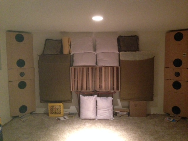

Inspiration is from speaker dave's interview here:
[Interview] David Smith [English]
And his expanding line array design:
Snell Acoustics XA Reference Tower loudspeaker | Stereophile.com
Attached is a pic of the speakers. I built some trial cabs just to try out the concept. The goal with this speaker design was to eliminate ceiling and floor reflections. It is supposed to be an expanding array with the array length increasing as the frequency is lowered. The outermost drivers have a LP at 125 Hz. The two central drivers have an LP at 500 Hz. And the KEF coax has an HP at 500 Hz. Then there is a passive crossover between the tweeter and the mid driver in the KEF Q100. There is some shelving of the mid and outer drivers to even the response.
Putting it in the corner gives it 90 degrees horizontal control to the low frequencies. I'm guessing that when you enter the wave region in the room, directivity is meaningless. Also, there should be no front wall reflection from the corner placement. Another big advantage.
There is a quadratic residue diffuser in the center and some thick absorbing panels. With this setup, the front wall completely disappears. There is a great sense of envelopment and a feeling of being in a different acoustical space.
My question is, are there any special rules to follow regarding the crossover and level? Is the approach to low-pass the outer drivers at progressively lower frequencies the correct approach? I've adjusted it to flat response and perceptually, it sounds flat.
Hoping that speaker dave chimes in, like he usually does. Any other thoughts, comments?

cls, I figure that mid and tweeter's dispersion is wide enough. Corner placement minimizes early sidewall reflections, and therefore mid and tweeter should be placed deeply in the apex of the corner. With dsp it is possible to use time delay to each driver to get step response right
There has been a sideline discussion about similar construction here at diyaudio (synergy horn thread?) Sort of combination of Klipsch cornerhorn and synergy horn.
Using a line array bass helps to fight room modes and concentric mid-tweeter combo gives sharp imaging. This should be close to optimal configuration, when the room allows it (being symmetrical with straight clean walls)
Please ra7, tell us more, simulations, measurements, construction, everything!

No simulations at all. Construction is pretty simple. Nothing spectacular as you can see. The boxes are built out of chip board. The main goal for me was to try the corner and expanding line array config. Intuitively, I knew it would work, so I thought I'd just give it a try. I took a chance with the placement of drivers. The outermost drivers are rolled off pretty early (125 Hz). I could've placed the outermost drivers anywhere on the baffle. Or there could be more drivers too.

Progressive low passes is the way to go if you have a line array of similar units, say a row of 4" full ranges. Then you would shoot for letting the effective array length stay in proportion to the wavelength.
Since you are using a variety of drivers sizes (therefore bandwidths) then you have to crossover high and low in the conventional way. For the XA series that is what I did. For the most part I empirically derived the designs using XOPT as the system simulation. I could track on axis, 15 degrees and 40 degrees up and down responses, and shoot for minimal change at 15 and lobe free constant drop at 40 degrees.
Geometry is key to this. You would love to have units spaced to less than a 1/2 wavelength apart at the tops of their respective bandpass (say, from M to M of the central MTM) but that is very difficult to achieve in practice. The greatest difficulty is getting a tight enough spacing between the tweeter and the 2nd-to-top elements. You have circumvented that by using a Uni-Q unit for the top crossover of 2 sections.
Based on that it would be nice to get a good match to the Uni-Q directivity for the lower sections. Your geometry is already fixed so the remaining variable is crossover points. If you don't have a simulator you can measure where your nulls and lobes come in by measuring up and down from the mid line and see if you can practically cross over before the worst off axis dips. Note that you can do some simple array modeling, good enough for your particular geometry, with Tolvin "The Edge".
I started with LR type crossovers but in the end had slightly better performance with non-symmetrical crossovers.

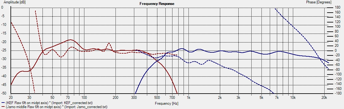

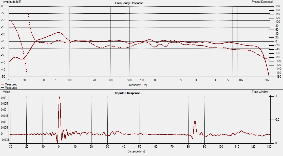

Measurement
Here's a measurement at 6ft from the corner on the axis along the midpoint of the KEF and Jamo drivers. The crossover is at 500 Hz, LR 48db/octave. Using rePhase for the convolution. I went ahead and flattened the phase as well. Looks pretty good doesn't it?
The second picture shows the individual driver responses. This is after convolving the raw driver response with the filter from rePhase.

ra7
Joined 2009
The latency problem is still there. I stopped using the JRiver convolution to do real time measurements. Now, the raw drivers are measured directly (EMU soundcard -> amp -> speakers), while capturing relative phase between drivers. Using this raw measurement, filters are generated in rePhase and imported into Holm for convolution. Finally, loopback through JRiver is used to confirm the result. So, the first graph in my earlier post shows the measured result with both drivers playing, the second graph shows the result of convolving the filters with the raw response.
Yes, there is a reflection at 80 cm. No, it isn't gated out. The response is 1/3rd octave smoothed. From my limited investigation, that reflection is from the sidewall. How would you get an idea of the low-frequency response if you gate out that reflection? With the corner loading and the effect of two woofers, a near-field measurement may not be very easily equalized for splicing with the far field response.
I've tried to lessen the smoothing and it tends to add more "grass" without doing much to the overall trend.
