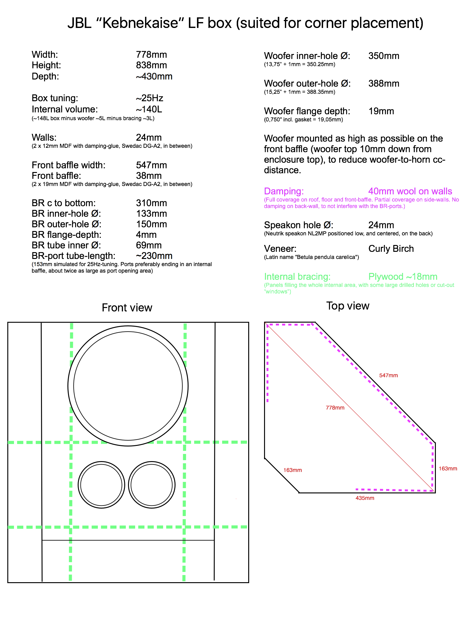

I am really interested in the concept of corner speaker, to be able to get the same dispersion in all registers. I do not know if that is the holy grail or not, but it would be fun to try!
I have been sketching on an DIY corner speaker, see attached sketch.
Maybe I should change to this kind of curved baffle mentioned here then? I just found this interesting thread.
Active 2-way, based on some loose parts I have (usually used in the JBL 4365 Studio Monitor).
15" Woofer JBL 1501fe.
Horn placed vertically on top, JBL H4365, with 4" compression driver JBL 476mg.
Crossover at 650Hz LR48.
Feedback would be welcome. Especially from Wayne Parham, or if we have any other corner-speaker interested here!

That is described as a LF box so its probably not intended to play much above 100 or 150 Hz. Above that somewhere you would likely get a boundary null. Where the woofer goes omnidirectional some sound will flow parallel to the baffle, hit the side walls and bounce out to the listener. The minimum path length difference is from the center of the baffle to the wall.
