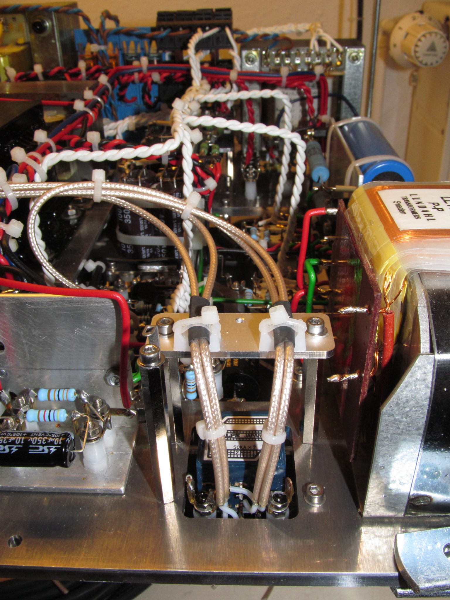

Hey there,
what do you think is the best way to terminate coaxial cables for internal wiring purposes? There are many ways:
a) Strip the outer insulation, twist the braided shield together and solder it to the ground connection point.
b) Same as a), but solder a thin, flexible wire to the shield, insulate with shrink tubing.
c) ...
A first attempt looks like below, but I realized later that I created a somewhat large current loop by going out of the back end with the green wire. Should have gone out of the front end directly to minimize loop area.
Other ideas? How do you usually solve this?

You may not want to ground the load end of the cable's shield, to avoid a ground loop.
If this is for audio circuits, it may be best to ground the shield's source end,
and to insulate the shield's load end.
I think that a single-braid coax is just the same as any other 2-wire unbalanced connector, that is to say both the core wire and the shield must be connected at both ends. Current flows from the source to the receiver down the core wire, and there must be a return path to complete the circuit - this is the shield for plain coax. You do not want the return path to have to go out the PS of the "receiver" end equipment, out the mains cord to the wall socket, back up the mains cord of the "source" equipment, and then through its power supply in order to complete the return path. That is the only other available path if there are no other interconnections between the equipment. Now THAT would be a nice loop!

Whether you connect the shield at both ends depends on exactly how you are using the cable in the circuit - there is no recipe to follow. If you simply need an electrostatic shield then connect it at one end - in this case you must have arranged some other path for the signal return current. If the shield is part of the return path then you need to connect it at both ends.
The general rule is to keep the pigtail short. I just use the shield itself. Audio is probably not too bothered, but RF likes loops and long connections so it can sneak in where it is not wanted.

I followed DF96s advice and used the shield directly instead of a pigtail, so loop area as well as unshielded length are minimized. A piece of shrink wrap reduces mechanical strain on the fragile inner conductor connection.

As rayma said in post #2, we generally run only one end shield grounded to avoid ground loops. If my circuit is picking up RF on the shield of a cable inside the unit and an inch of ground wire makes a difference, we have much more serious problems in the amp.

Internally if you are using co-ax then you need to use it correctly, and that means using the shield as the return current path.

MArce: inside a unit, I might have to run a signal from the rear of the board to a front panel control or input jack. The jack is grounded at the panel, and the board is just getting the signal lead. there is no return path through the shielded lead then. We ground the shield at one end so there are not TWO ground paths. The OP was not asking about interconnecting cables for outside the unit. I don't see my ground wires becoming antennas in my gear.

The jack (or pot) should not be grounded at the panel. It should get its ground from the coax shield. One exception: an old-fashioned pot in a metal housing can have the housing grounded at the panel, but the cold end of the track should still get its ground from the cable. Audio return currents should always be kept well away from the chassis.
Finished the wiring to the volume pot, next step is the source selector and the input RCA lines.
I followed the advice to connect the shield directly without pigtails to make loop area as small as possible. Needed to add some mounting hardware due to the rigidity of the RG-179 insulation though. The cable is too stiff to keep all the mechanical load on the solder connection of the shield.
