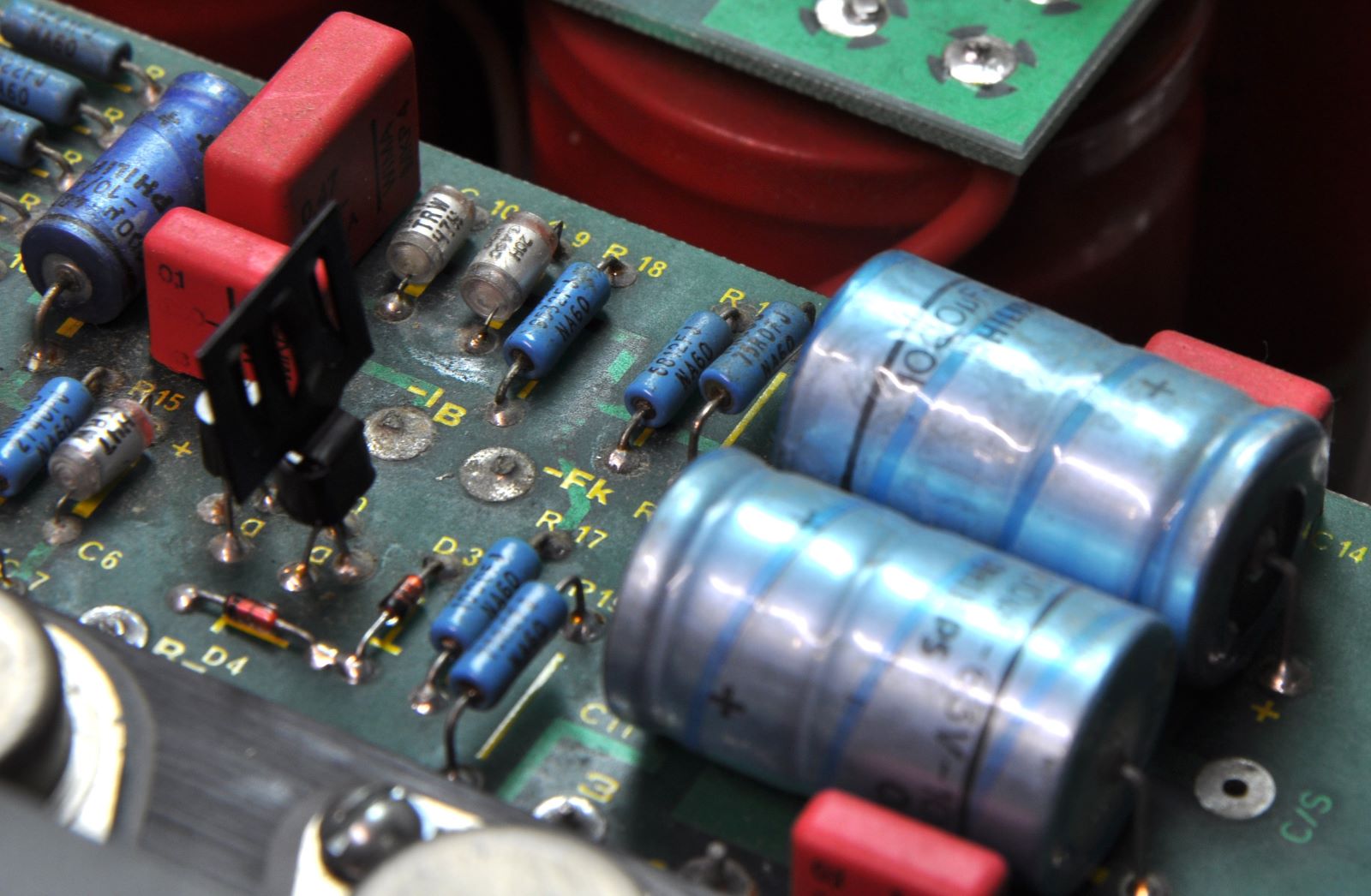

This board isn't pretty, but is it cause for concern?
I've tried isopropyl alcohol & a toothbrush but it has very little effect.
Any experience/suggestions would be greatly appreciated.

Stronger solvents could remove the printing on the PCB.
I use a glass fiber brsh, alternate is a brass wire brush.
Assorted tooth brush handle type sets, with steel, brass and carcon fiber etc. bristles are sold for such purposes, buy good ones, use board after careful inspection.
Try hot soapy water, rinse thoroughly later...just a last chance suggestion.
My go-to chemical for most cleaning that alcohol won't do is hydrogen peroxide and in either case a fine mist pump sprayer and rarely need scrubbing except with a long hair brush for such things as tube amps and a typical cheap shoe shine brush and/or old paint brushes trimmed to different lengths for everything else.
I spray/wash corroded terminals and PCB pads with Cramolin D5 red, let sit 1 minute, scrub with fiberglass (Radio Shack used to carry them but I think you need to search for these; my brush wore out) or nylon brush, and remove with 95% or higher isopropyl alcohol. What I see on your photo is corrosion, not flux. Isopropyl alcohol by itself is not a solvent for corrosion. Cramolin D5 should safely dissolve corrosion, and isopropyl alcohol will wash it away. Two washes would be desirable. Water is NOT wanted, so I do not recommend 90% or lower isopropyl.
And make sure to resolder all solder joints after that and remove flux.

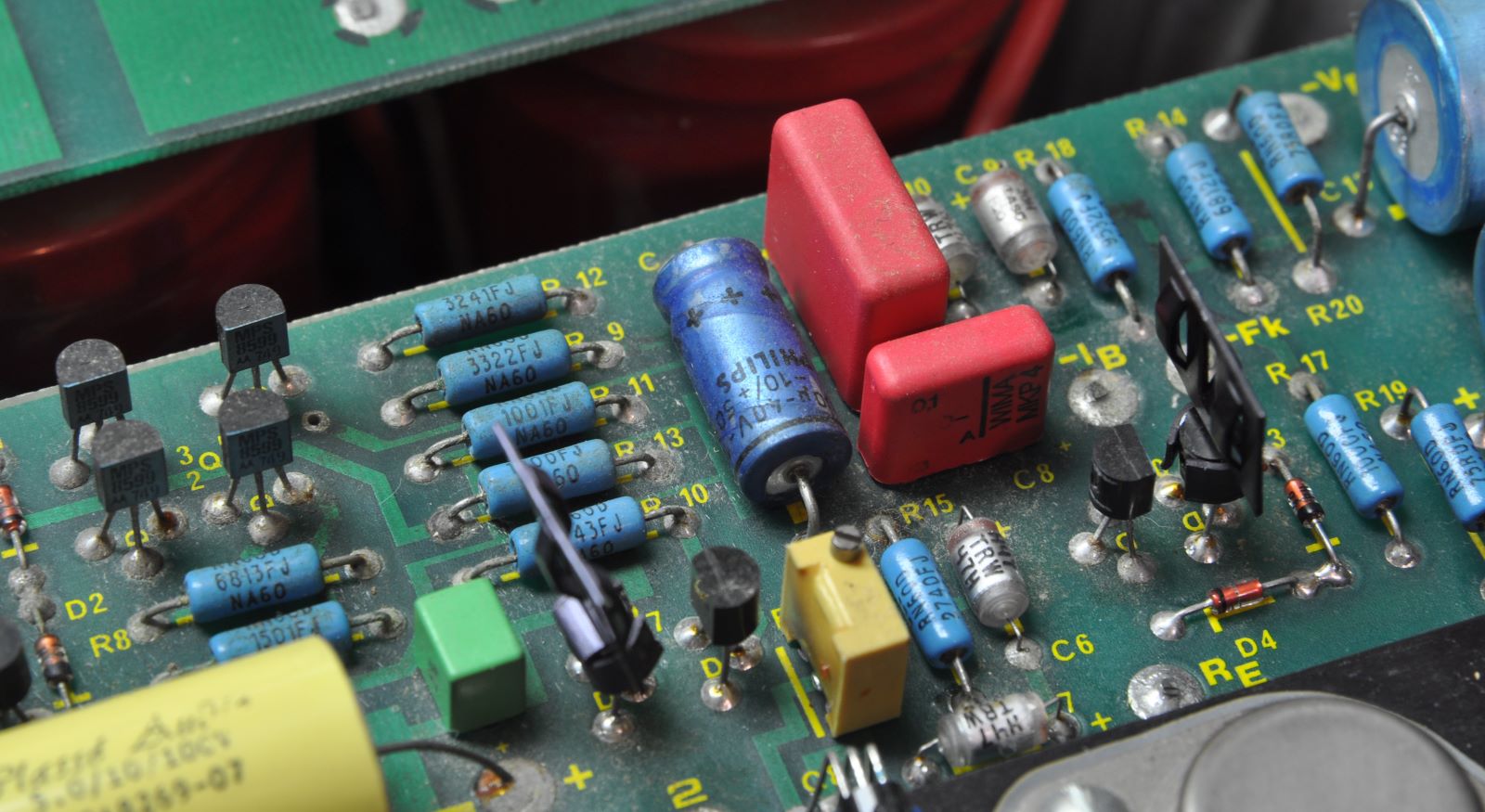

That old axial Philips caps with transparent blue sleeves are notorious. When we measured these at technical education the teacher used to say that these had ranja as dieelectric (ranja is syrup). If it is in the feedback network a bipolar MUSE ES one is a better choice.

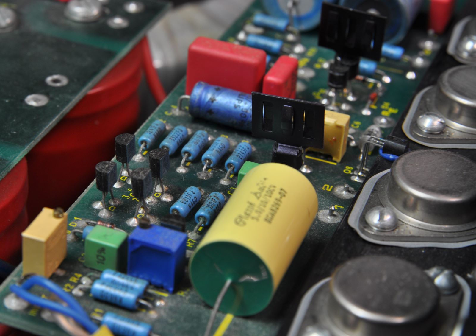

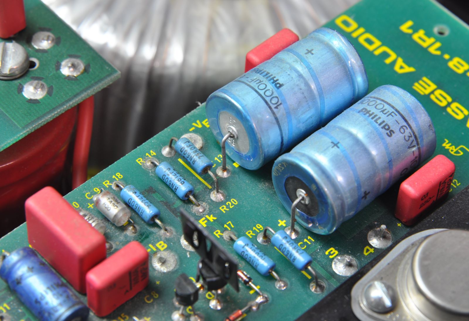

Here are some more photos.
Besides the oxidation, there is a layer of funk. I don't know if it's cigarettes (there' no smell) or just years of dust and moisture.
They're not pretty, but is this a serious concern?
I tried with IPA & a rag next to R18. You can see where I started to get down to the board a little.
These is from a Classe DR8
I have 2 that I run in mono for a pair of Magnepan MG3a's .
They're not valuable but they're great amps.

Cotton wool bud. Try a chosen cleaner on a small part of the board it'll be clear from the state of the bud if it's removing gunk/corrosion or not. Then you can do the whole board.
Use something low abrasive really. An old white t-shirt. Cotton swabs. Pieces of old white t-shirt wrapped around cotton swabs. A new soft toothbrush also works OK but try to avoid touching the parts themselves too much. Point is to remove the layer of filth/mold so it can not become a conductive path. Wear a mask to prevent inhaling debris! A soft paint brush and a vacuumcleaner should be used too. Wipe all dust/dirt/hairs etc. just like normal house keeping practice. Clean, clean and clean everything. Beware of touching adjustable stuff like potentiometers. Replace all those very old Philips axial caps and the main bulk filter caps while you are at it. It needs complete resoldering after cleaning anyway.
Maintenance = 1. cleaning 2.checking + replacing aging parts 3. resoldering all joints
