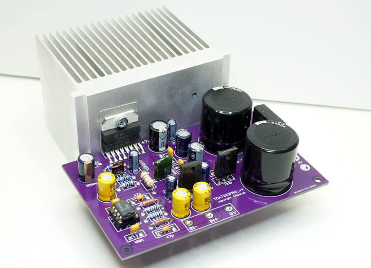

I have a Marshall 100 watt chip amp guitar amplifier that uses a CPU heat sink and fan.
I bought it as faulty as fan was very noisy (bearings gone.)
It was an easy fix.
It was an easy fix.
I see no reason a CPU cooler and a quiet fan wouldn't work for audio. There are some fan options out there that only produce single digit dB(A) SPL when they're running. Just don't drill into the heat pipes...

You should add a 75-85C thermal switch to heatsink.
Protects both from (VERY unusual) fan failure and far too easy vents blocking (some idiot dropping his jacket on top of amp or similar) or lint buidup.

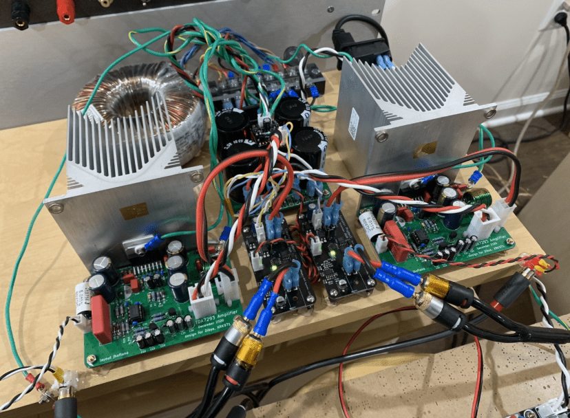

I have no issues with a TDA7293 mounted on a cpu heatsink.
Hardly any heat for background music.
If one is driving the amp hard, use a fan with a thermal switch on the heatsink as JM suggested.
