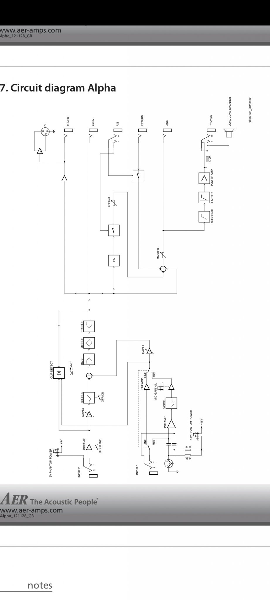

Can you share at least a block diagram?
Most brands do that, and evem print them in their user manuals, way too general to disclose any secret, but would help us suggest more specific tests.
