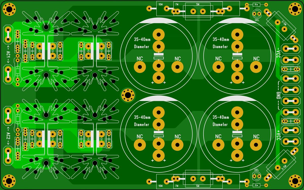

Hello everyone.
Following the realization of several people of a class A amplifier (USSA-5 of Fab), I decided to draw a PCB dedicated especially to this one but that can be suitable for any other amplifier.
I wanted to do something fairly universal and practical and I told myself that this PCB might interest more people.
Features:
Size: 160mm x 100mm.
Possibility to put four capacitors up to diameter 40mm.
Possibility to put diodes (to220) soft or high recovery (capacitors provided).
Capacitors in parallel on the inputs of the diode bridges.
Possibility of putting an 'RC snubber' on the inputs of the diode bridges.
Possible resistances between capacitors from 5W to 10W.
'Bleeder' resistors from 3W to 5W
The latest version brings the possibility to put 5-legged capacitors and TO247 box diodes.
Update: Schematic:
Silkscreen:
