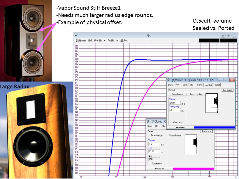

-You will need to find the time delay between the RAAL and 18H52.
-Time Step: A curve-stepped baffle around the midrange, with a large edge radius, might sound best for this ribbon + simple Xover circuit.
-A slot port needs round-over cuts on all inside and outside edges.

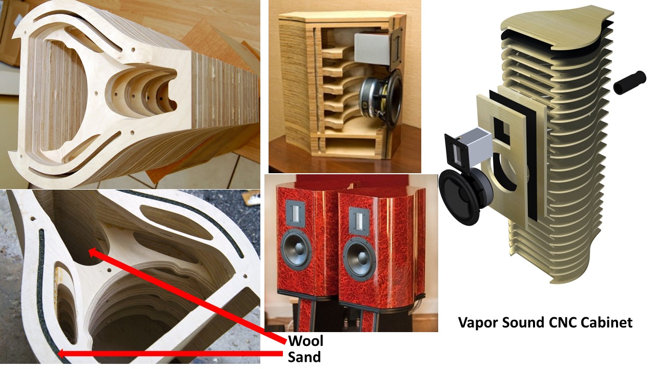

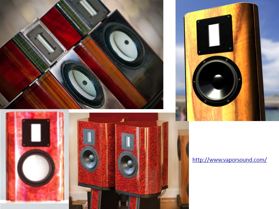

-I found that ribbon tweeters like the RAAL sound best in cabinets with LARGE RADIUS edges.
-Study the Vapor Sound RAAL designs.
-Vapor's translam construction is very expensive, but offers impressive customization.
The VaporSound Sundog Black is one example of simplier construction.

So, you want to construct a RAAL + 18H52 cabinet which can easily convert between ported or sealed.
----no front slot port
----rear round port which can easily get plugged
Build a cabinet with ~0.6cuft empty.
-PORTED: 0.5cuft port tuned to 51Hz, -F3= 53Hz => 2" diamater port, 5" long, round both ends, 1350Hz port resonance
-SEALED: 0.5cuft FSC=74Hz, Qtc= 0.57, -F3=94Hz
I would.....
Use physical time alignment between the RAAL and 18H52.
Use 2" to 3" edge rounds or bevels to reduce diffraction.
Use LR4/LR4 crossovers at 2300Hz.

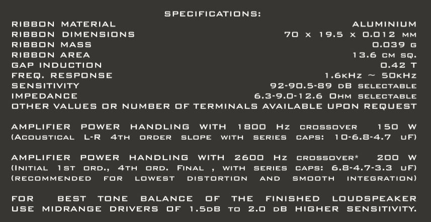

From the RAAL 70-20XR datasheet, it looks like a LR4 acoustic slope crossover at 2,600Hz is produced when the 89db sensitivity terminal is selected, and the 12.6 ohm terminal is selected, and a 3.3uF series capacitor is used. If this is correct, then 2,600Hz LR4 would be a good first build with the C-Quenze 18H52 17 06 SD to study cone beaming and cone breakup.
How difficult is it to create alternative frequency LR4 acoustic slope crossovers?
