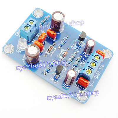

Here it is: A Regulated Virtual Ground Circuit
All of them may be LM317 and LM377 which eliminates the need for matching.
Not to different from this one.
Both takes in consideration that there is some current needing to flow via the ground, wich the simpler variants is relatively limited to cope with.
Ah You know what I mean.
But theese two makes it possible to get some out of it anyhow.

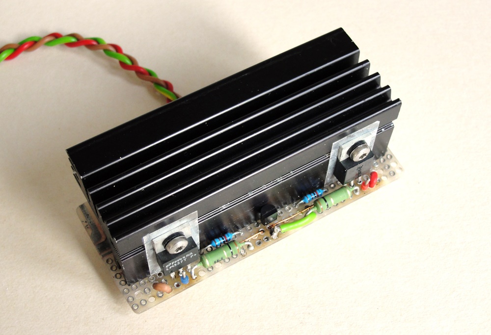

A friend needed one to split his lab supply to dual for testing his F5.
It needs to be low impedance and capable of 1A or so.
I used to have something like that in post #12, but with TO3 Darlingtons and high bias.
But 1A bias is a bit much.
Those in post #8 are mostly for tiny current, and either have high impedance or stability issues.
So I looked at the 317_337 circuit in post #11.
It works, but a few changes were necessary for me :
I removed C2, C3 so that they wouldn't kill my voltage reference during start up and pass HF noise from the rails to the latter.
I used TLVH431 and a 10k trimmer instead of LM336, in case the Vref's of 317_337 are lower than 1.25V (datasheet says as low as 1.2V).
And of course a cap is necessary for the stability of the 431.
The 431 was trimmed so that V1-V2 ~ +30mV, so as to make sure the regulators have their required minimum working current.
R1 or R2 can be trimmed to centre the split, if necessary.
One can always use LT1083/1033 to get even more current.
Patrick

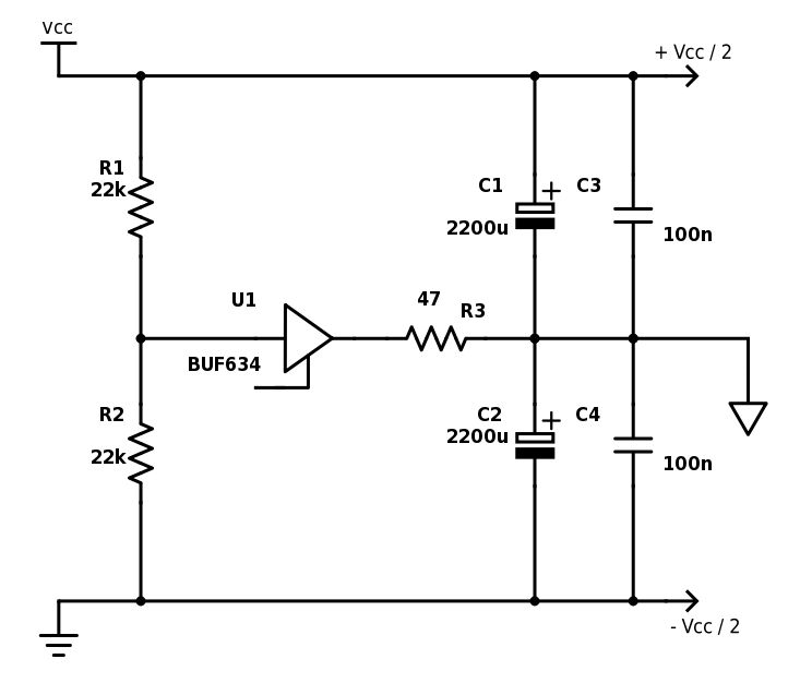

Resurrecting old thread as my search hit this one.
This is what I used a few times.
Basically a resistor based split with capacitors added would be just fine, if it wasn't for the DC imbalance due to the current sink to virtual ground by the circuitry that follows.
Can't drop resistor R1/R2 values as current drainage of the battery powered devices would suffer.
Essentially the BUF634 (any opamp in buffer mode would work - modulo being careful of DC current sink ability) is there only to provide DC ground.
The R3 value is such that DC imbalance is minimal given the DC current routed to virtual ground.
At audio signal level, basically anything to VG goes via C1||C2||C3||C4.
