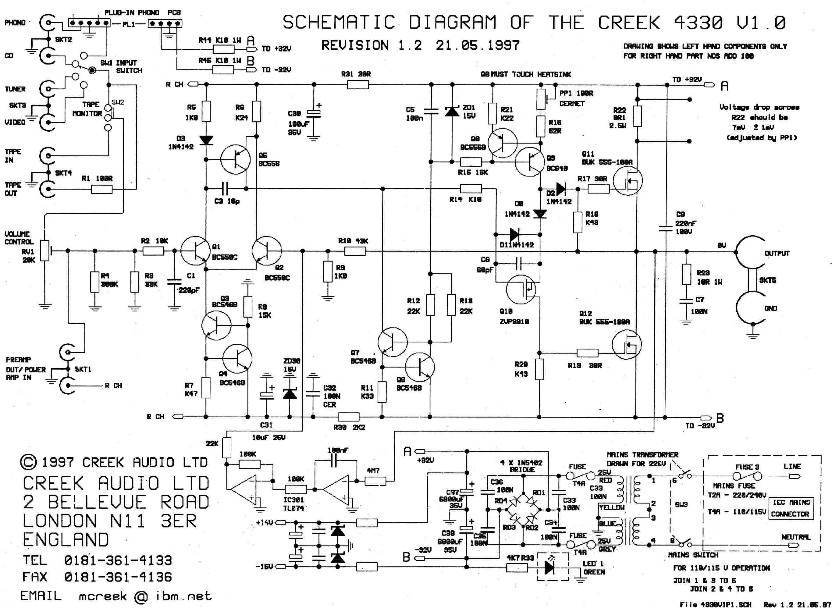

I have only had the creek for about a month. I imported it from the Uk and the box had some damage to it although the amplifier itself was unmarked. So I was concerned that although the amplifier sounded ok it was generating no heat.
I have included a couple of schematics of older creeks that show about 6 mv across the .22 ohm 5 watt resistors.
Is it possible that my amp being bipolar output compared to the earlier mosfet outputs would require less biasing? or is this a non issue.
The reason I mention this is that I have just received an email from Mike Creek and he said there should only be around 1.5mv across each .22 ohm resistor!
His reply was
"To reduce crossover distortion to a reasonable level, the voltage drop across each 0.22Ohm resistor should be approximately 1.5mV, or 3mV across both. Using more bias than that will cause the heatsink temperature to be too high. The second pre-set is for small DC adjustments."
I see. It's worth saying that mosfet and bipolar devices usually have quite different bias requirements depending on the type of device, the actual chip technology and the configuration of the output stage. A typical class AB CFP design bipolar amp. could have a low bias of perhaps only 10-20mA but a mosfet design could require 100-200 mA per pair of output devices before the crossover distortion disappeared completely and the sound became sweet and clean.
You can't predict the electrical design and bias requirements by the brand name, as the title "Evo" might suggest. Creek started with bipolar and have changed technologies with each designer's influence. As this is a bipolar design and you find the sound acceptable with 36 mA, it could be a fortuitous outcome, provided this current level remained stable when the amplifier was then played at solid volume levels with the cover in position and everything became quite warm yet bias measured as fairly stable. It's probably a safe bet but test again after a listening session - bias stability is critical to the longevity of your amp. You certainly don't want thermal runaway and a smoking amp showing you why you need to be careful with bias.
However, the design setting according to your attached setting procedure is a very low 1.5mV across 0.22R - only a tiny 7 mA and whilst that will kill most crossover distortion from a CFP output stage, it's going to sound a tad sharp for my liking and perhaps fussy with speakers regarding the remaining distortion artefacts.
36 mA is obviously a lot higher than 7 mA and explains why you thought the bias was zero and needed adjustment because it felt cold - unlike the majority of amplifiers which use emitter follower designs amplifiers with 50-100 mA bias current. I would back your setting off to 15 mA or a measurement of 6 mV across both 0.22R resistors and see what you think about the sound quality and the stability of the setting. It will still run quite cool and steady now as most CFP designs do but that may be a different story in summer with 30-40C ambient temperatures. Keep a close eye on stability as summer approaches if you are going to use a higher bias setting than specified by the manufacturer. It's not an arbitrary control to adjust at will so take care and test periodically.
