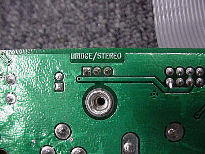

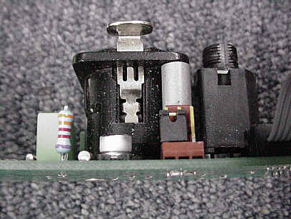

those caps look perfect. the input board is mounted vertically behind the rear panel. there should be a jumper on the top edge of the board. the labeling is backwards. when you think its bridged, its stereo and vs vs.
attached is the jumper in bridges pos

back of the board showing the printing. some models are backwards.
