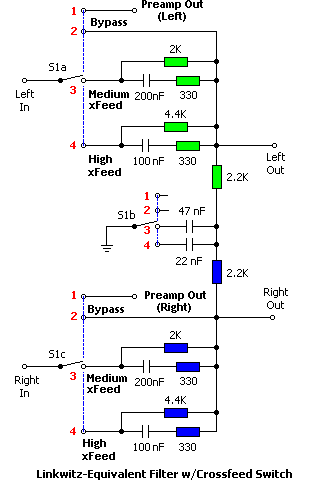

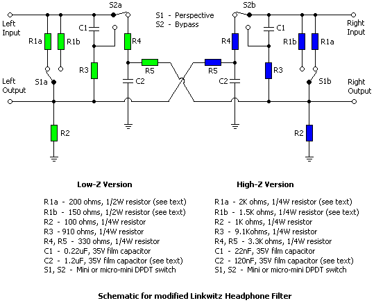

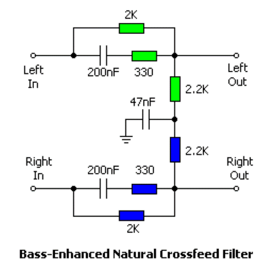

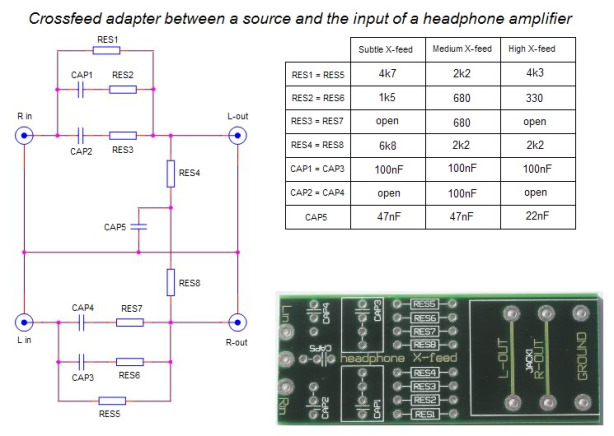

Crossfeed solution
Reactions: jasonRF

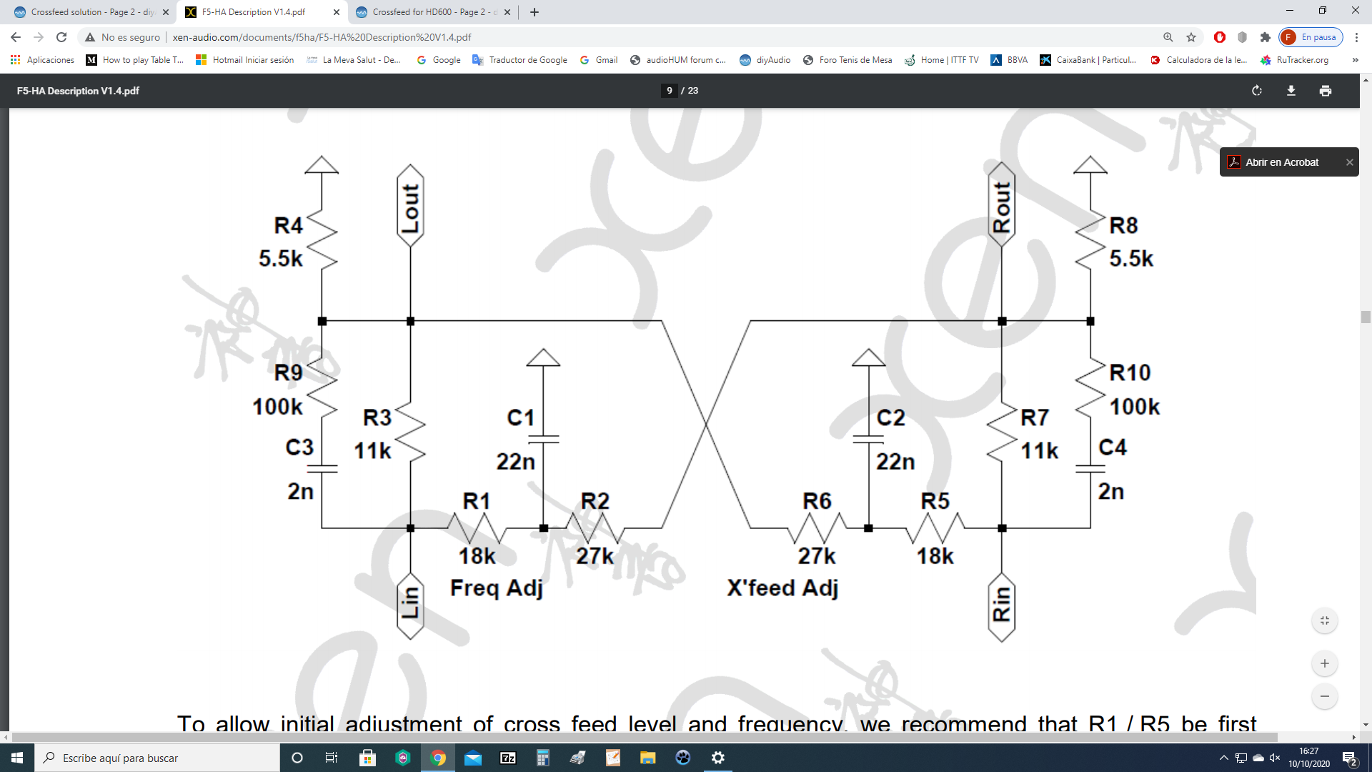

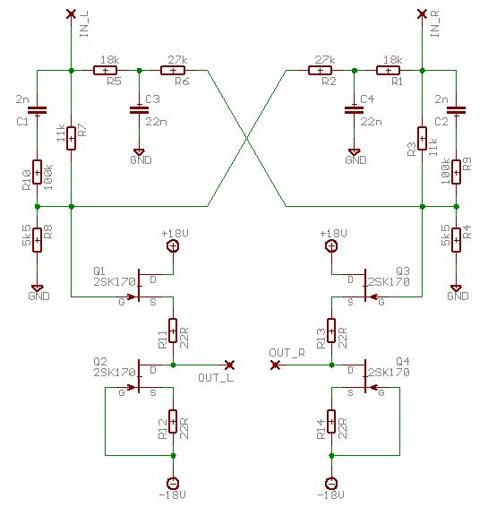

Of the 6 versions that I linked to in post #7, we finally settled on the passive Danyuk.
More than 10 people have tried this and none of them has gone back to no cross feed afterwards.
https://www.diyaudio.com/forums/pass-labs/271926-f5-headamp-11.html#post4759695
https://www.diyaudio.com/forums/pass-labs/271926-f5-headamp-10.html#post4671587
Dimitri also went for our passive version in his own HPA design :
http://www.linearsystems.com/lsdata/others/Headphone_Amplifier_Evaluation_Board.pdf
(See Ref. 4 & 5)
Patrick

A crossfeed after the amp depends entirely on the impedance characteristics of your headphone.
So you will need a customised one for each specific phone.
There is no universal solution.
The circuit in post #13 you can build as an add-on before your headphone amp.
The only requirement is a high input impedance (e.g. 100k).
If you (like me) have a 10k pot at the input of the amp, then just replace R4, R8 by 12k.
Works perfectly.
The crossfeed will attenuate the input by 10dB.
So you need to turn the volume up.
And you can remove it anytime with no consequences.
