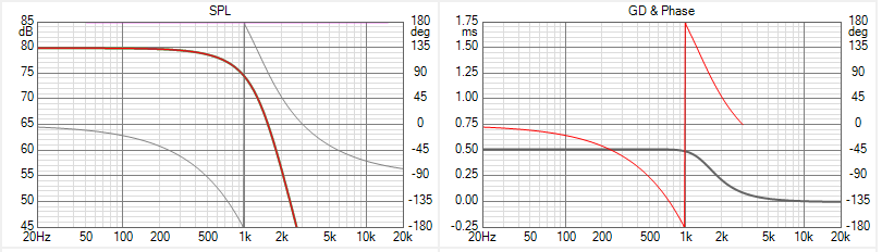

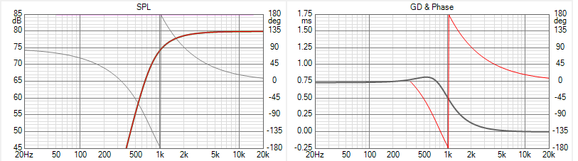

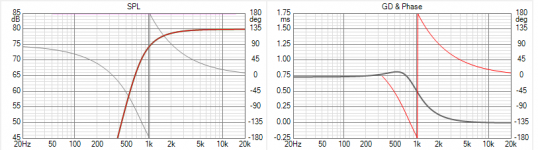

I will start with an example.
Since we have a time delay an obvious candidate for the Low Pass would be a Bessel filter.
First is a Bessel LP, it has maximally flat Delay.
Second is a HP "Bessel" created by the usual method, the frequency response is mirrored.
But a Bessel is not about frequency response so this does not create a HP with maximally flat delay, as is obvious in the plot.
A closer match would be a HP filter with maximally flat delay.
Anyone know what this is called or have a reference so I don't have to create it from scratch?

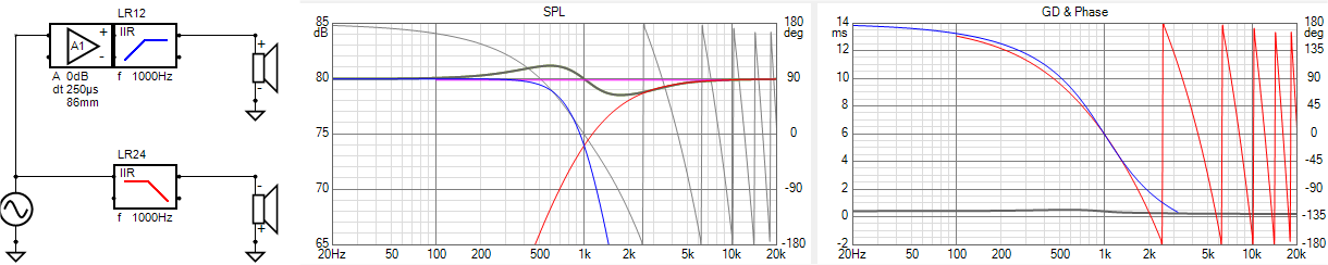

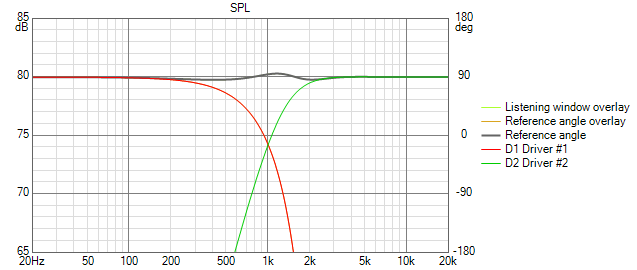

I went digging for plots, then I thought I'd just do something fresh. This is based on flat drivers, crossed at 1kHz. One has a second order filter.
The other is delayed by -250uS (I did this rather than the other at +250uS, so the plots would be easier to read). This delay amounts to 90 degrees, or two extra orders at 1kHz. It has a 4th order filter. It is also inverted as per usual.

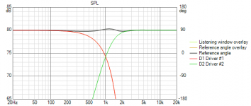

As explained in my response to Marco, I think this is the way to study the problem.
Once we understand the idealised case we can include real world effects.
The other is delayed by -250uS...
I see no delay for physical offset in your post, have we failed to understand each other?

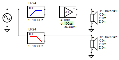

Here is an example, it is a Link/Riley with some delay on the tweeter that corresponds to a physical offset.
Best wishes
David

The delay was introduced in the form of Z axis offset on the previous tab.
I don't see any Z axis offset in the picture you uploaded, see attached.
But I am not very familiar with VituixCAD perhaps it has been done in some way that I have not come across.
My first impression is that it is desirable that a method to introduce a delay should make that delay visible on the circuit, I would prefer not to have to deduce what has been done on a previous tab.*
Perhaps it will become clearer to me after I am more familiar with VituixCAD, certainly an impressive piece of work.
Care to elaborate on how the simulation or my real world example could be improved to meet your needs?

diyAudio Moderator
Joined 2008
Ok, this is identical. Don't be put off by the phase wrapping, I simply delayed the tweeter instead of advancing the woofer.
This is the most standard beginning as I see it. Both LR. One driver is inverted (I'll try to use a method in the future that makes that fact obvious).
The delay, when looked at over a small band, appears like a filter with regards to phase change, but obviously without the response change.
Where would you like to go from here?

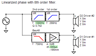

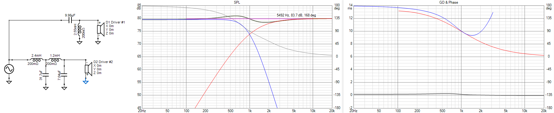

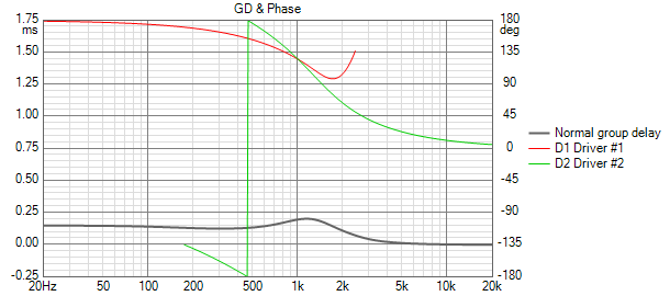

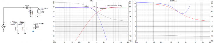

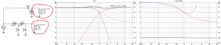

I plan to study it more before I write much, but here's the preview of a first trial.
1. The amplitude response is flat to within a few 0.1 dB.
This is almost certainly because I don't have the filter quite perfect yet, in any case it's far below audibility and production tolerances.
Note the scale is maximum expansion to reveal detail, it would look even better on the scale used earlier in the thread.
2. The phase match at crossover is perfect and stays close over the transition band so polar response is optimal.
3. The low pass is 8th order yet the delay is small and barely peaked.
A substantial amount of delay has been cancelled.
Note this scale is also maximum expansion and here too would look better on the scale used earlier in the thread.
4. The hi pass is 3rd order, probably the practical minimum when both acoustic and electrical roll-off combine.
5. The offset is more than half a period, which makes a deeper mid horn acceptable.
The time baseline is the mid, the woofer is moved forward in space and effectively in time, this is the "time travel"!
David,
This is not a linear phase filter, it is still minimum phase. It is a time aligned minimum phase filter. Better to keep the meaning of words intact.
It is therefore not 'linearizing phase' but 'aligning phase' what you are doing here. That can be done with a delay of any kind, physical or electronic. For linearization, memory is required.
...it is still minimum phase.
The crossover is not minimum phase, it has excess phase and is essentially an all-pass filter.
The point is that it has half the excess phase of a similar filter without offset.
So the phase has been made more linear, it has been "linearized" - but not completely.
Call it partial linearization if you want to quibble about words.
In fact I doubt this will make an audible difference, even the uncorrected delay is probably below detectable levels on real music.
My primary interest was to allow for the depth of the horn - without the extra step of a DSP - and this has been achieved.
But the linearization is a neat trick and a nice puzzle to see if the mathematics works to allow completely linear phase.
