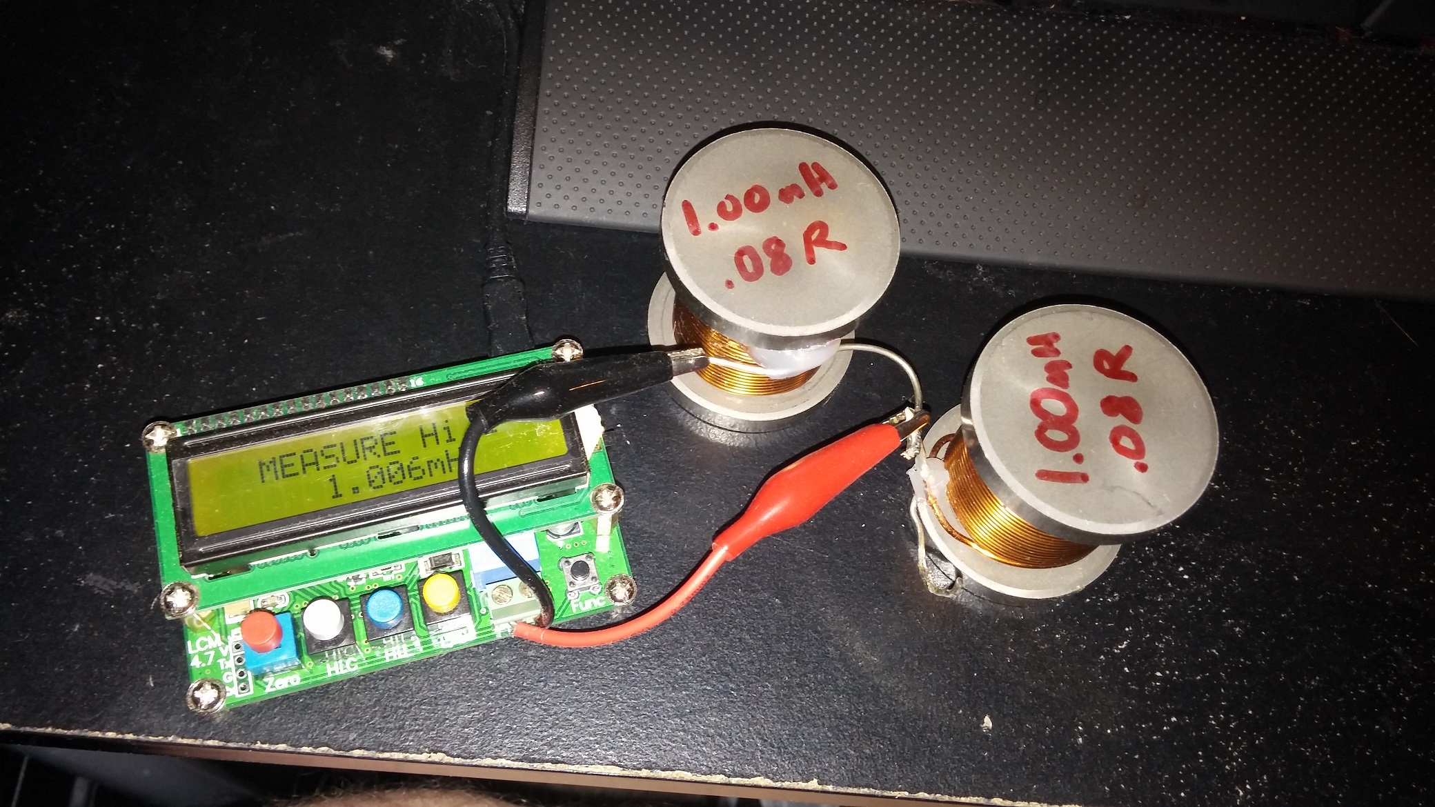

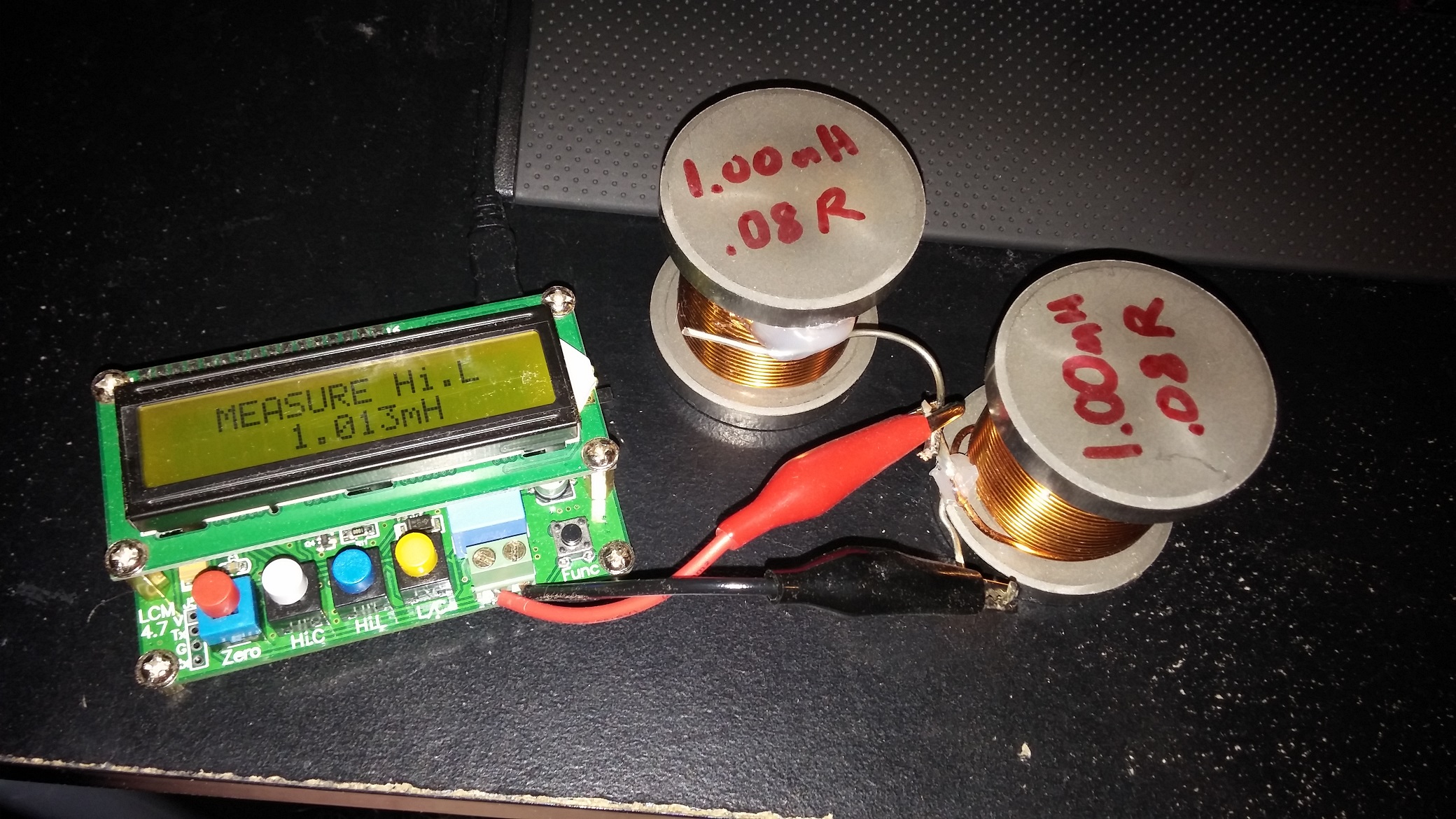

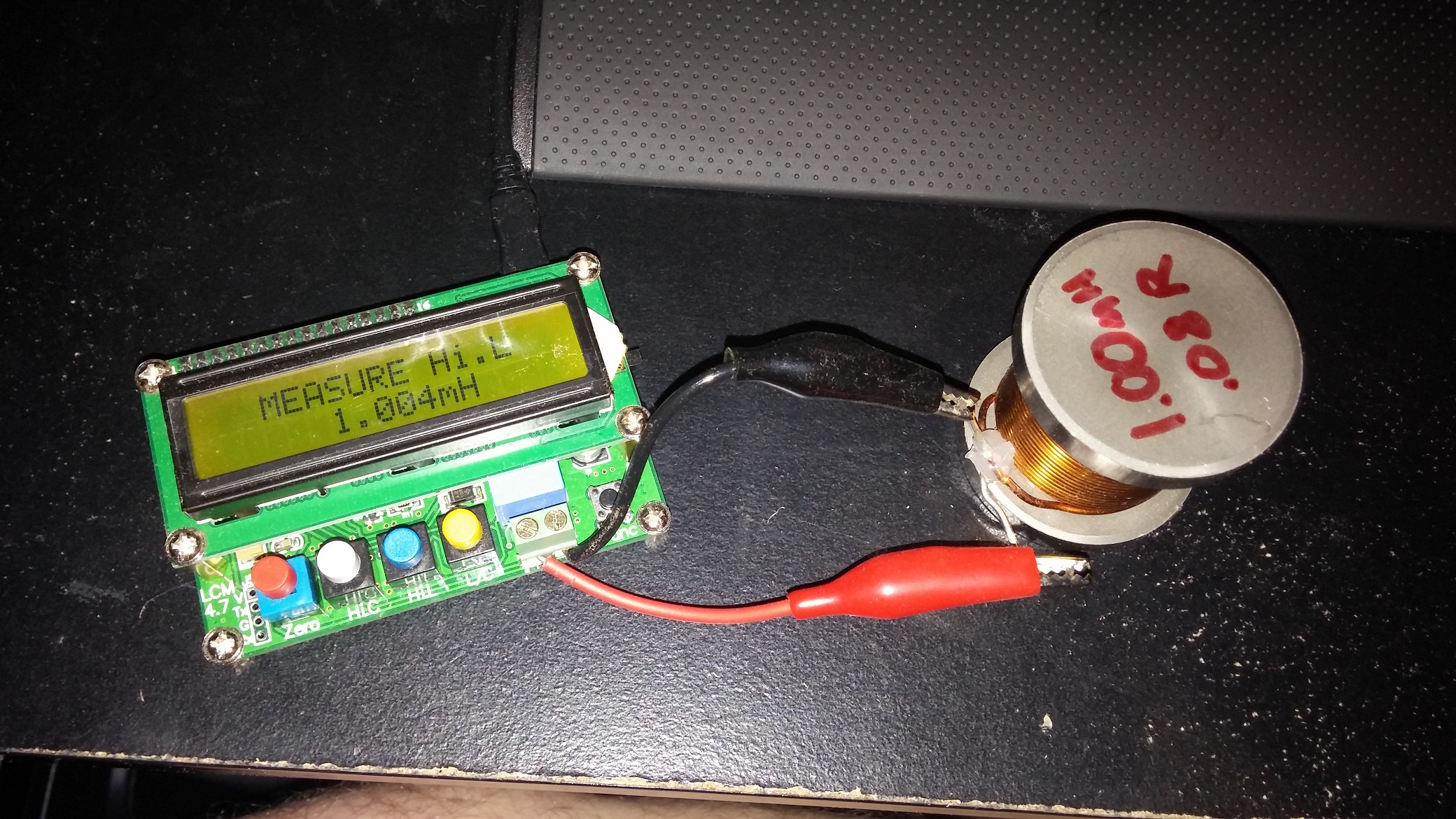

As you can see in the two photos that each inductor measures about 1.00mH.

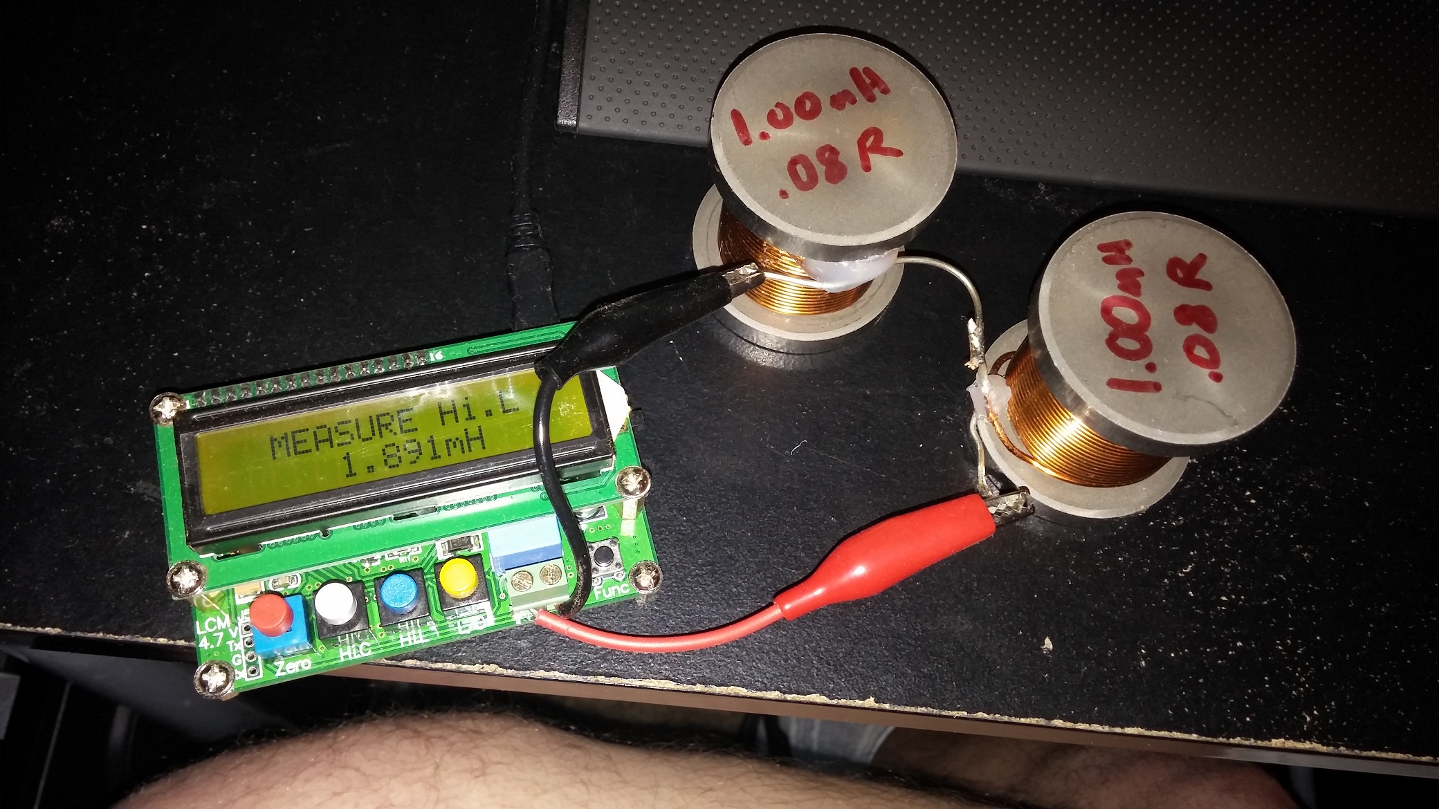

In series they measure 1.891mH.
Then the individual center tapped sections measure a little higher than the initial measurements.
This is because there is coupling between the two inductors.
With air core inductors rotated 90 degrees from each other you would probably have pretty good luck doing what you are describing.
Otherwise you will need some separation between the two inductors to eliminate cross-coupling.

The mutual inductance is key as the unit is being used as an autoformer (single sided transformer) for step up or step down. I'd agree with Kevin about dewinding an inductor to add a center tap. That is the only way to get to what they had. 2 seperate inductors would not work.
