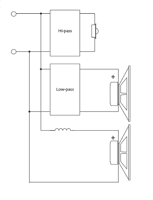

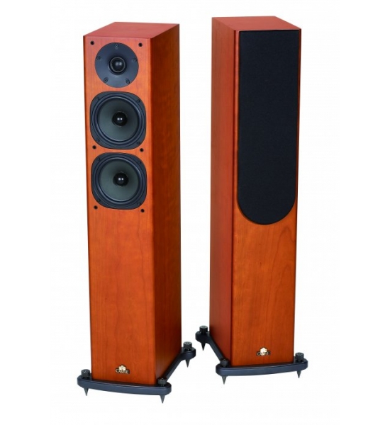

Hi, I wonder if anyone knows the crossover design used in the Castle Knight 5 or Avon 5 speakers? These quarter wave designs both have two identical drivers, one of which is bass, the other is configured as a bass/mid. The idea is apparently to excite the line at different points in order to smooth out the bass response. I have a pair of the Knight 5 speakers which are excellent (and highly under-rated), but I wish to construct a larger speaker using the same principles to extend the bass response. I have drivers, but the key will be to understand and construct appropriate crossover networks. I'm a little reluctant to remove and un-solder the Knight 5 crossovers in order to measure the component values (which I could do - but!) so I was wondering if anyone on here has the circuit diagrams and would be prepared to share them? As always, many thanks for any information!
You need to at least know what the XO in your current boxes are.
These look to be quite different, the first a 2.5 way, the second a 3-way with an MTM up top.
The XOs will be quite different. The 2.5 way will have the top midBass XOed to the tweeter and the lower midBass just an inductor to roll the woofer off lower (usually somewhere just under BS9-3).
Do note that Castle around here usually implies 1 driver (midBass) firing forward and one firing upward, a tribute tto the Castle Howard.

Castle Knight 5
Castle Avon 5

Locate your baffle step, take down the bottom woofer with an inductor, then treat it as a simple two way up at the crossover.
My comments align with Allen’s. This is what a 2.5 way XO looks like.
First approximation of BS(-3) =4560/(baffle widtht [inches]). Generally one looks to XO at 0.707x<BS(-3)=1x. I tend toward the lower. You will often see commercial offerings with the second woofer XOed earlier, ie 100Hx-ish.

Nope, the coil from the upper woofer to lower woofer is connected after the lowpass xover. This allows the second woofer to be lumped in with impedance and resonance control of the upper woofer.

I have as well, but the benefit is less copper in that extra coil, piggybacking the one in the lowpass. It's pretty much wasteful to not do it after the lowpass.
To be honest I'd rather define it as a curve, and such a curve would be speaker specific. However the inductor method rarely disappoints, and makes a good starting point in any case. It's interesting that the baffle frequency and crossover frequency are typically (eg the speaker in question) related to the same woofer dimension so many 2.5 ways are not especially different.
